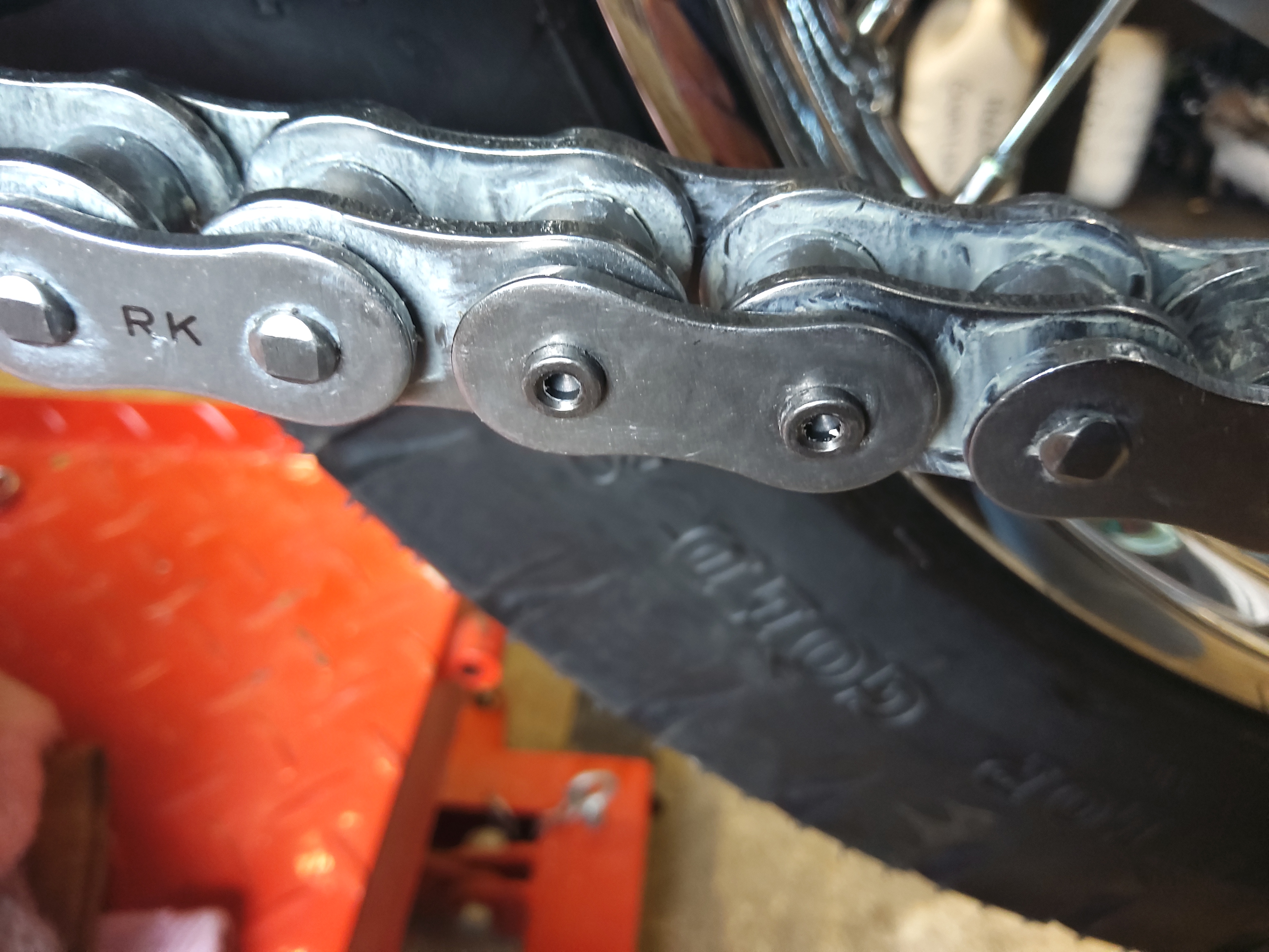

Warren...great tip re the mole grips! After 3 or 4 goes I managed to lock the plate and then using the rivet tool eventually got to this state (pic). Almost broke my wrists doing it and had to use a 1/2" socket and socket extension bar to apply enough pressure. I really am getting too old for this sort of muscular effort :gom

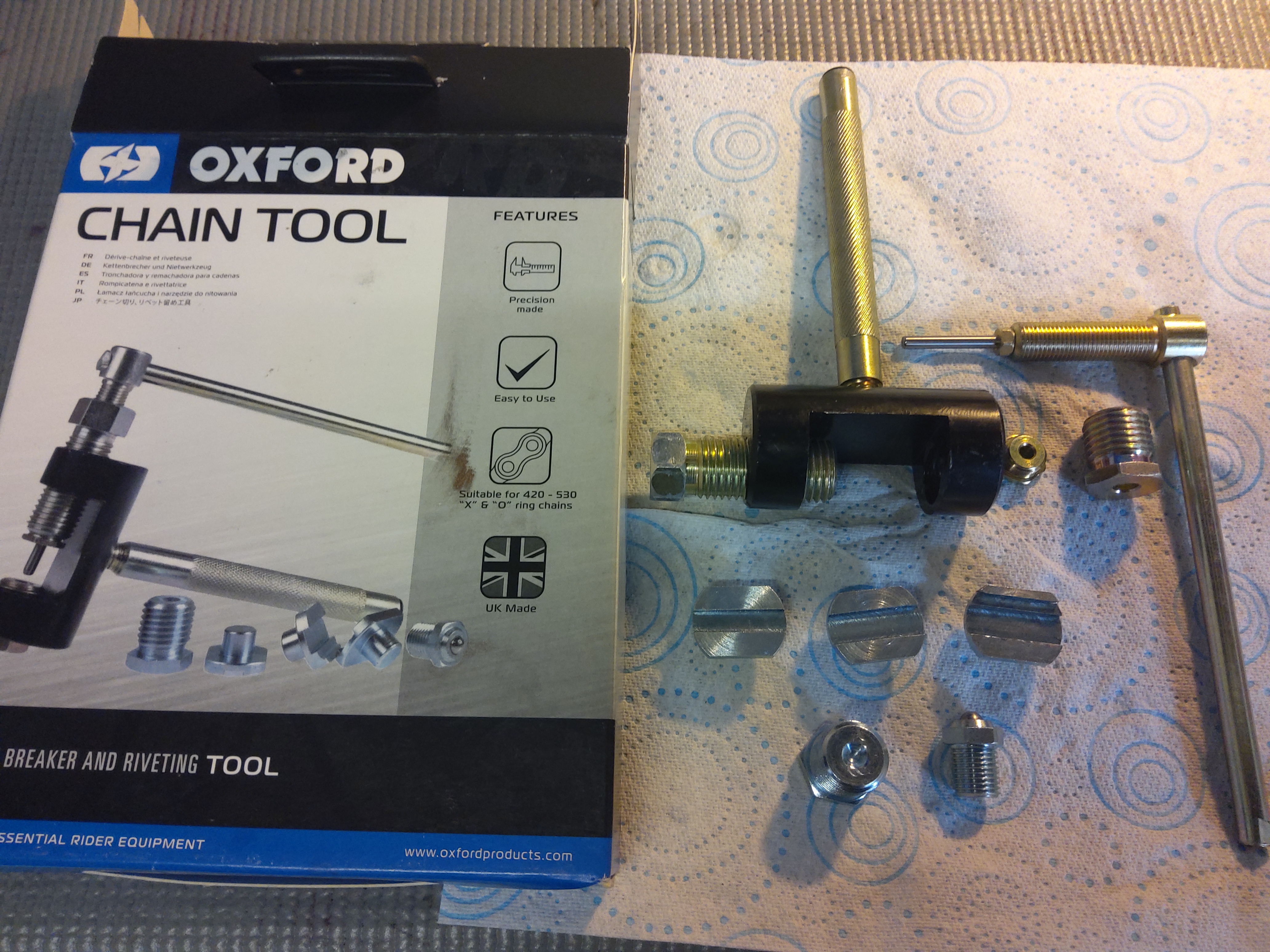

Just out of interest this is the Oxford OX777 chain tool I'm using.

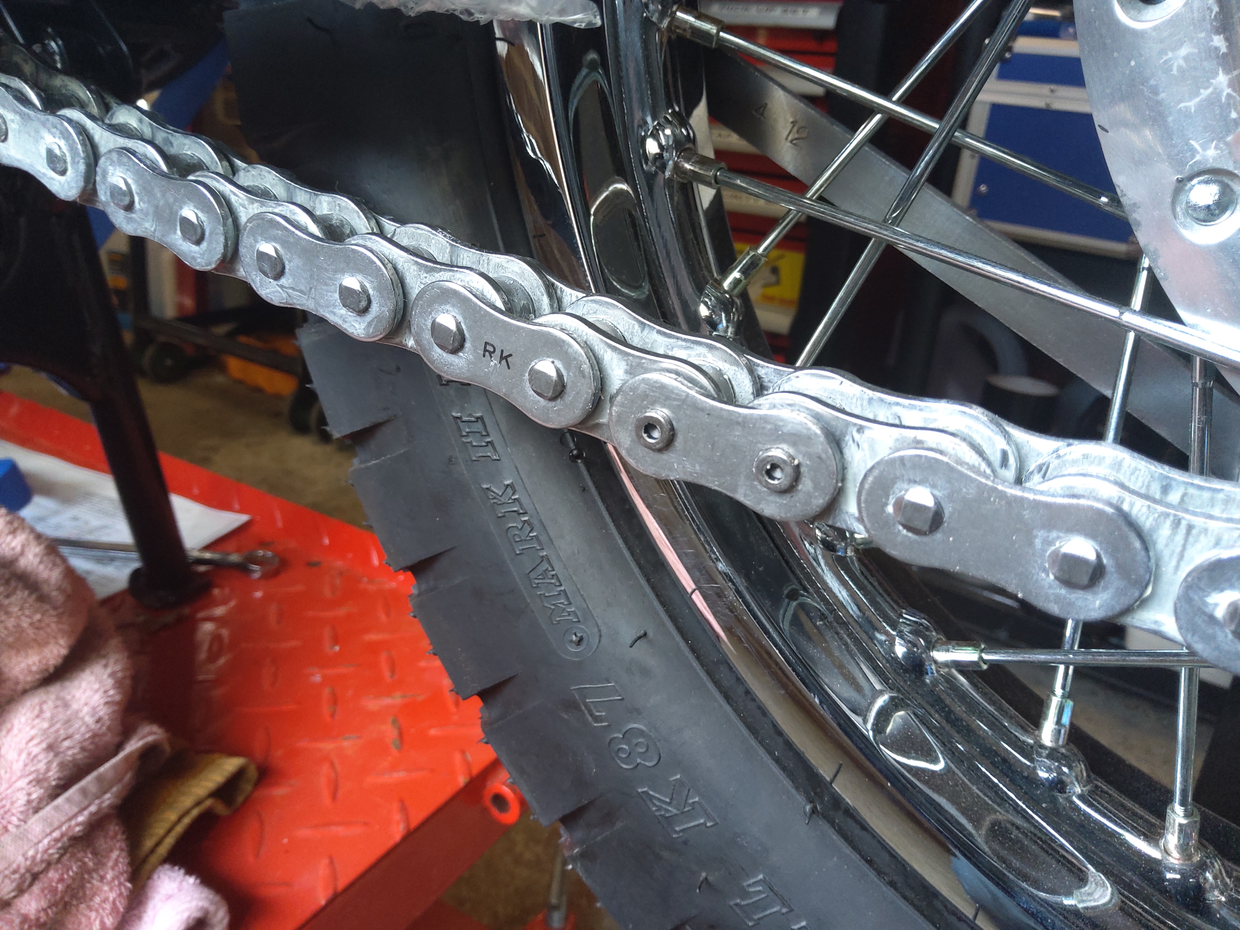

Well! My first attempt at flaring the ends. The pin heads are actually greater diameter than they started but I think they've been made from some exotic alien alloy because this is the best I could do, practically standing on the socket bar and almost breaking my wrist ligaments to get to this stage. The peening ball in the tool is not deformed so I guess the ends are about as flared as they're going to be. I'll soon find out when the chain is under load.
Z1-B, 360bhp ZX1000NGF
Posts: 3110
Re: Rivet link chain issue
#13 PostAuthor: warren3200gt » Sat Oct 10, 2020 2:51 pm
Yeah, they dont look flared enough to me. Looking at your picture it appears you only have one size of flaring tool. The one I have has 3. I start with the smallest and get progresively larger until the desired flare is achieved.
