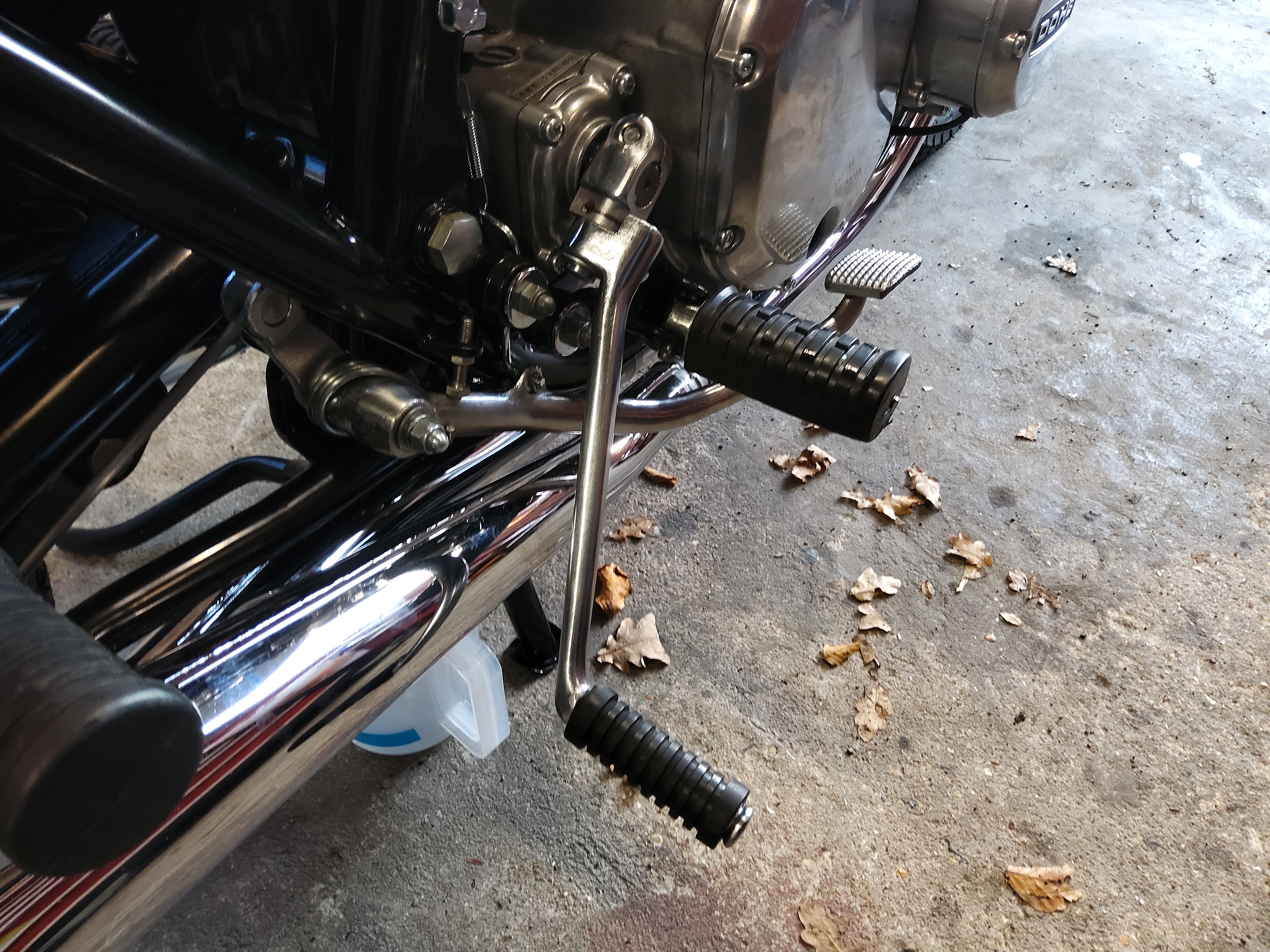

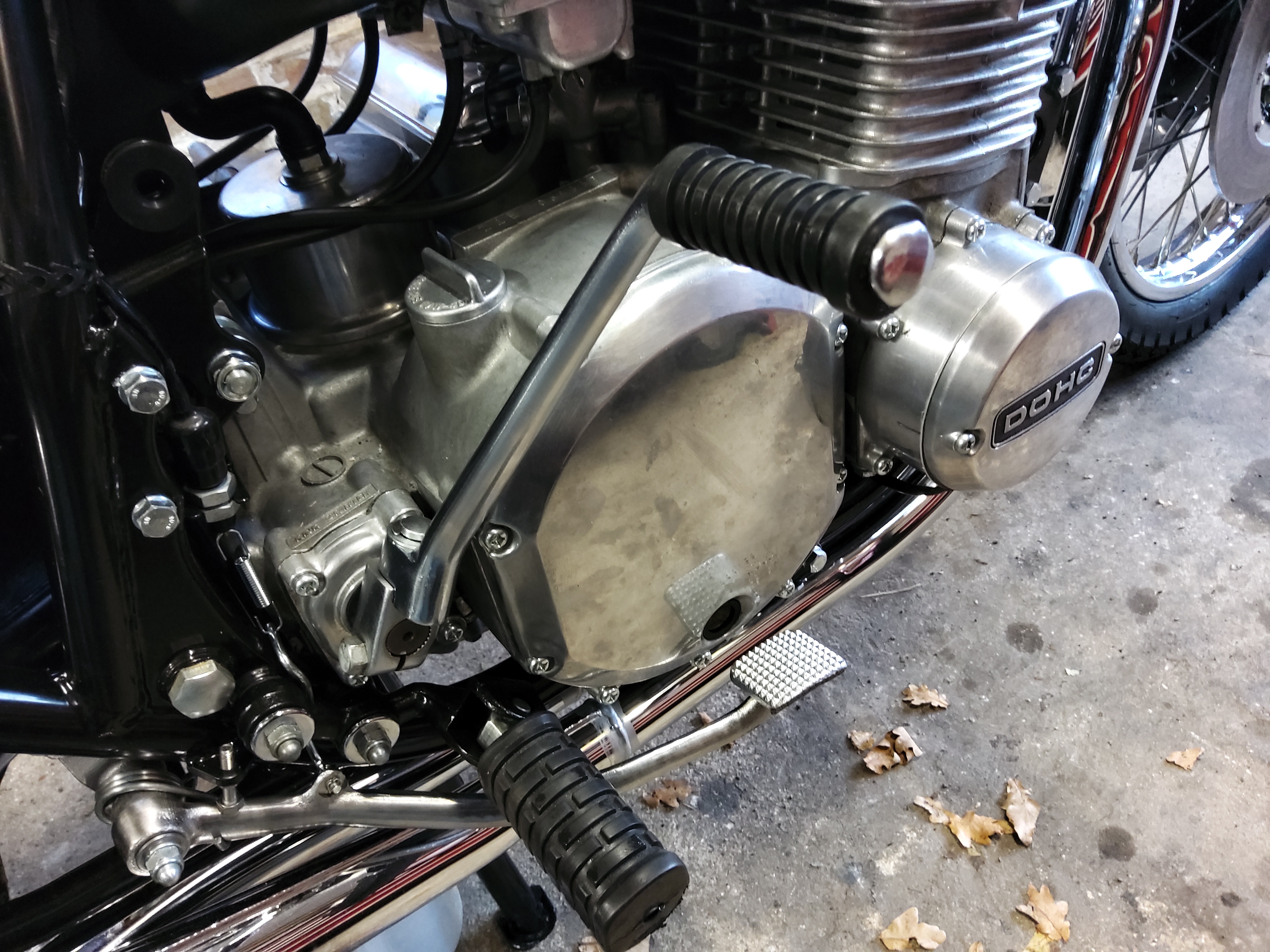

After many shenanigans rebuilding my Z1-B I finally tried to start the bike today but although it appeared to make the correct initial noises eg starter motor turning etc the kick start lever shot backwards! I managed to return it by hand with some effort upon which it made the expected clicking noise as normal. However, it's now returned in a further than normal position. Am I looking at another engine rebuild or is there a less traumatic solution. HELP !!!

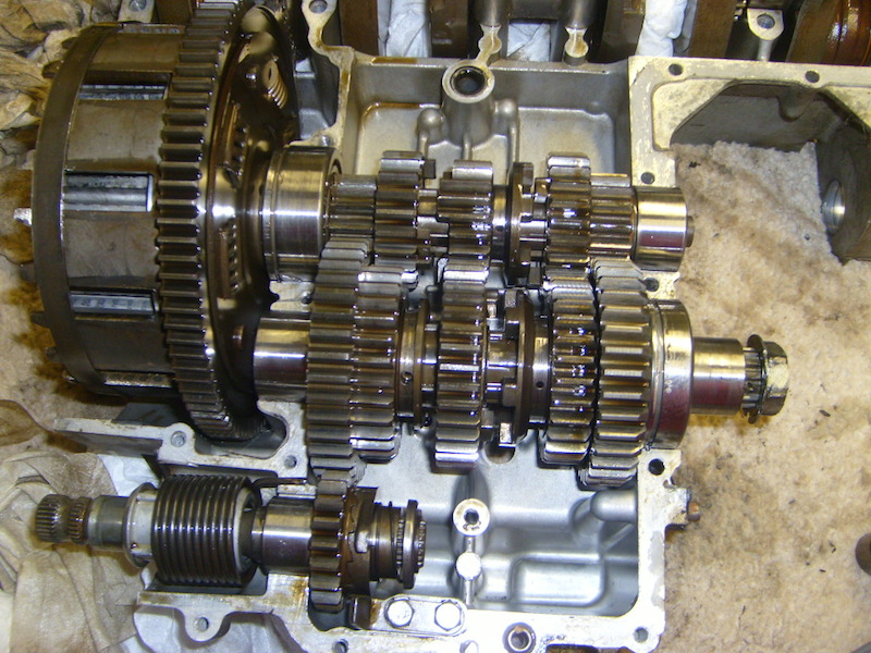

#4 PostAuthor: CAT3 » Thu Oct 22, 2020 6:42 pm
Looking at this picture I found it looks like you cannot remove the kickstart shaft without splitting the cases, but you may well be able to get the spring out and/or refit it it if has become dislodged.
There is also a "positive stop" mechansim , which should stop the kickstart from rotating too far forward.
You have refitted the small bracket on the crancase, held in place with two M6 bolts, haven't you ?
Or possibly the kickstart just needs repositioning on the splined shaft.

#7 PostAuthor: steve452 » Sun Nov 08, 2020 7:26 pm
Sorted yesterday! Took off the lever, couldn't get the cover off as I would have to take the carbs and airbox out to tap gently from the other side (there is a very slight raised area around the edge of the cover), and hoped I could solve it without this hassle. Thinking the ratchet and gear may have hydraulically locked together I smacked the end of the shaft with a rubber mallet a few times and also disengaged the clutch whilst turning the crank by hand. The shaft was still rotating but I took the chance and started the engine anyway after marking a white line on the exposed part of the shaft. The engine fired up after a few seconds and the shaft remained stationary much to my relief. I'm still not sure why the bloody thing did what it did the first time of trying but it's possible that it did lock itself as aforementioned.
