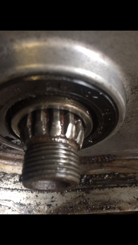

Too big a job as you say .i’ll just replace
Could have been worse!on motorway
standard shaft
