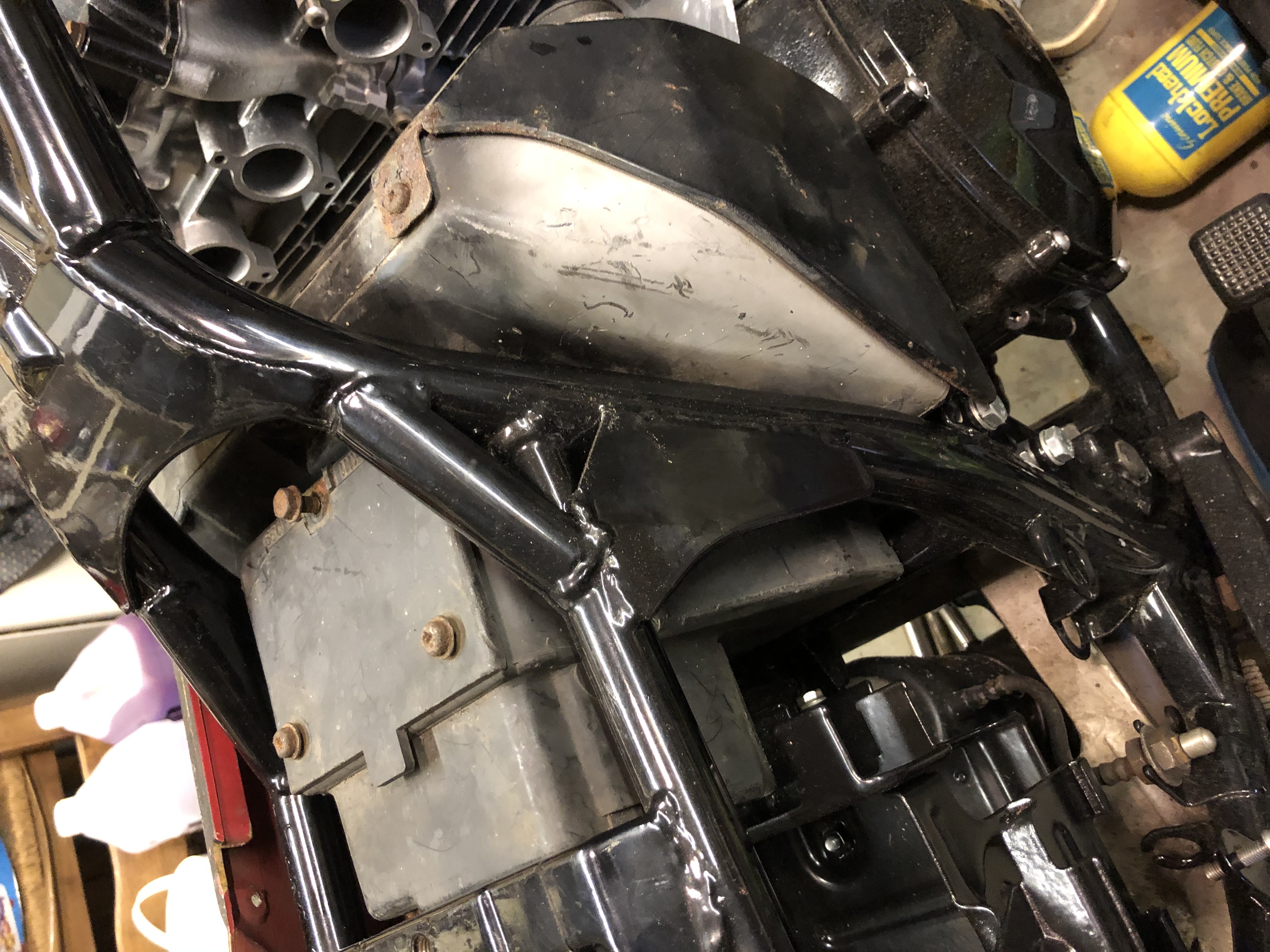

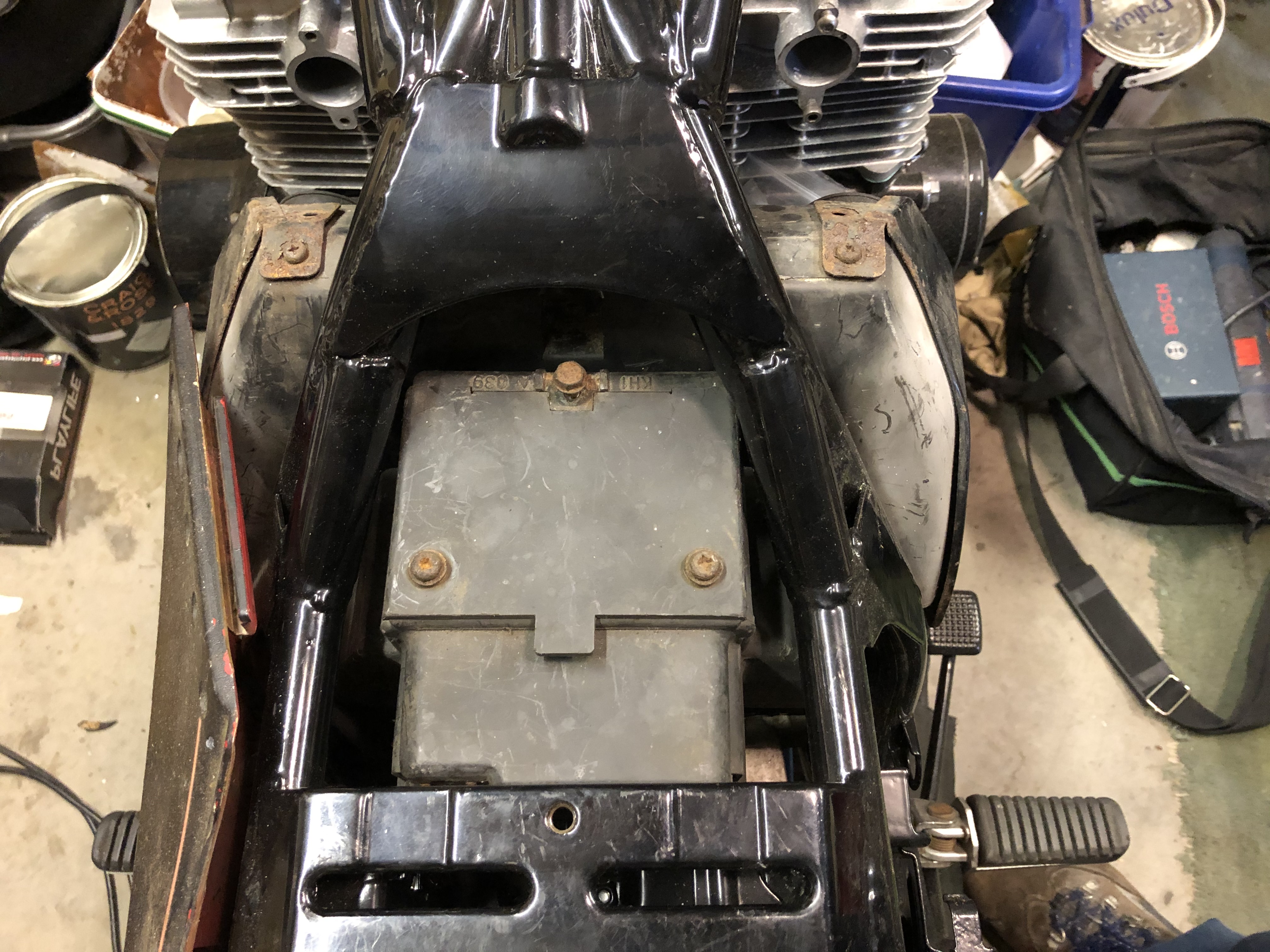

Here’s a couple of pic’s of the airbox in the Unitrak frame. There’s no free space in any direction.
If you look at the ID pic’s in the workshop manual, compare where the crankcase breather lines up, you can see there’s 20-30mm difference between the injected and carb’ed models.

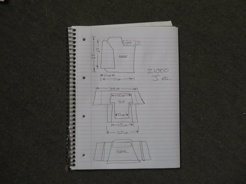

I have an airbox on my J, would it help you if i took a few measurements of the important bits?

Thanks AL, that would be great. From Olly’s comment it might be the length that’s critical but as many dimensions as possible. The more the merrier.
A2 1979-80. A1 1980-now
Posts: 2928
Re: Airbox options

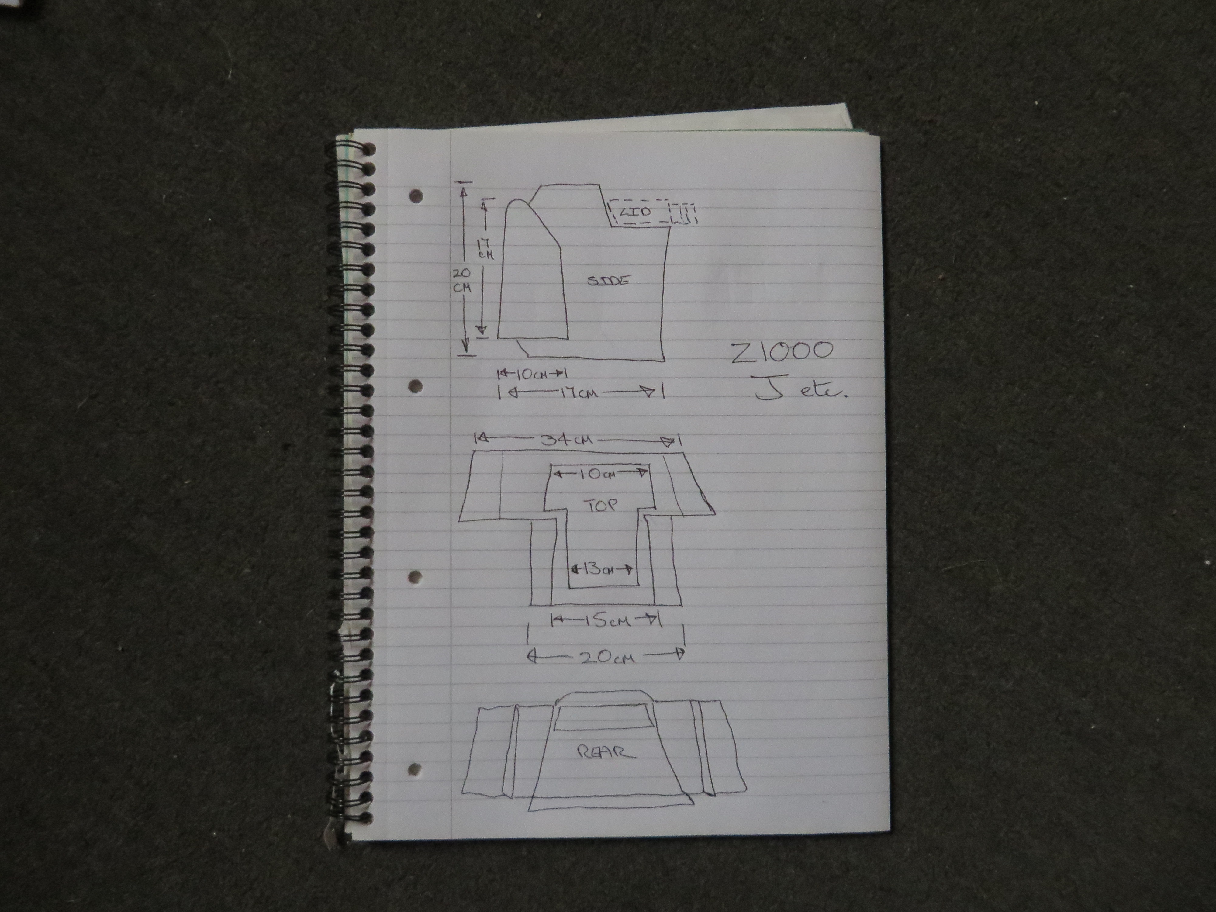

#8 PostAuthor: Al » Sat Nov 14, 2020 3:17 pm
Airbox still in the bike so not so easy to do but this should be OK. If not let me know and i can take a pic or something.

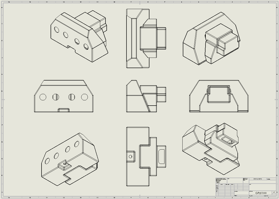

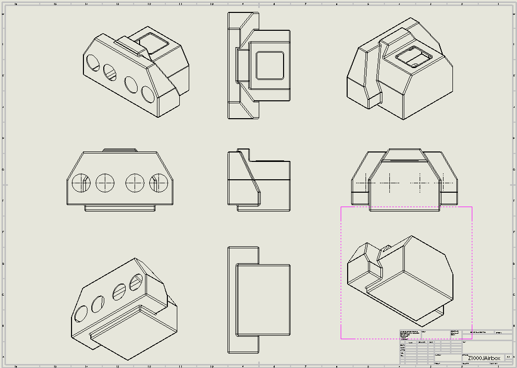

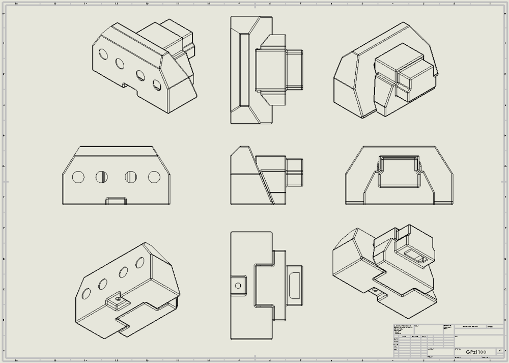

Thanks for that. I’ve modelled my Unitrak box in 3d cad. Then done the same with your dimensions.
I’m thinking the J box has the silencer in the lid whereas the Unitrak has the filter moved forward and the silencer on the end. This makes space for the fuel pump.

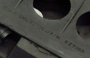

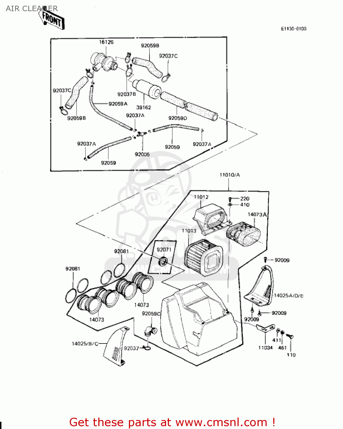

Does your airbox have any identifying characters under the carb rubbers? I found this on ebay.
Posts: 2928
Re: Airbox options
#10 PostAuthor: Al » Sun Nov 15, 2020 11:02 am
Yes mine has the same numbers as that one you found. I cant see it, but found this one which should be the same thing with a few details exceptions.
https://www.ebay.co.uk/itm/Kawasaki-KZ1 ... 0667.m2042
The J Etc. airbox has the lid on top at the back and a snorkel as per the above link. I see they have a 30 day refund policy. Perhaps soak up the postage and return postage and try it and see. Nothing like trying it in the hole for size :)
Can you superimpose one airbox on the other to see where they may not be the same?

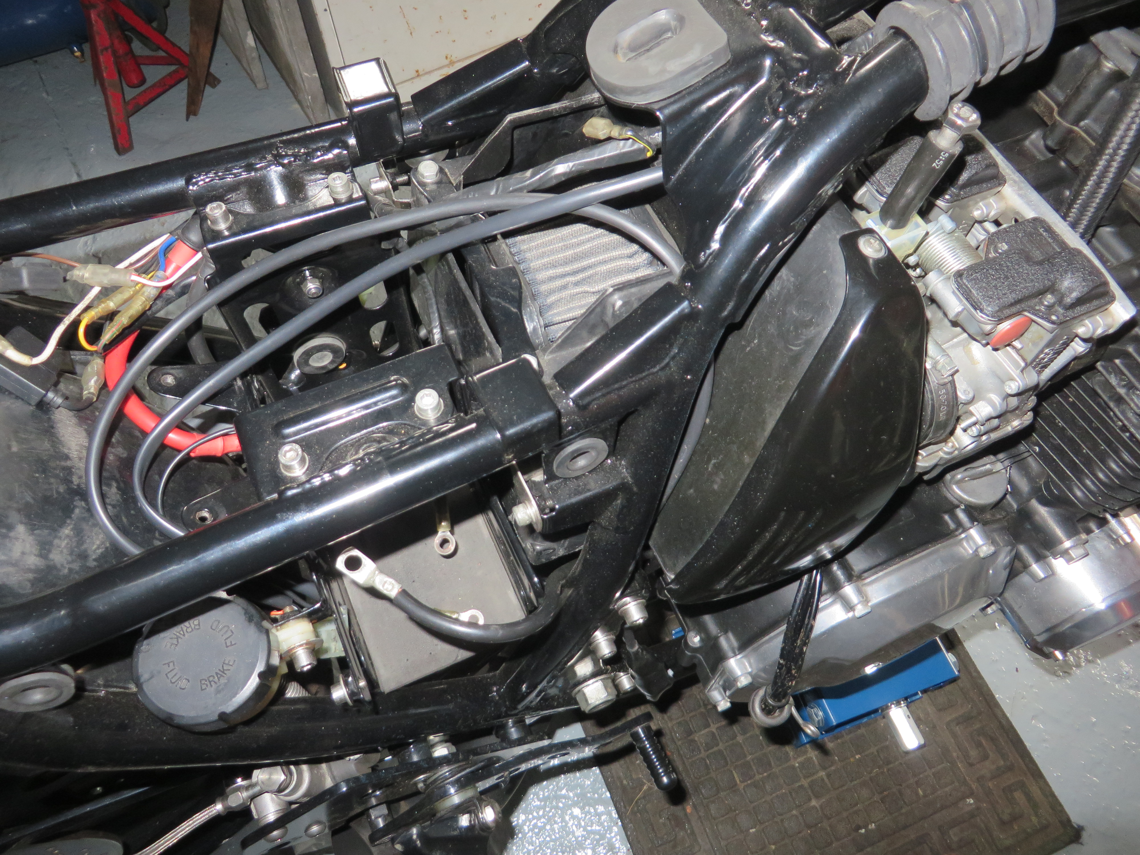

I dont use the lid or snorkel on mine but have made a small bracket to replace the lid since it holds the filter in place. I have taken a couple of pictures to that effect which i can post in a bit.
