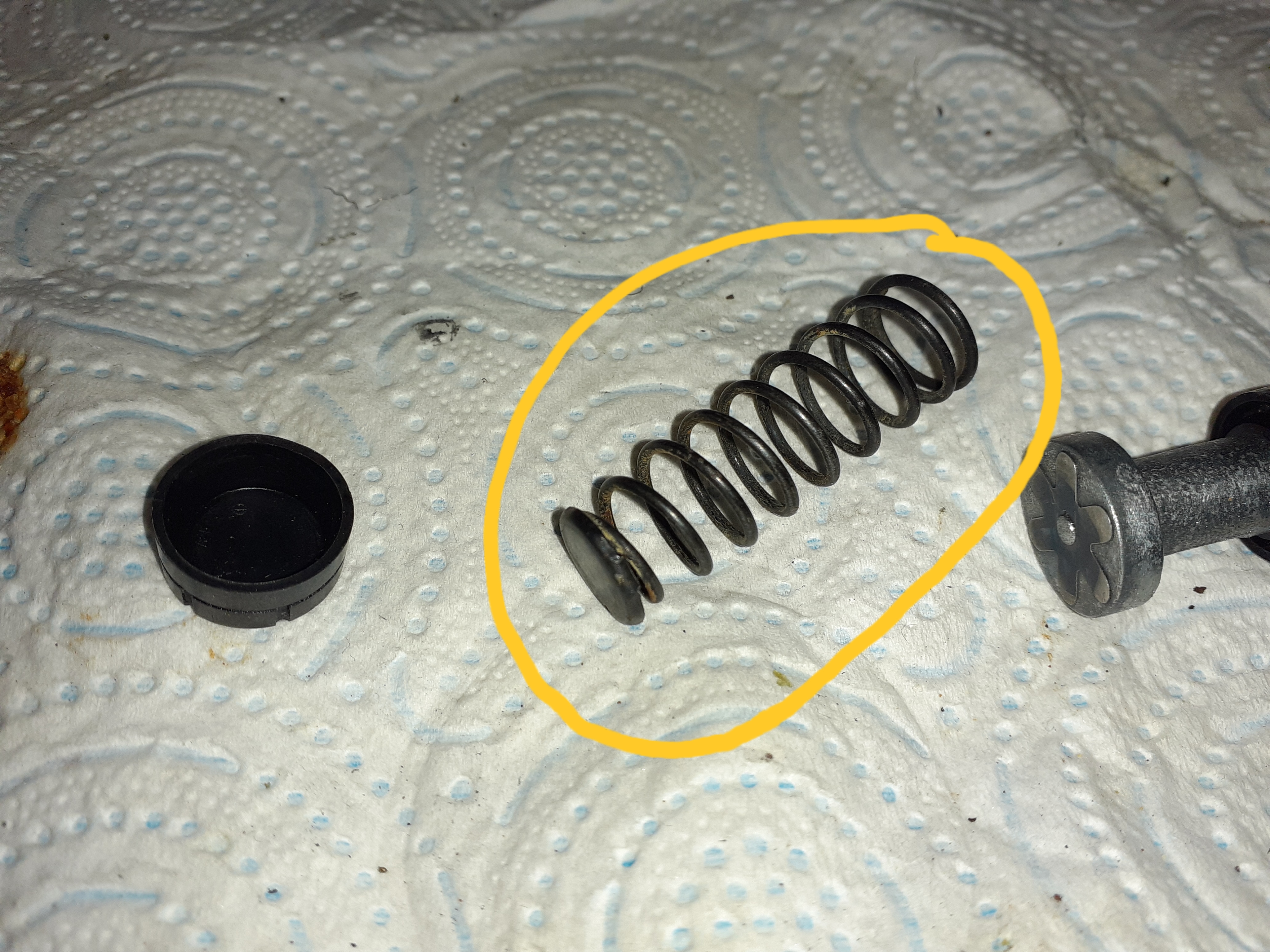

Hiya chaps, just stripped down a rear master cylinder. When I released the 'plunger/ram', the spring and rubber cap(to the left in photo)flew out. Can someone tell me which way round they go please (been a couple of years since I last did 1). The spring is the tapered 1.
Thanks freddy [image][/image]

Narrow end of spring in rubber cup, rubber cup against ram.
