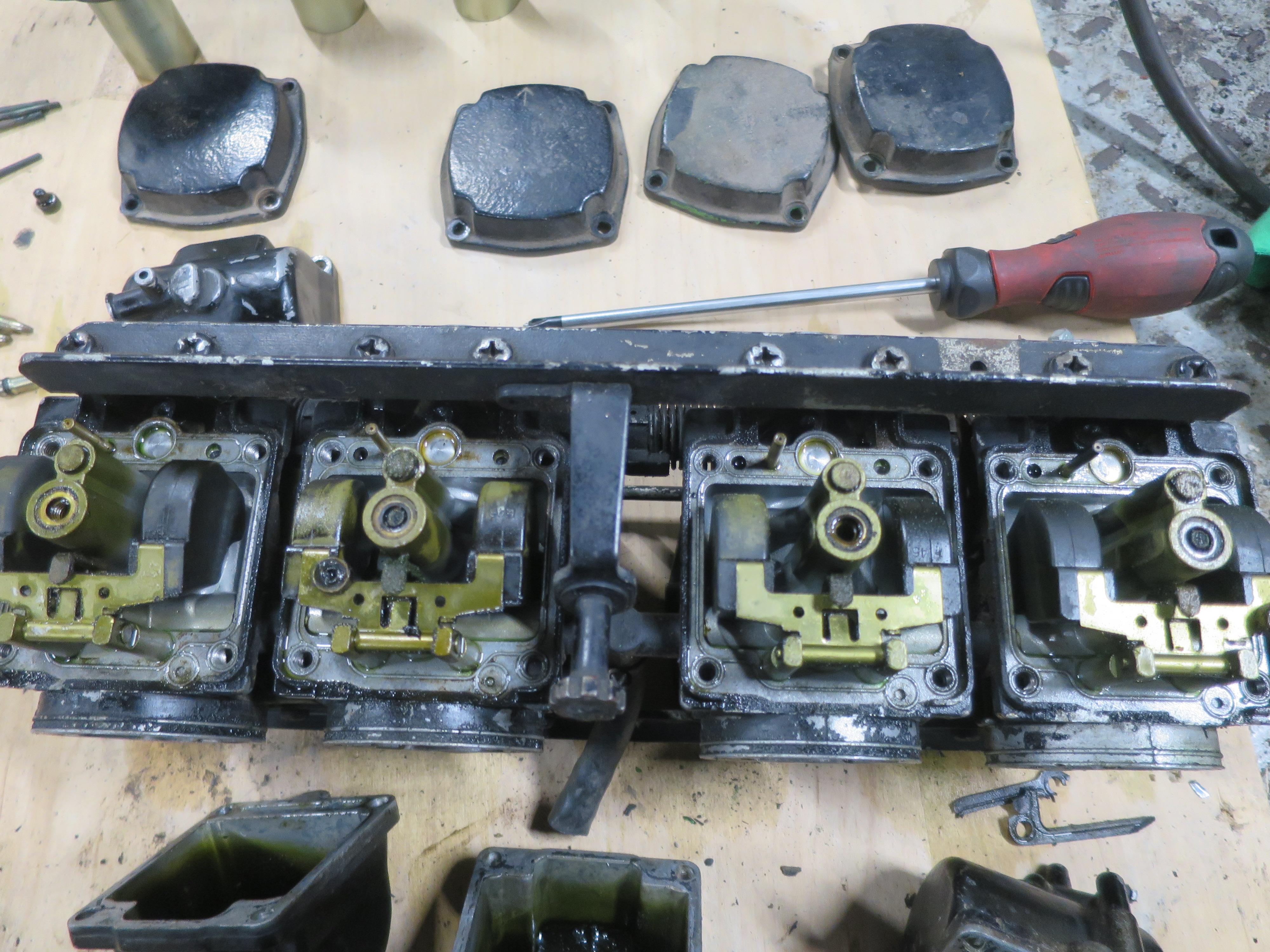

Well, with this new lock down in place and the bike in a thousand pieces there isn't much else to do so I started stripping the Carbs... :ghostface What a mess!

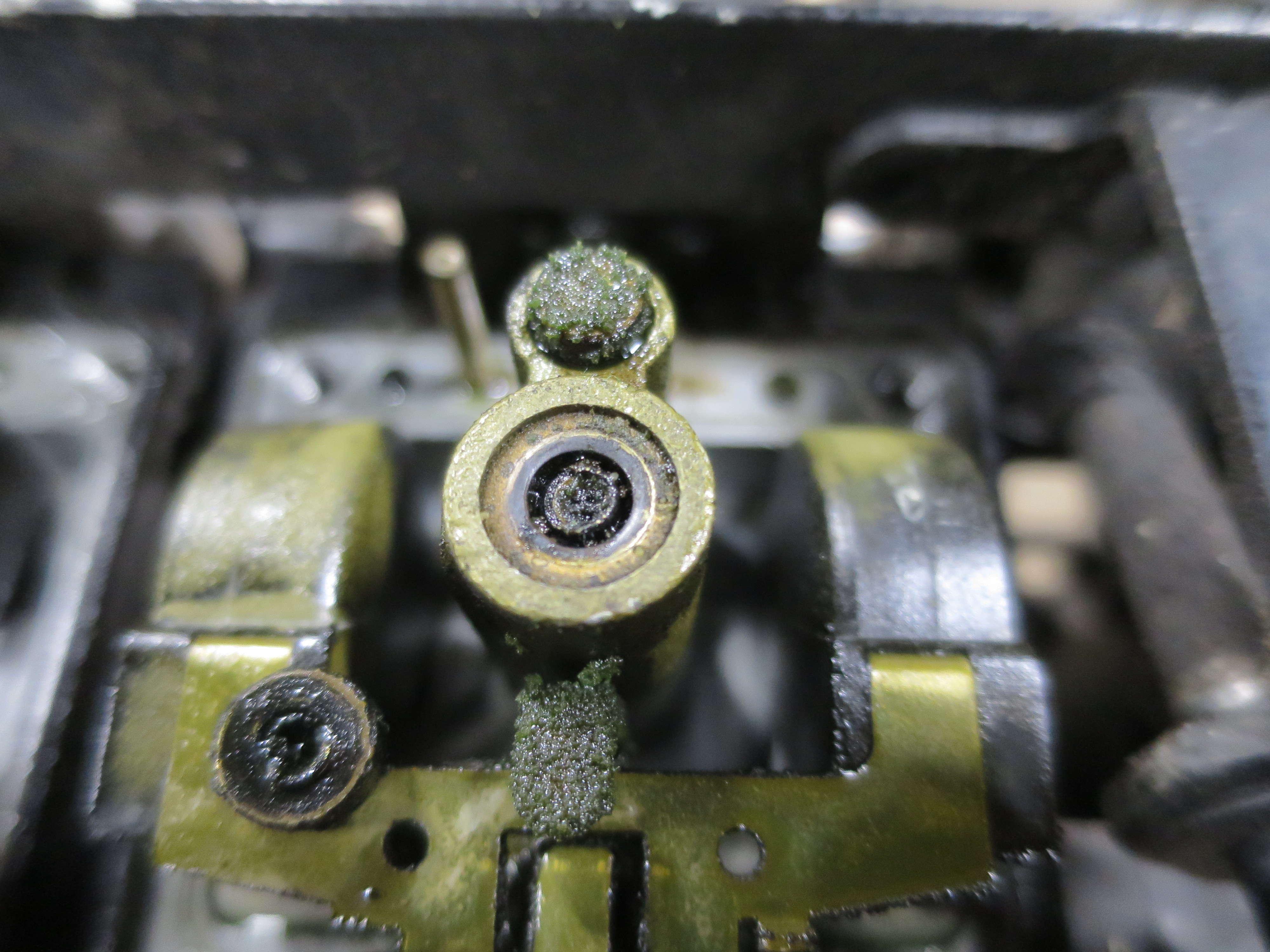

two of the four Screws in side the bowl that ( I guess) the needle seats into were sheard off.
Can the Main jet sleeve that the needle travels along be removed easily, and if so how?
Also, I see there are sets of service kits available on Ebay, some are more complete than others, any recommendations on ones to use or avoid?

send them to dave mudie up in sunderland,they come back mint and it saves you a lot of heart ache.pm for his number

Ouch, looks like you’ve got some contaminates in there.
If you want to do them yourself, there’s a brass washer to take off then you can tap them out with a punch. With that gunge they might be a bit tight so I’d do them in the house at room temperature with a plastic or ally punch.
