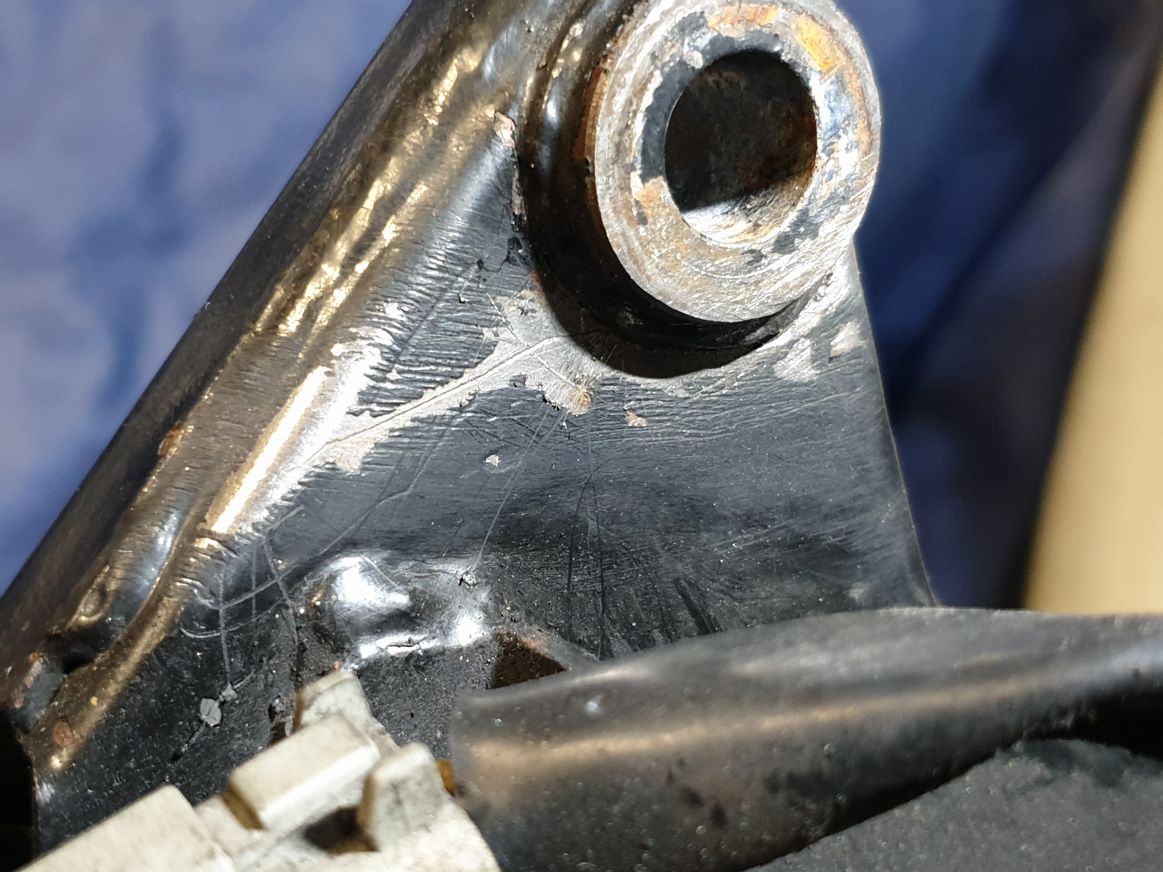

1- Cracked rear engine mount lug. Obvious answer is to weld it. I think it's old accident damage. Anyone else ever seen this?

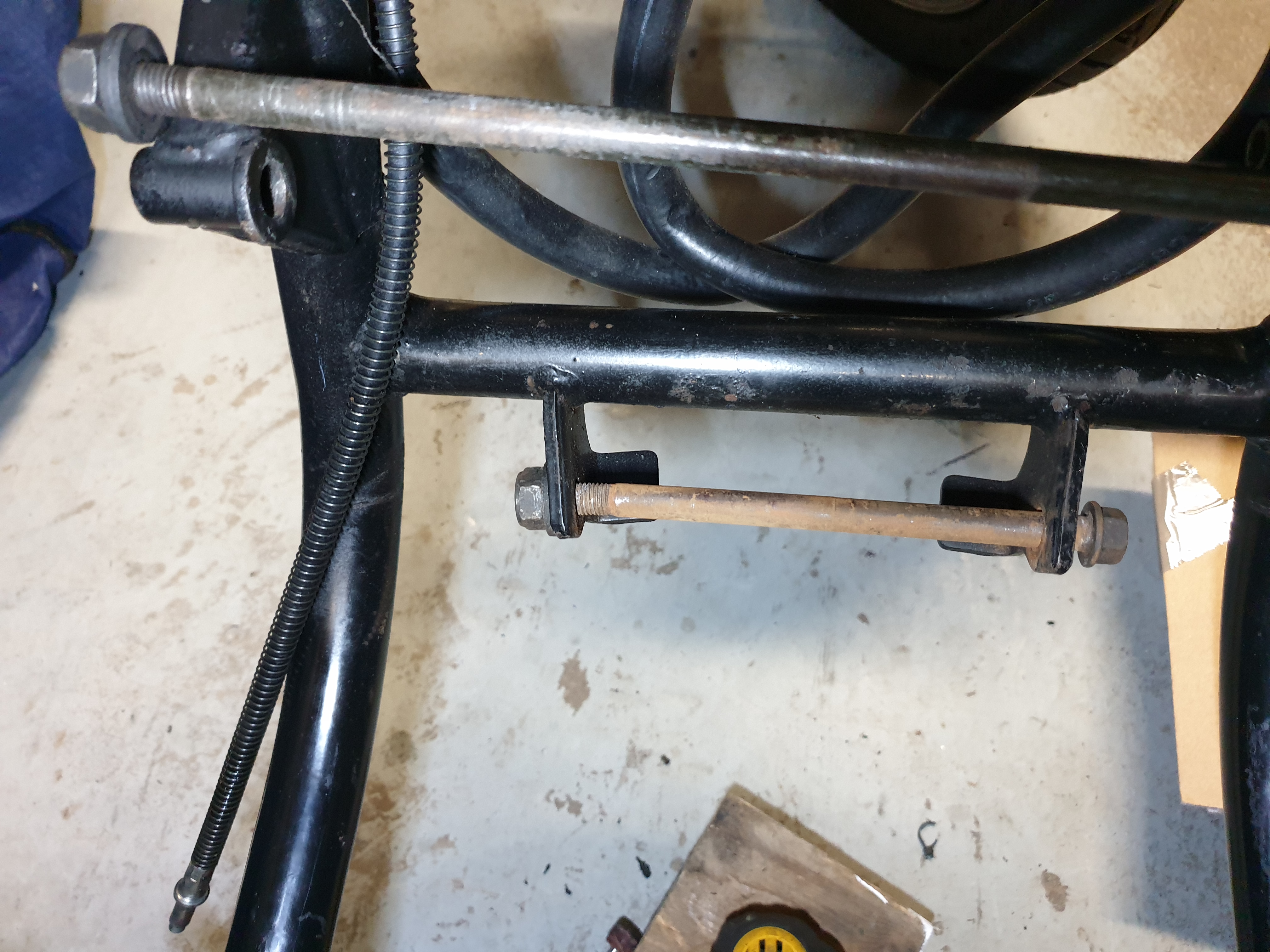

2 - lower front engine mounts bent all to nonsense. Looks like I'm missing two spacers 92075-1274, and the bolt has just been horsed up tight anyway. I would normally order new from CMSNL but under the current circumstances who knows how long they'd take to arrive. Has anyone got a couple of spares?
On that subject, I've seen mention of people replacing the two pairs front isolastic engine mounts on these later engines with solid inserts to stiffen the frame up. Is this worth thinking about?

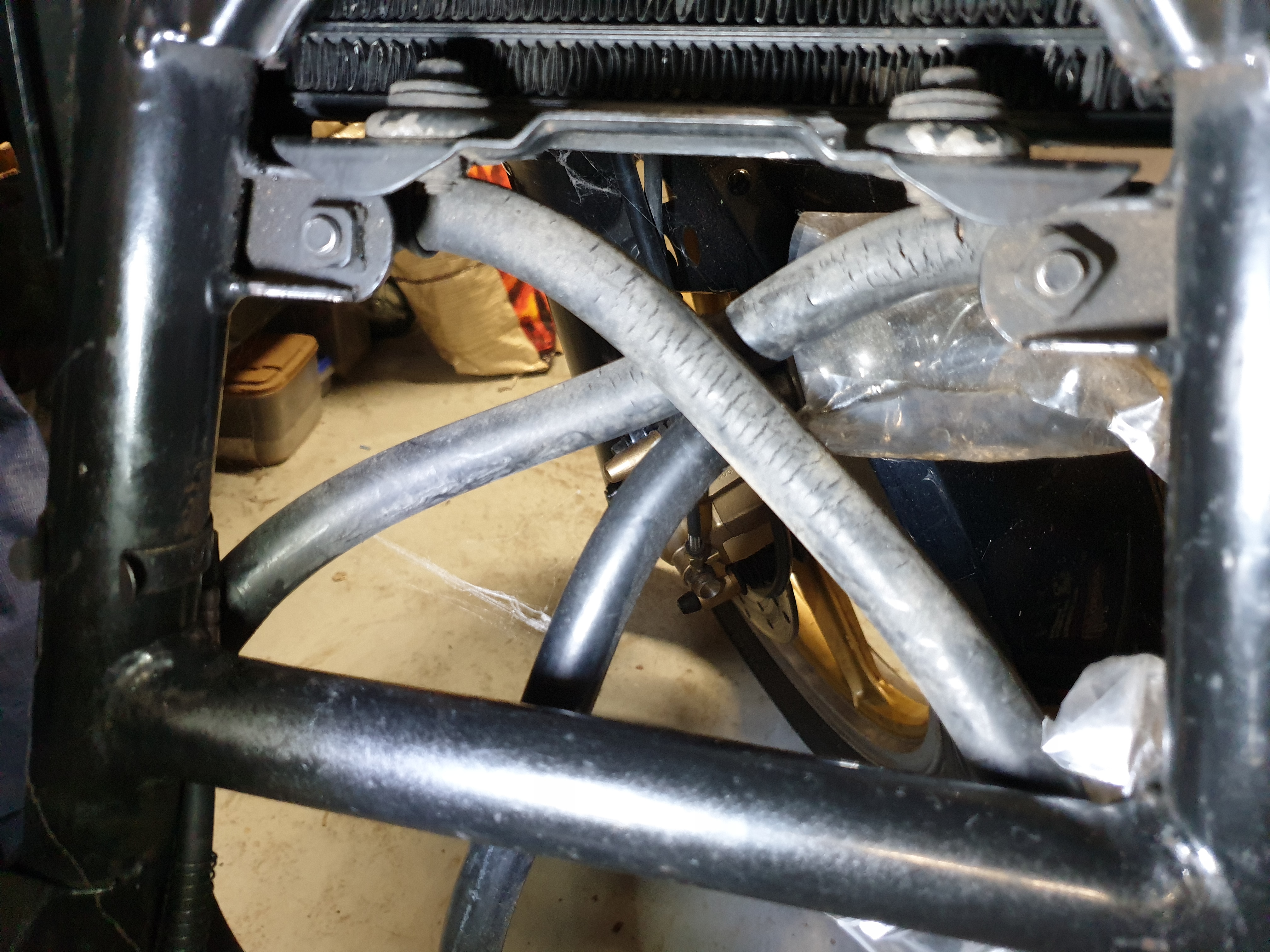

3 - cracked oil cooler hoses. Only visible on the outside, but I don't want the inner surface to start breaking up and filling my nice engine with its rebuilt top end up with rubber particles. NOS cost a fortune from CMSNL. Any suggestions for a more economic fix would be gratefully received.

1: probably due to metal fatigue,weld it, paint it.
2: straighten the engine mounts, find second hand or new spacers and a bolt and mount the engine.
My B2 rides like a train on tracks, no need for solid inserts.
3: buy good second hand oil cooler hoses and replace them, no need to spend a fortune on new ones.

The solid front engine mount modification does make a small contribution to the stiffnes and handling but on an otherwise standard road bike i would think it would be imperceptible. I have done it to mine (currently) and its part of a basket of small other changes, which taken together, make a big difference. As you can imagine though; as the engine starts to make power the vibrations go up... very noticably as well. On an otherwise standard road bike, this would ruin what is one of the best riding bikes of it period. If you read the contemporary road tests they took it to a track and could not find any tangible idiosyncrasies. For a road bike i would not bother.
Do you have the thick 'U' shaped spacer for the top engine mount bolt that goes on the LHS upper?

I have replaced the oil cooler hoses with later type braided / re-infrced hose which you buy by the length. The original hose clamps are soldered to the main fitting first and then the hose inserted and machine crimped afterward. You would need to un-solder the crimps being careful not to get it all too hot because the hose tails are also soldered into the blocks. The hose tails are also plain as in parallel. They dont have any means of resisting plain hose from falling off. In my case i bought plain black braided hose and shielded jubilee type fitting but; modified the ends of the hose tails to prevent the hose slipping off. I might be a bit neurotic by nature

Still leaves me missing two spacers 92075-1274. I could do with a replacement bolt too, but the old one should straighten out if it has to.

spacers part no 92075-1274 in stock at cradley

It turns out they are used on lots of bigger 80s and 90s kawa's, including zzr600 and 1100, so there are loads about if you search for other bikes. Ive just bought 4 used ones plus a pile of bushes and bolts etc for £15.
I'm doing a top end rebuild and a recommission, not a restoration, so unless the used bits turn out to be complete trash (unlikely) they'll do.
