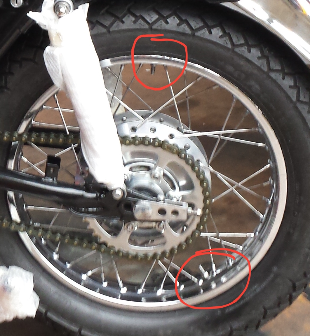

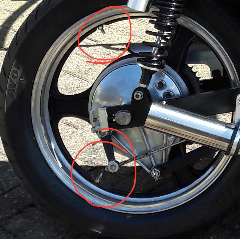

No issue really, I wouldn't bother adding them on new rims. Modern tires are a whole world away from what we used back in the day.
What is interesting though is that out of curiosity I have double checked my bikes and stock of old rear rims and I have both types of positioning.
Attached, pics of 650's with 120deg spacings both stock and afterarket. It kinda makes sense on the after market because, 3 spokes, 3 holes equidistant between the spokes.
What Philippe says makes sense re balancing but it's not what I found on my 650 stock rim but it is what I found on a 650 spare rim. Usual 70's manufacturing I guess.
