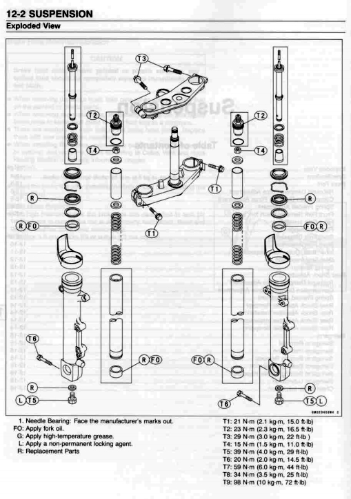

Here's the IPC for the 1200R which I'm 99% sure is the same.

Thanks for that Will. I can see the stub at the rear and bottom of the fork legs. There is no part number for the compression rebound mechanism, however it is removable by drilling the pin out and can be replaced with an aftermarket item, apparently. I once found a diagram depicting how these type of mechanisms work internally, buggered if i can find it again!!!
