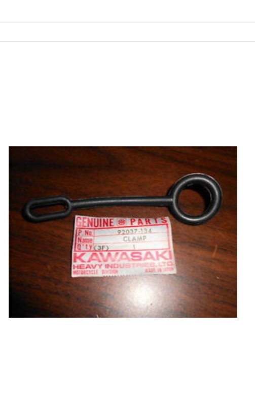

Hi mate, you need one of these, obtained from z Power if you haven't got one. It raps around the upper righthand engine mount bolt, and the pipes are fed through it.

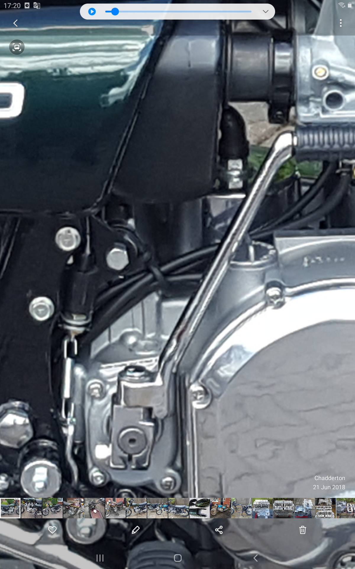

Wrigers wrote:Hi mate, you need one of these, obtained from z Power if you haven't got one. It raps around the upper righthand engine mount bolt, and the pipes are fed through it.Screenshot_20210314-172015_Gallery.jpg
Excellent thanks.
Then just drop the pipes down clear of the exhausts I guess.

Drop the pipes in between rear of engine and swinging arm !

My Z400J has one of those rubber things, but never could figure out how it was attached to the bike.
Until now!
Thanks Wrigers. Another mystery solved.
