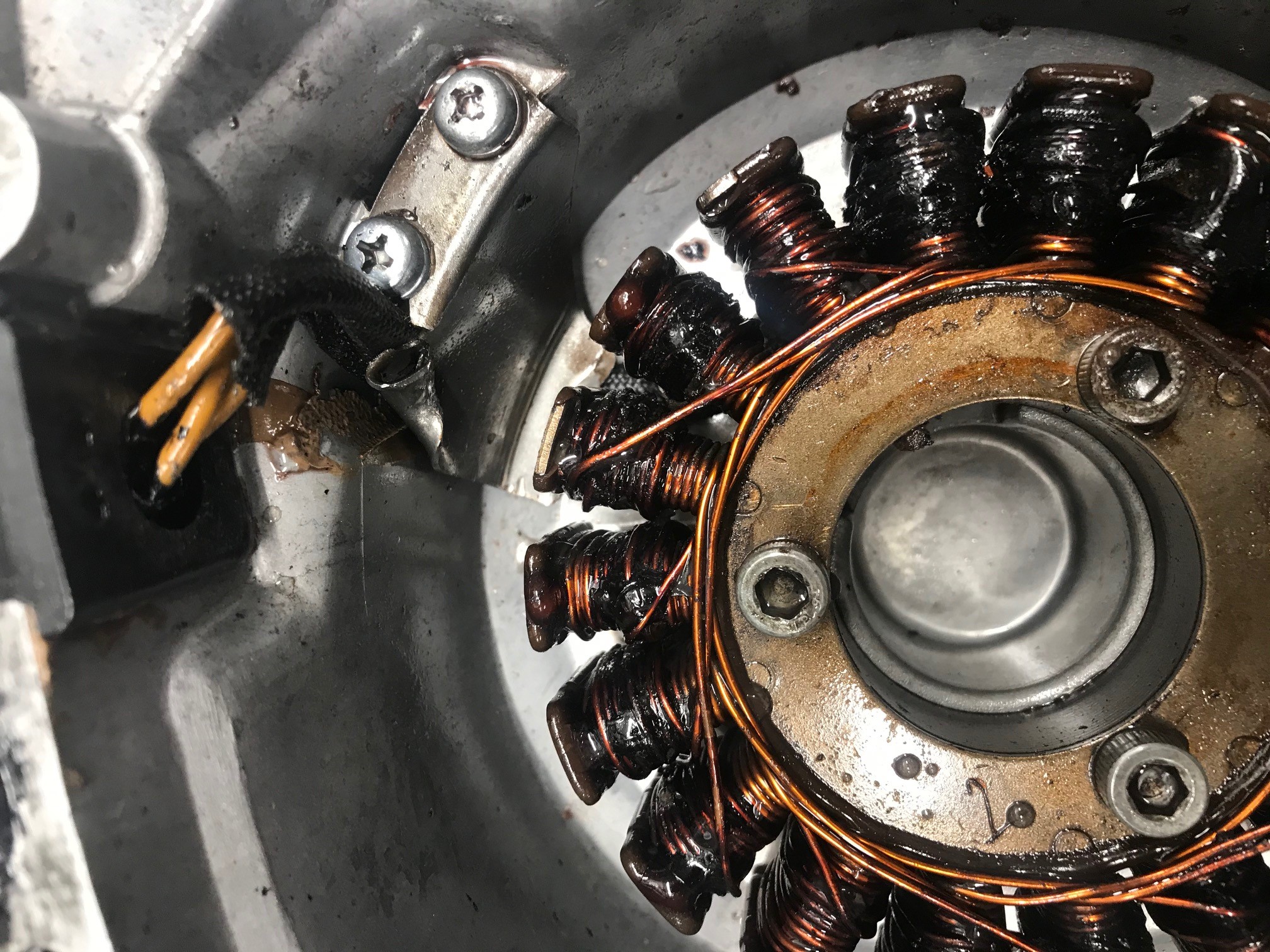

Yes indeed sorry its a G03 Rotor - I just ordered a New One to replace this one since the Magnet was damaged. I suspect the Magnet got chipped when I removed the Cover rather than during operation must have come off a bit too sideways with the cover! OK So I will stick with the standard screws and hopefully these washers will fit in behind for some extra protection along with the High Strength lock.

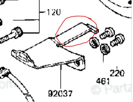

Yeah the Metal Plate is mangled on the part shown here, I was planning to just remove the mangled part as looks like the long arm part doesn't really do much once installed as should be well clear or the wheel itself by then. Perhaps caught on the raised weight I assume on the Flywheel itself and hasn't been doing anything for a while as was bent right over itself.
No signs of any cracking on the flywheel itself and it had not come loose, just the Starter Clutch 3 bolts had. It doesn't look like it was held on with any form of locking compound. I guess I need a Retaining compound for that rather than threadlock?

Posts: 2916
Re: Z1000J Starter Clutch - Flywheel
#9 PostAuthor: Al » Tue Mar 23, 2021 10:32 pm
That is a bit odd, its usually the foot part that suffers as a result of not being tucked in properly. Sod to get off and on as it snatches out of youre hand one way and comes off like a bomb the other.
I would go with the standard screws, Schnoor or equivalent washers and permanent threadlock just for those three screws. Havnt seen it for a while but thought the counterbores for the heads of the socket caps were a pretty close fit so you may struggle with broad flat washers.
As for the rotor onto the crank nose i doubt i'd bother with bearing fit or the like on the understanding that it has a keyway slot. Normally you lap the rotor on if it needs it. Put it in place and give it a thump. If it grips that way, it will grip under torque loading. If it bounces back at you then more lapping required. Keyway cut ones, i really couldn't say as i have not used one.
Matter of interest; does that stator winding pass a short to earth test? it all looks a bit crispy :shock:

Cheers Al, ok understood on the flywheel and lapping will check new one is ok. The last one was not on with anything either. I am suspecting the tab maybe just got bent when it was being put back together but you would think it would have been noticed as a bit of a shove to bend that out of the way. Guess I’ll never know.
Not sure but I will check it electrically! Good point!

AL - you were right that alternator is toast - I have no idea how it was even charging but needs to be replaced. Unfortunately Elextrixworld out of stock so I will need to order an alternative make.
