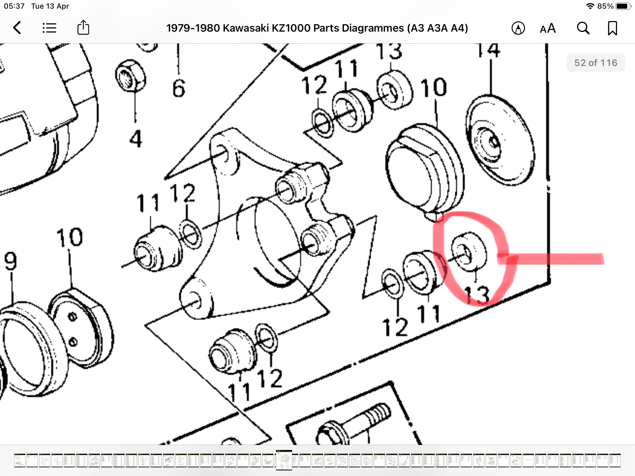

Hi everyone
Does anyone know where I can get 4 of these spacers/ plugs part no. 43088-002 or can give me the dimensions so I can get some made
Gavin

At some risk Gavin are you actually sure they are missing ? they are a pretty tight fit so would need knocking out, so basically put if the two holes at the back of the caliper are M10 sized and not around 25mm then they are in situe :) :up

Cheers Keith, I will check, it appears when I pull the lever the calipers, well the left one has quite a lot of movement before the pad touches the disc.

Well it appears all 4 are missing and pretty unavailable in the UK, so need to come up with a plan B which looks like getting a batch of M10x16mm shim washers and using them as the spacers.
Need to go to a plan C the washer I mentioned are exactly 10mm ID so no clearance, bugger.

Well come up with a plan C, using some Aluminium spacers I have found on flea bay, can someone in the know tell me do these Plugs/spacers sit flush with the surface 6mm or slightly set under flush.
