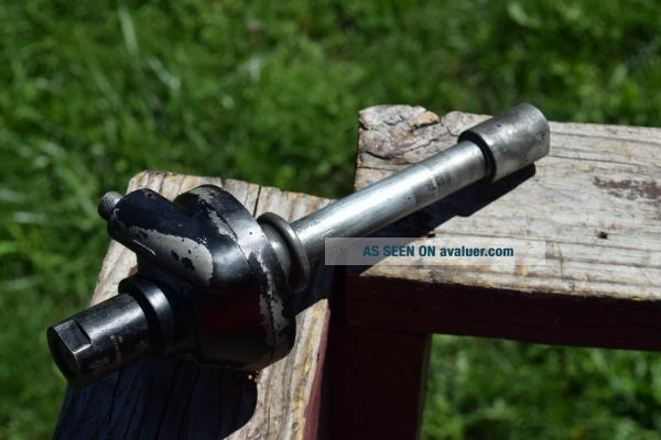

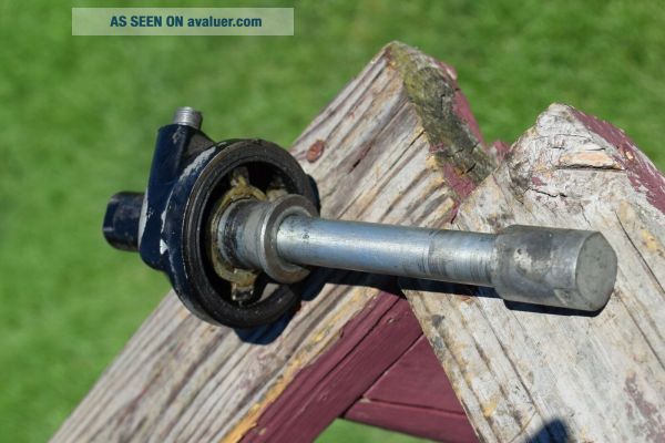

The speedo drive for a z1 6 bolt hub is part of the front axle nut fitting. see photo, (pinched from internet)
- Attachments
- kawasaki-3_7000.jpg (42.33 KiB) Viewed 3458 times
- early_front_axle_wspeedo_drive_vintage_kawasaki-1_7000.jpg (36.95 KiB) Viewed 3459 times

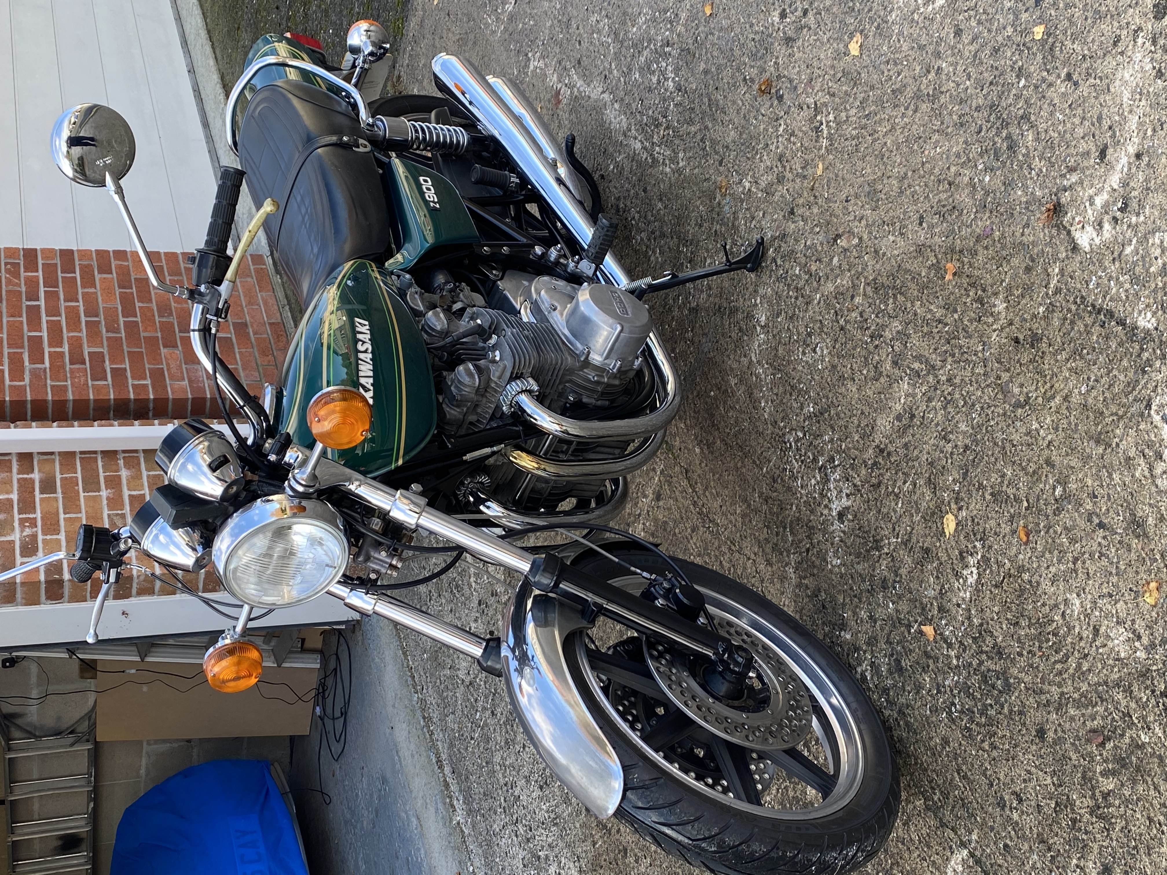

Your bike looks like Z900 A4,- should have 4 bolt discs. Also different speedo drive. Correct parts will bolt straight on
Re: Fitting chrome wheels to my Z900 a4
As has been said, the A4's have fronts discs with four bolts, earlier Z1's were six bolt.
I'm guessing someone has fitted earlier Z1 Lesters.
Your wheel also has the wrong axle/nuts fitted, it should pass through the fork bottoms & have nuts on the outside of the fork caps.
The actual forks look to be A4 ones, but fitted back to front, (a common mod back in the day). The drain screws should be at the back of the leg, not at the front !
