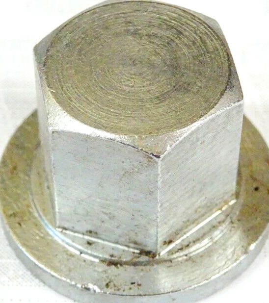

They polish the parts to get all the pitting and damage caused by corrosion over the years out, most steel parts originally would have been plated right after pressing/machining without further finishing, so to get back to that is a very tall order, buying new is a better way to get a factory finish.

wilsonsjw11 wrote:It’s hard to get a chromer that doesn’t over polish the parts.
An almost impossible task if you want to retain the turning and milling marks as seen below. Only option is to get them de-chromed and then you do any prep work yourself. Then return for chroming with explicit orders not to polish. Good luck. If the nuts are badly pitted I wouldn't even bother :(
