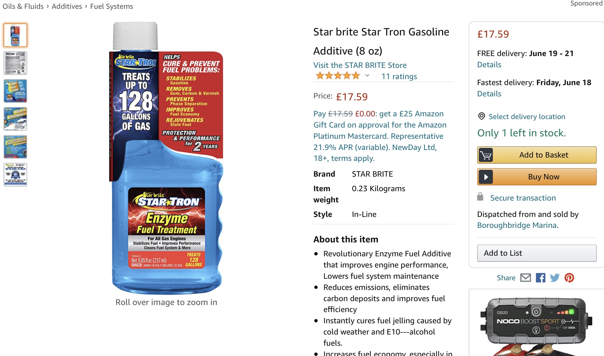

I have used star brite star tron additive for a good few years and seems to work fine - in USA the marine industry seem to use it and petrol lawn mowers over the winter season
I started bike no problem after 8 months - worth reading about
You can get it from several suppliers in Amazon
