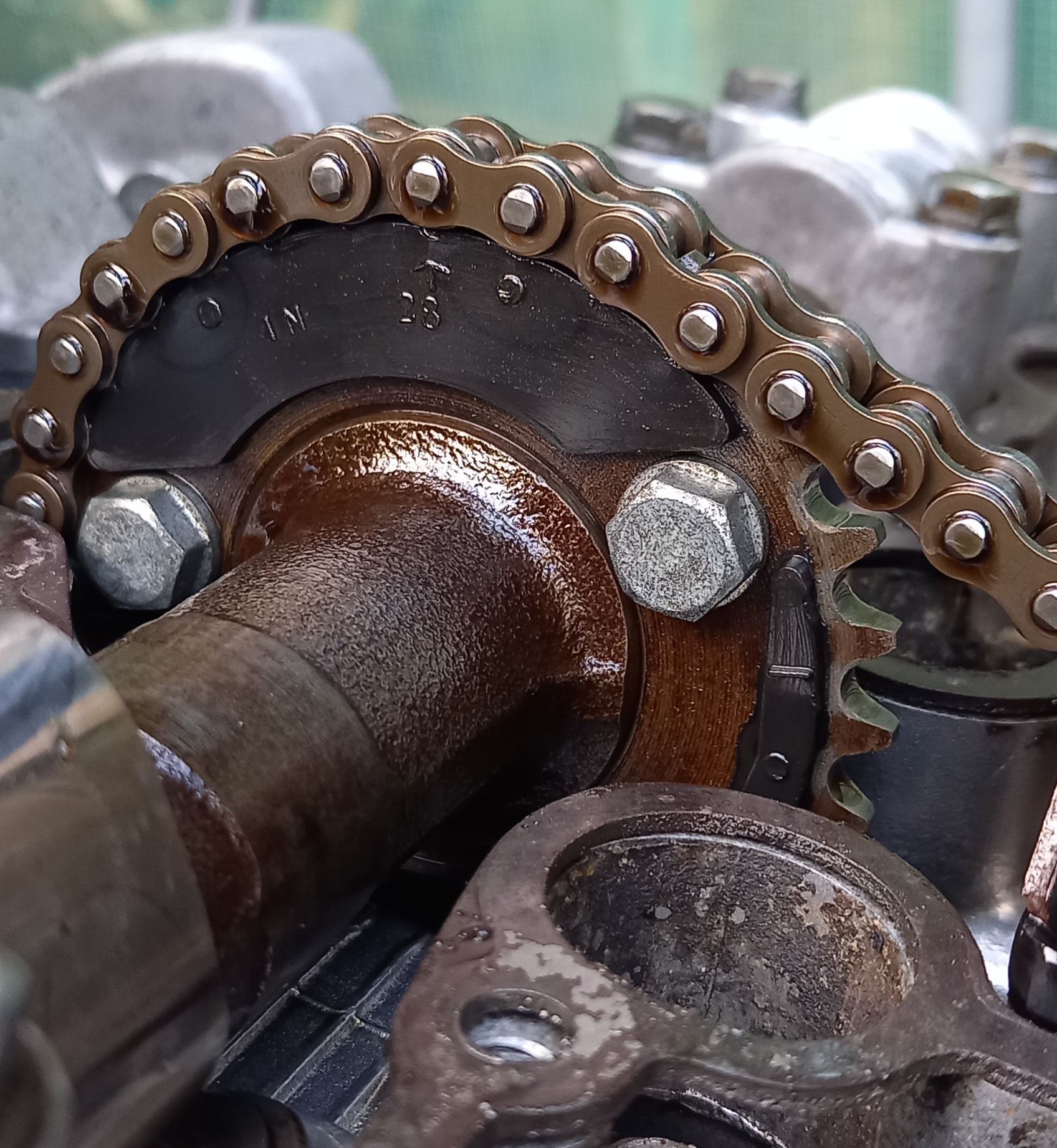

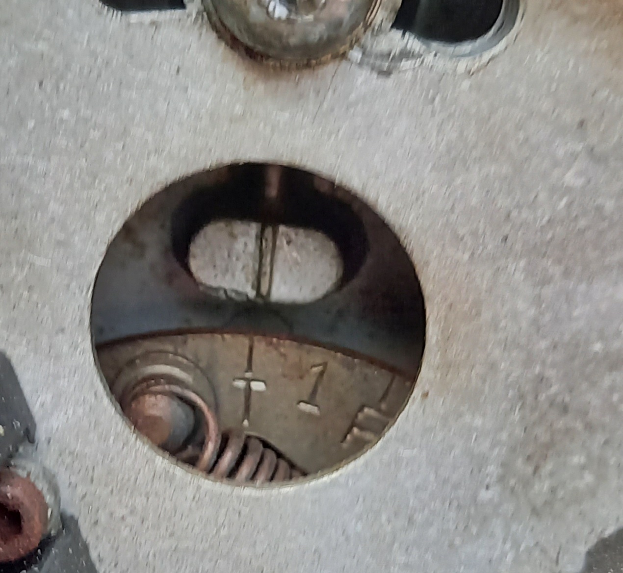

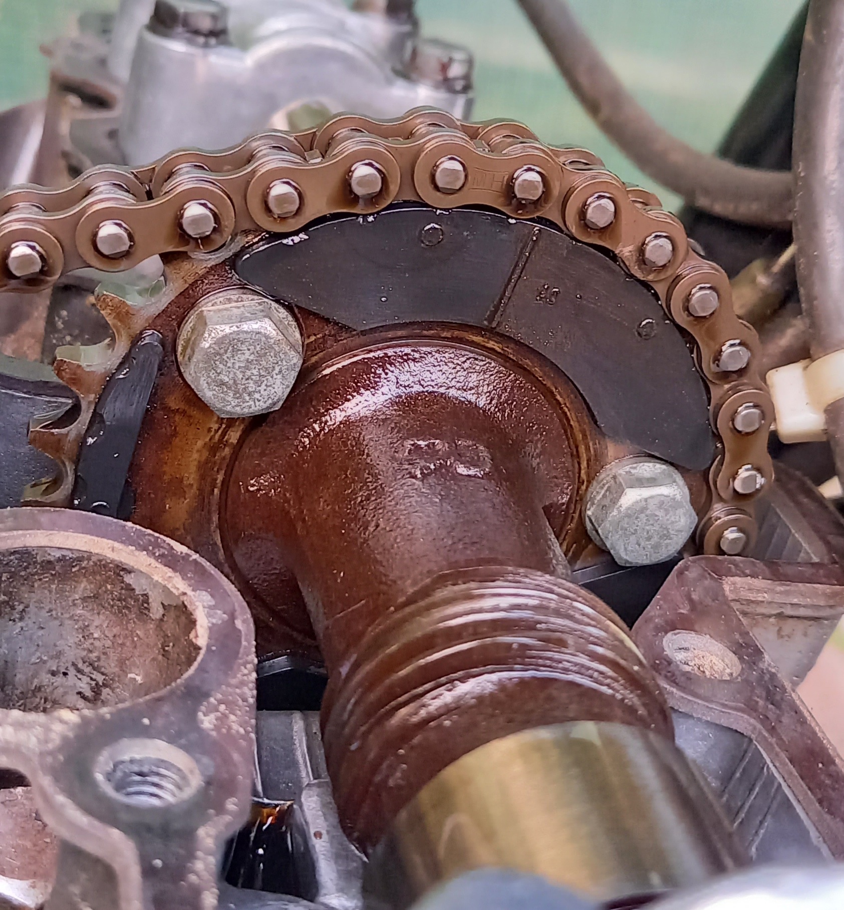

Hi folks,
I can't seem to get this straight in my head so if I post some photos (we love photos) can someone rattle my brain please?
Okies...it is a z1b lump....looks to have had cam damage at some point.
It runs, but not great.
I've rotated timing mark to tdc on 1 and 4.
Inlet cam timing marks are not Level with head.
Exhaust markings....well who the heck knows?
Am I trying to set these up correctly or am I missing summat? apart from a few brain cells!
Any help or piss takes great fully received.

Isnt the cam timing marks on those on the center line of the apex sprocket bolt ?
Looks ok if thats the case.

Been trying to follow the Clymer book but it's got me going round in circles......but thanks for that
Re: cam timing....
Step back and take a pic showing how the cam lobes are lying against the head surface please

Hi Pete
have a look at how the camshaft ends are situated in my topic "Z1000A1 restoration" in "Projects" . There are pictures of how the camshafts should be at TDP of cylinders 1 and 4. Pay attention to the position of the cam lobes of the fourth cylinder.
Start by looking at the position of the exhaust camshaft. There's an arrow on the sprocket. That arrow must be aligned with the upper part of the cylinder head. When counting the 28 pins of the camchain, start with the pin right ABOVE that mark.
The 28th pin of the camchain must be on top of the "28" mark on the sprocket of the inlet camshaft.
If you do this correctly the two camshafts must be in the correct position.
Good luck
Good luck

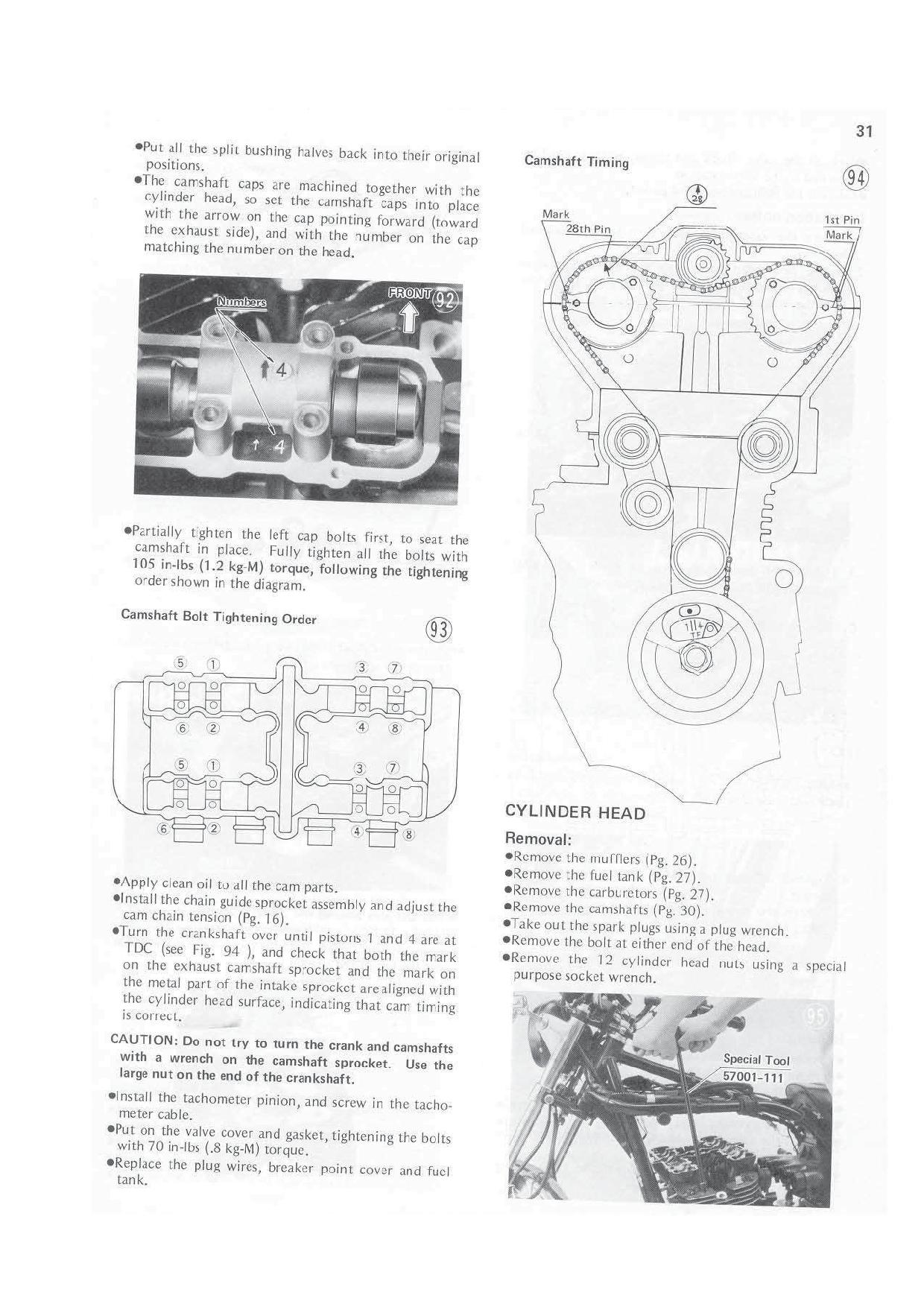

Extracts from Kawaskai Z1 Service manual, easier to follow than Clymer manual.

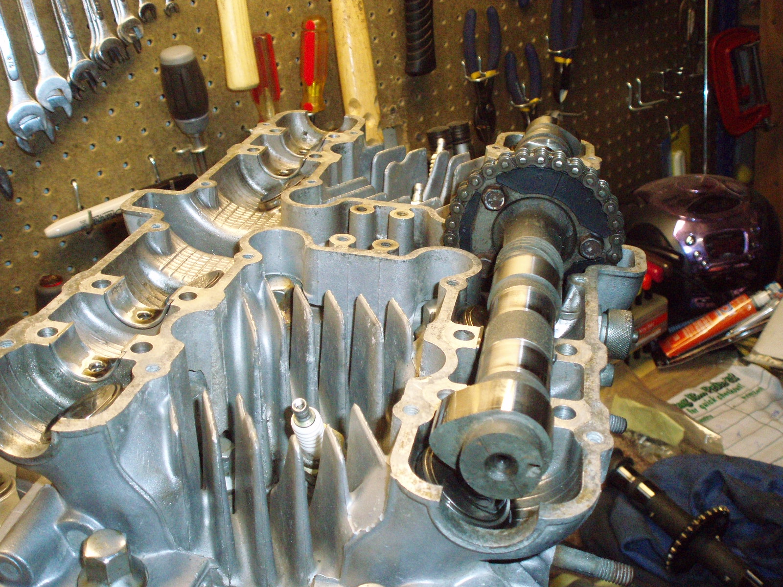

Re: cam timing....
Picture of the Outlet cam fitted - Arrow on Cam sprocket Horizontal - in line with top of Cylinder head.
Note notch mark at the ends of cam is horizontal and facing forwards.
TEXT edited, had a senior moment. dooh.

Looks like exhaust not inlet Adrian.
ADRIAN H wrote:Picture of the Inlet cam fitted - Arrow on Cam sprocket Horizontal - in line with top of Cylinder head.

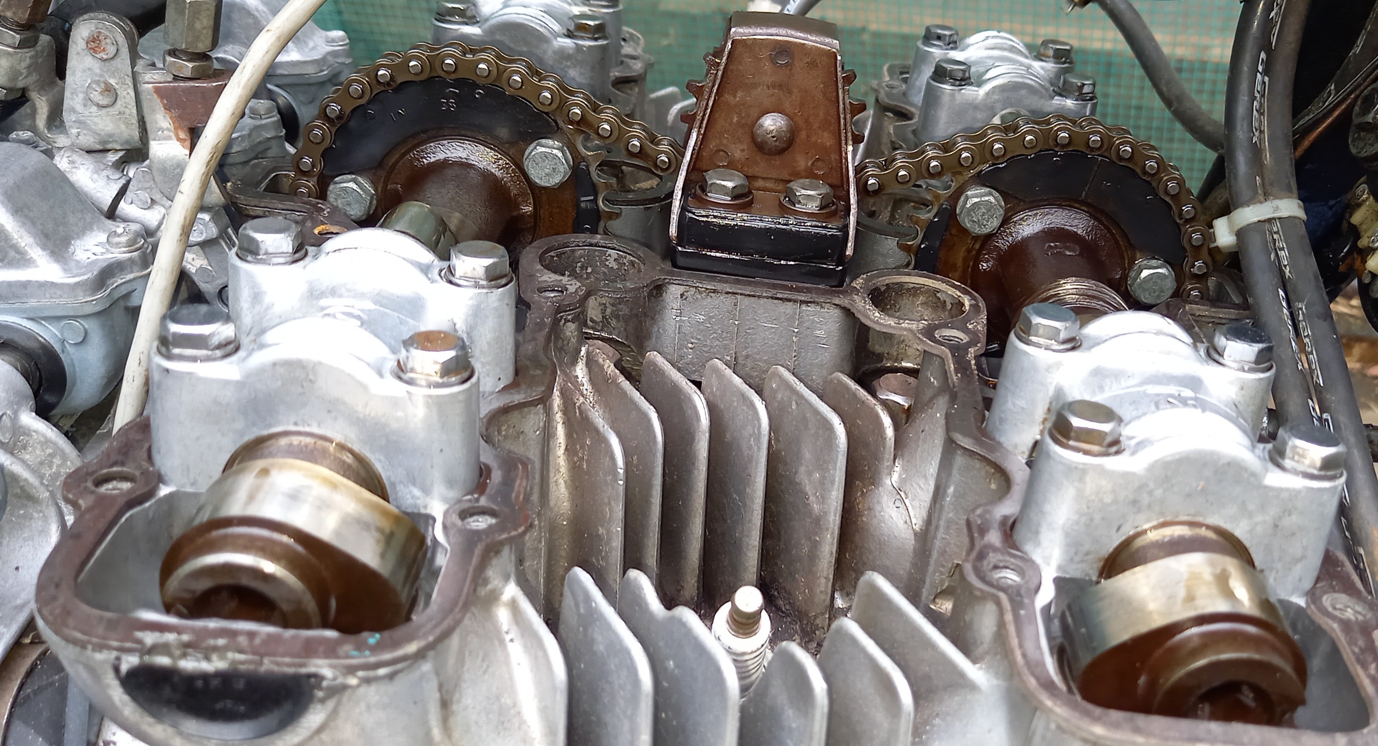

Thanks for all the info guys, I will digest it all.....this Owners Club is far better than any manual!!
I've taken a photo of the cam position on no.4...no1 is obviously the opposite way round.
It seems to be set correctly, I just wanted to make sure it was right as the bike has an unknown history......considering some of the bodges on it!!

warren3200gt wrote:Looks like exhaust not inlet Adrian.ADRIAN H wrote:Picture of the Inlet cam fitted - Arrow on Cam sprocket Horizontal - in line with top of Cylinder head.
Should read Oulet / Exhaust - Having a dyslexic moment. Thanks.

Re: cam timing....
Hi Pete
it seems to me that the timing is correct.
If you want to use the special Kawasaki tool for changing the shims don't forget to remove the gasket from the cylinderhead!
