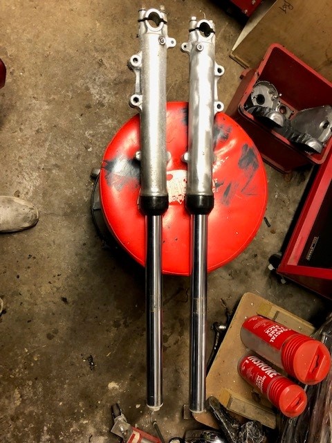

These forks were on a Z1R project bike I picked up. Don't think they are Z1R, can anyone identify them please as i need to sell them. The chrome is good, no pitting, but they need new seals and a brush up!...

If the stanchions are 36mm Rob I think they are z650 b1. Calipers forward mounted with mudguard stay mounts rear mounted.

They could also be Z900-A4 forks as they are also the same 36mm.
Mudguard stay mounts are not used on the A4's.

Thanks Guys, seems z650 is a good bet!

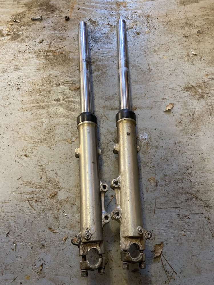

Below is a picture of a pair of Z650 B1 forks on sale on ebay - which to my untrained eye the stay hole looks smaller ! What do you think.

Its not smaller Ade, bit of dodgy pic and camera angle. Trust me I have both.
