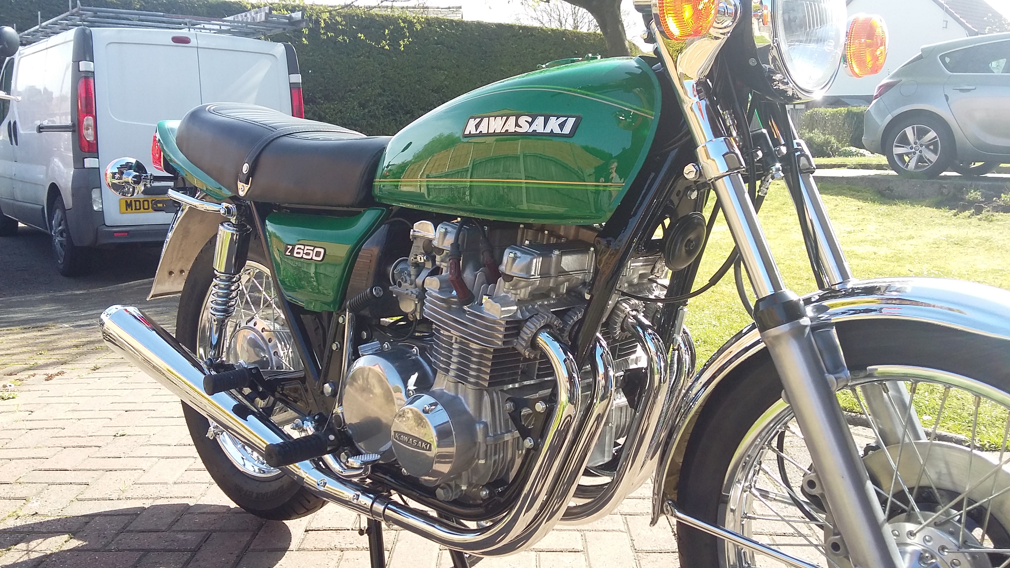

#3 PostAuthor: Ads » Sun Jul 25, 2021 11:49 am
Beautiful bike !! Great work
