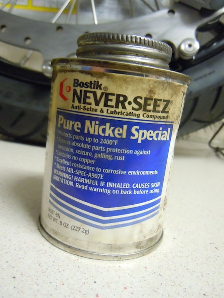

I'd try & avoid drilling it out unless there seems to be no other option. Drilling is more a "last resort" !
The longer you can leave the PlusGas soaking the better, I'd even apply a little heat where the bolt passes through both sides of the engine & the frame, but be careful if you are using a naked flame on the alloy for obvious reasons !! Once you've heated the areas up apply more PlusGas & repeat this a few times.
After a few days soaking undo the nut so it is flush with the end of the bolt & give it a few sharp blows with a descent sized hammer.
When you fit the new bolt put some anti-seize lube on it to prevent future issues, or grease is better than nothing.

Re: Z1000 Front engine mount bolt seized.
Thanks for that, all good advice.
