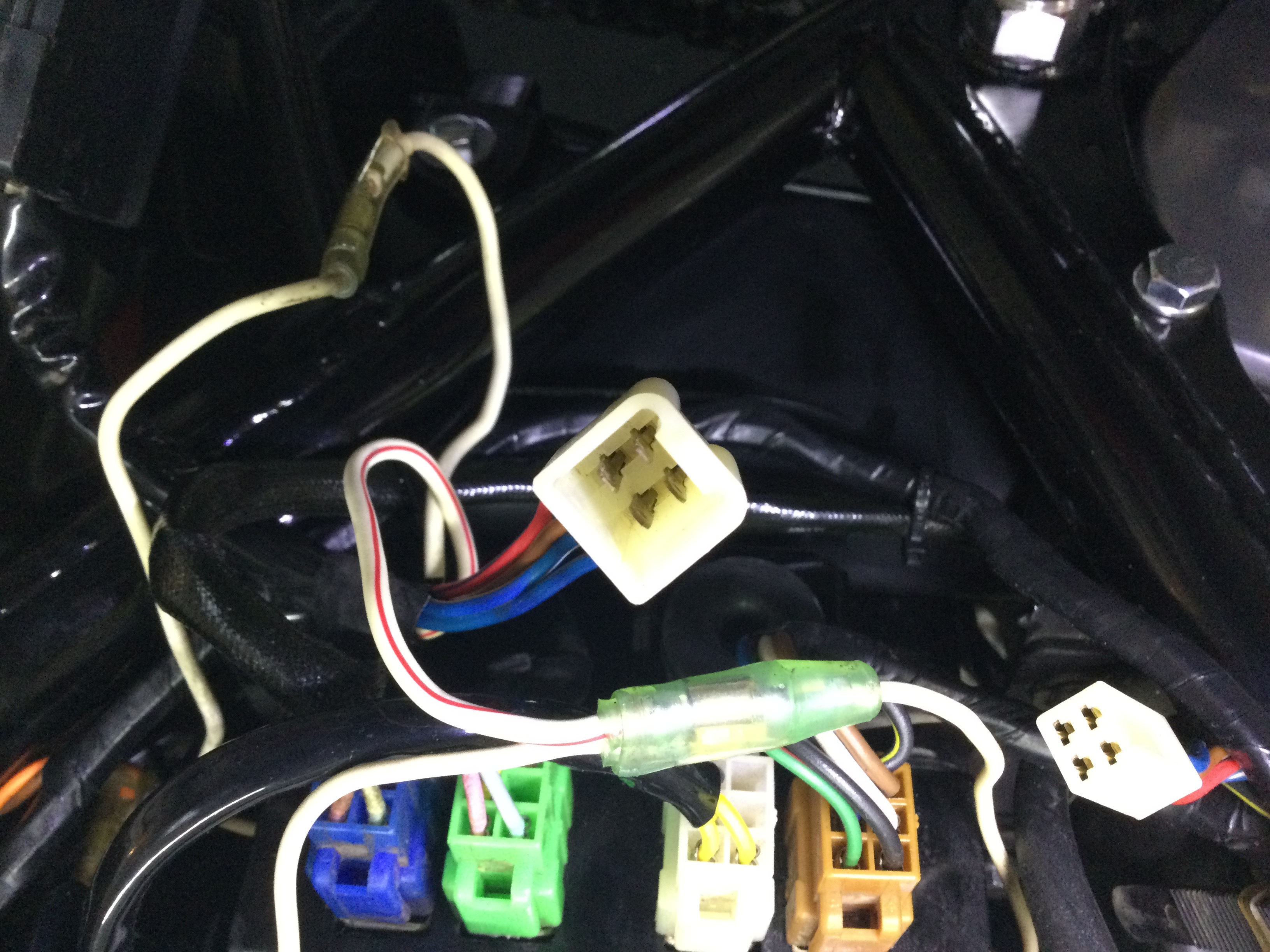

Regarding the removal of the individual cables from a typical multi pin electrical connector.
I had to do this when restoring my Suzuki GT750. If you look inside the body of the connector you can see the spade connectors, each spade has a tiny retaining ‘tang’ which protrudes up from the spade.
If you use a fine jewellers screwdriver (or similar item) you can depress the tang and simply slide the wire out of the connector block.
Refitting each cable is really easy, just slide the cable back into the connector and the tang will click into place again.
Suggest that you take a digital image of the connector block prior to removing any cables just so you can replace them in there correct locations.
I have tried to take an image of the inside of the connector as fitted to my Z1000. It was difficult to focus but I think you can see the small tangs. You may need to zoom in to see things a bit clearer.

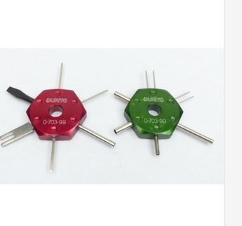

Or you could just get a set of these from Bikerstoolbox remember to let Ralph know your a PUM for a discount :up

KeithZ1R wrote:Or you could just get a set of these from Bikerstoolbox remember to let Ralph know your a PUM for a discount :up
I couldn't find these on the web site.
Can you post a direct link?

KeithZ1R
Posts: 3089
Joined: 15th May 2005
Location: Bury
Re: Terminal type?
#8 PostAuthor: KeithZ1R » Fri Oct 29, 2021 11:56 am
Ah mebe he does not sell them pretty sure he did :?:
You can get them here
https://www.vehiclewiringproducts.co.uk ... h=terminal
