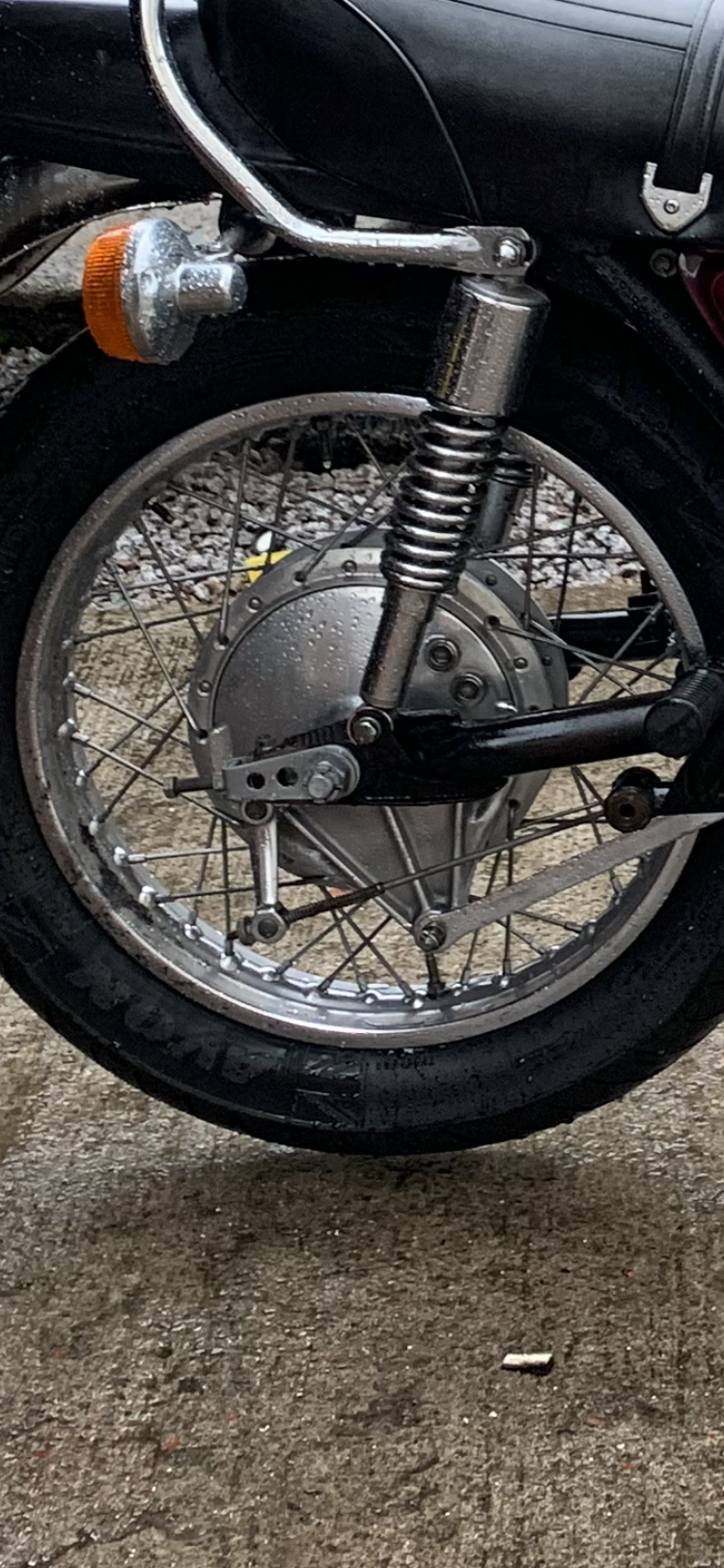

I am looking for some opinions on re chroming wheel rims. I bought a KZ900 which was imported from the US a few years ago and has been stored dry with no rot, and the wheel rims are not bad, there is a few small rust spots and one bit on the rear rim which has about a 1" small patch of corrosion at the right side of the rim .I spoke to my man who has done my chroming on several bikes over the years which I have been very pleased with ( Agbrigg in Leeds) and he said he could chrome the rims no problem, I would rebuild the wheels with Stainless spokes from central wheels which I do myself, so the question is it worth getting the original rims with the date stamps re chromed at £150 per wheel + £80 for spokes or would I be better keeping them original with the few marks and galvanized spokes which are not bad,or what results have other people had with rechroming rims does it keep the date stamps OK.

Before going that route, without pictures they sound totally salvageable. Check out quick glo from https://www.airevalleyclassics.co.uk/ if your not aware of it. You might well be surprised with the results achievable on what at first glance appears to be knackered chrome.

Going down the 'completely original' is great if the rest of the bike is completely original. Personally I'd go rechrome with numbers showing and stainless spokes which are much more durable than the galvanized one's which I've found can lose the coating in a very short time.

I’m not bothered about really original as the bike is a Z900 and it’s getting painted Z1 colours, I done the stainless spokes on my Kettle with the original rims and I done my 400four with stainless rims as well, it was just theses wheels are reasonably OK and weather to justify the cost and if the chrome would remove the date stamps it would also let me get the front hub powder coated black like the Z1 I have attached a picture that shows the water mark.
