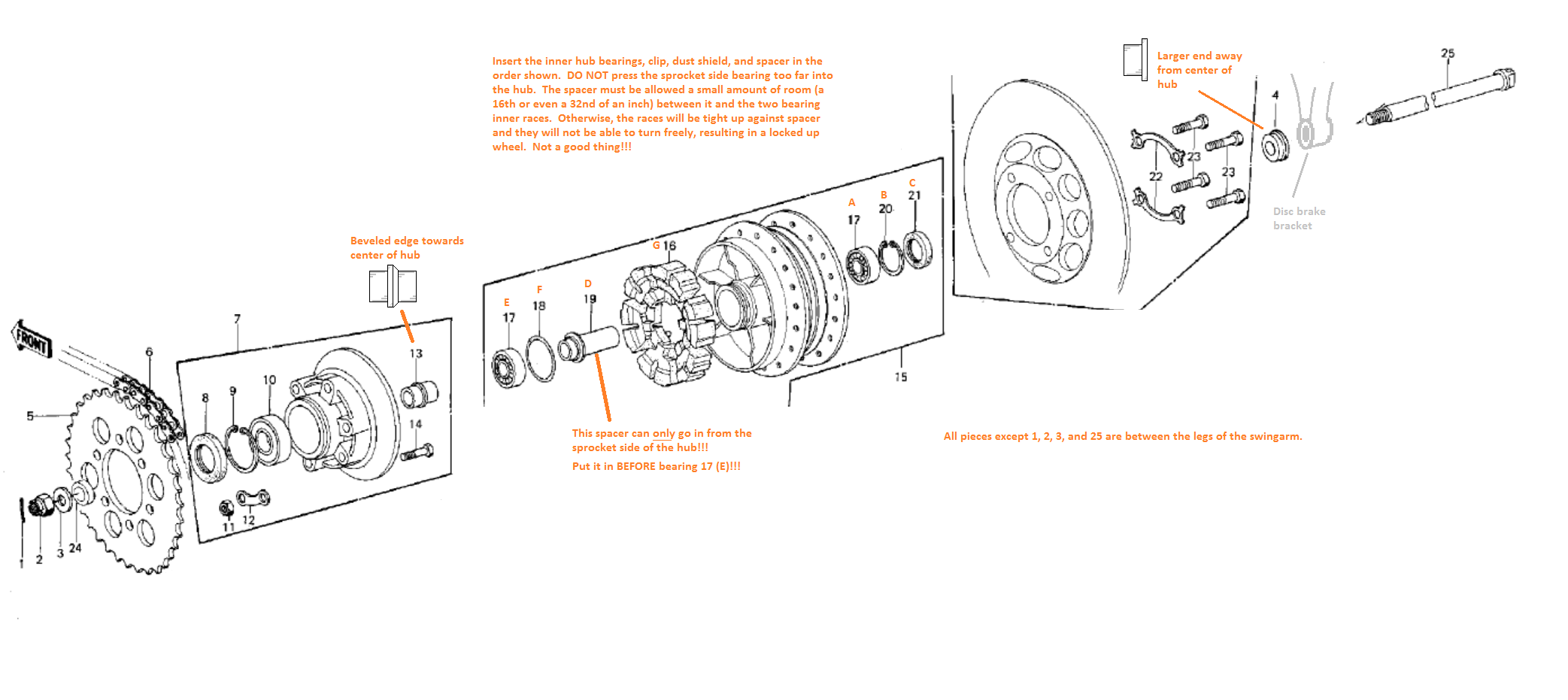

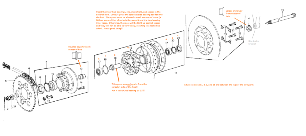

Re: Z1000A1 Wheel spacers. Help, I’m Confused
I found this diagram very useful when reassembling the rear wheel of my Z1000 A1. No part numbers listed, but it clearly shows the various spacers etc.
Hi May,
Thanks for that. It’s a great diagram and it shows the setup just as it should be!
The parts diagram I have shows the top hat spacer on the sprocket side which is incorrect.
Great confirmation.
Thank you.
Great confirmation.
Thank you.
