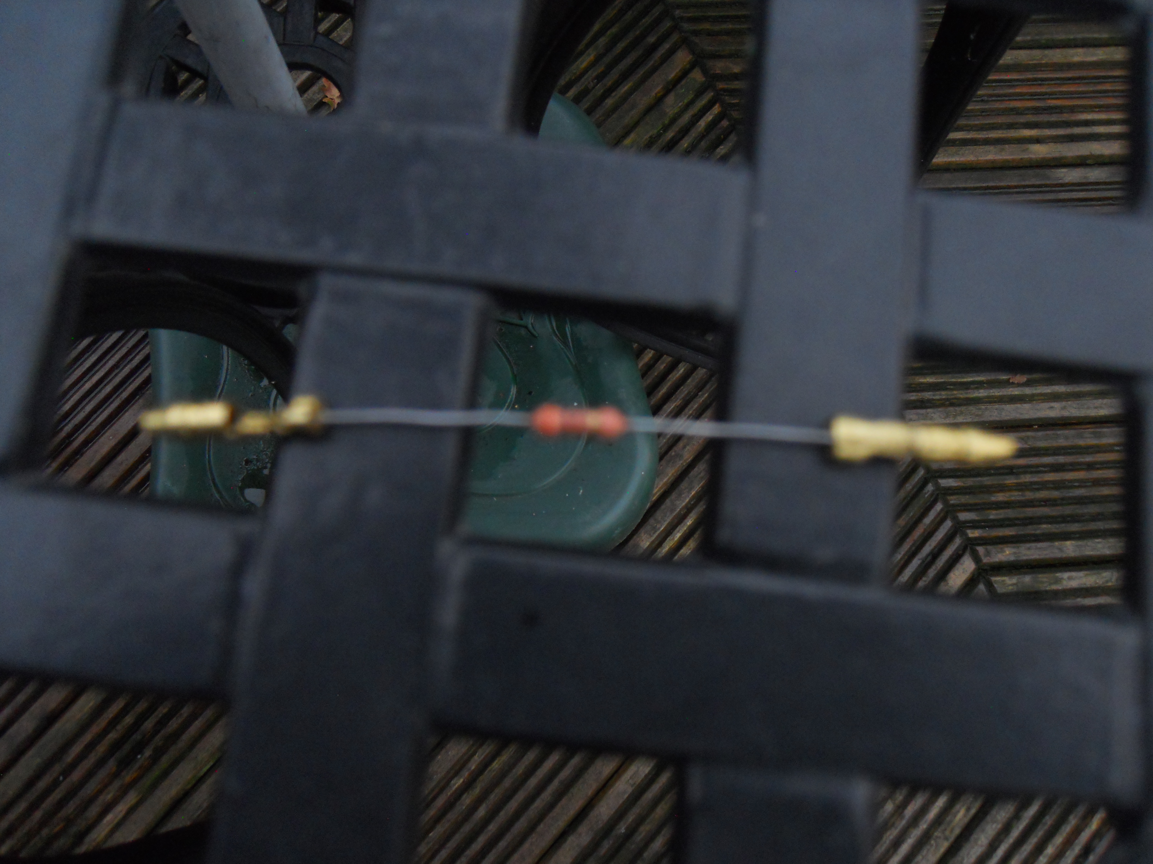

there is a resistor in the grey wire from the ecu its for the engine temp sensor make sure it reads as it should & no corrosion as per workshop manual it is located about 300mm in the harness from the ecu plug
see attached photo

z1bman wrote:there is a resistor in the grey wire from the ecu its for the engine temp sensor
That's great info,never knew about that
