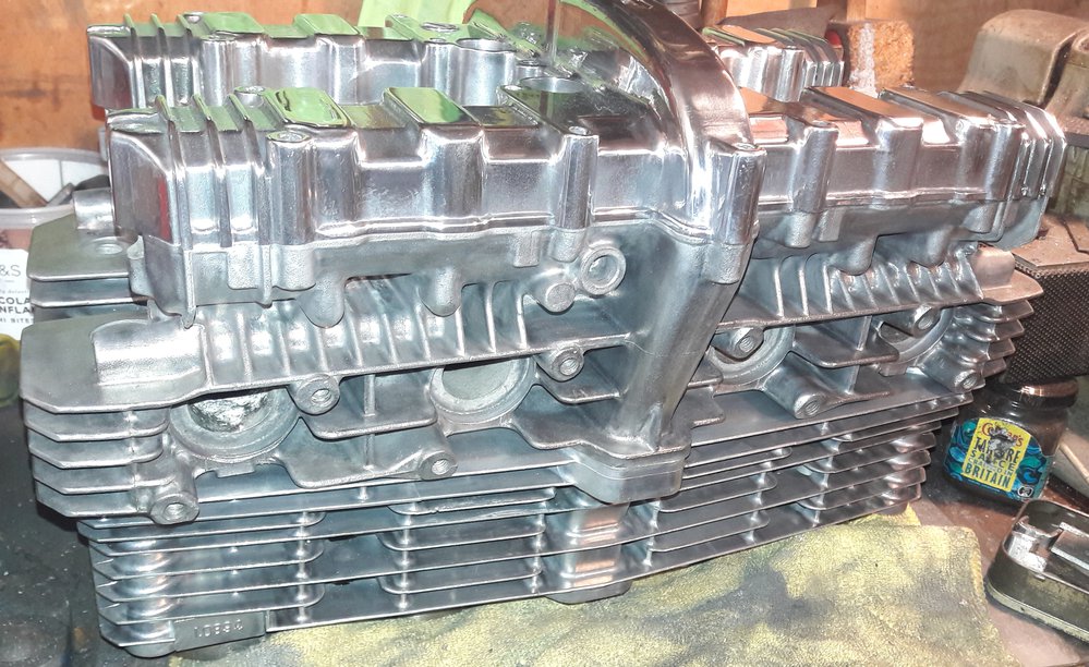

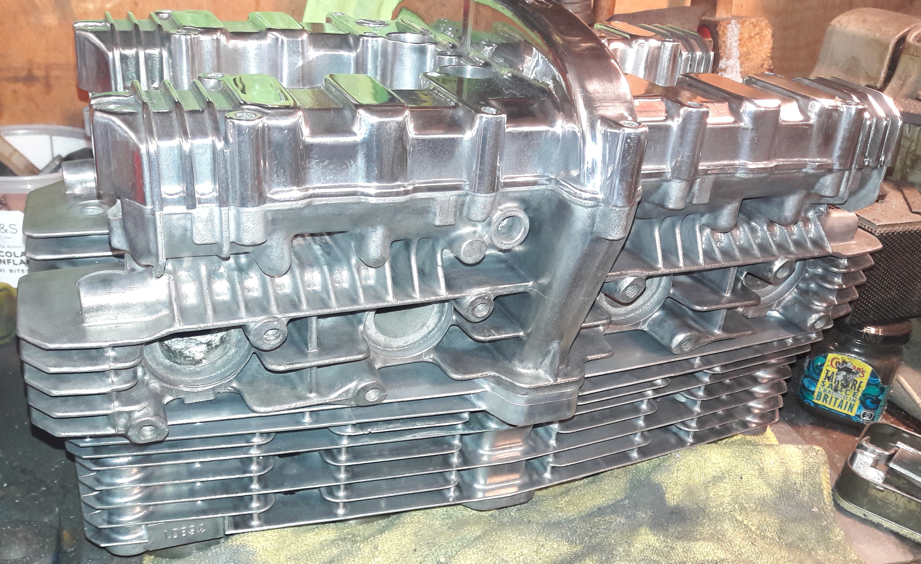

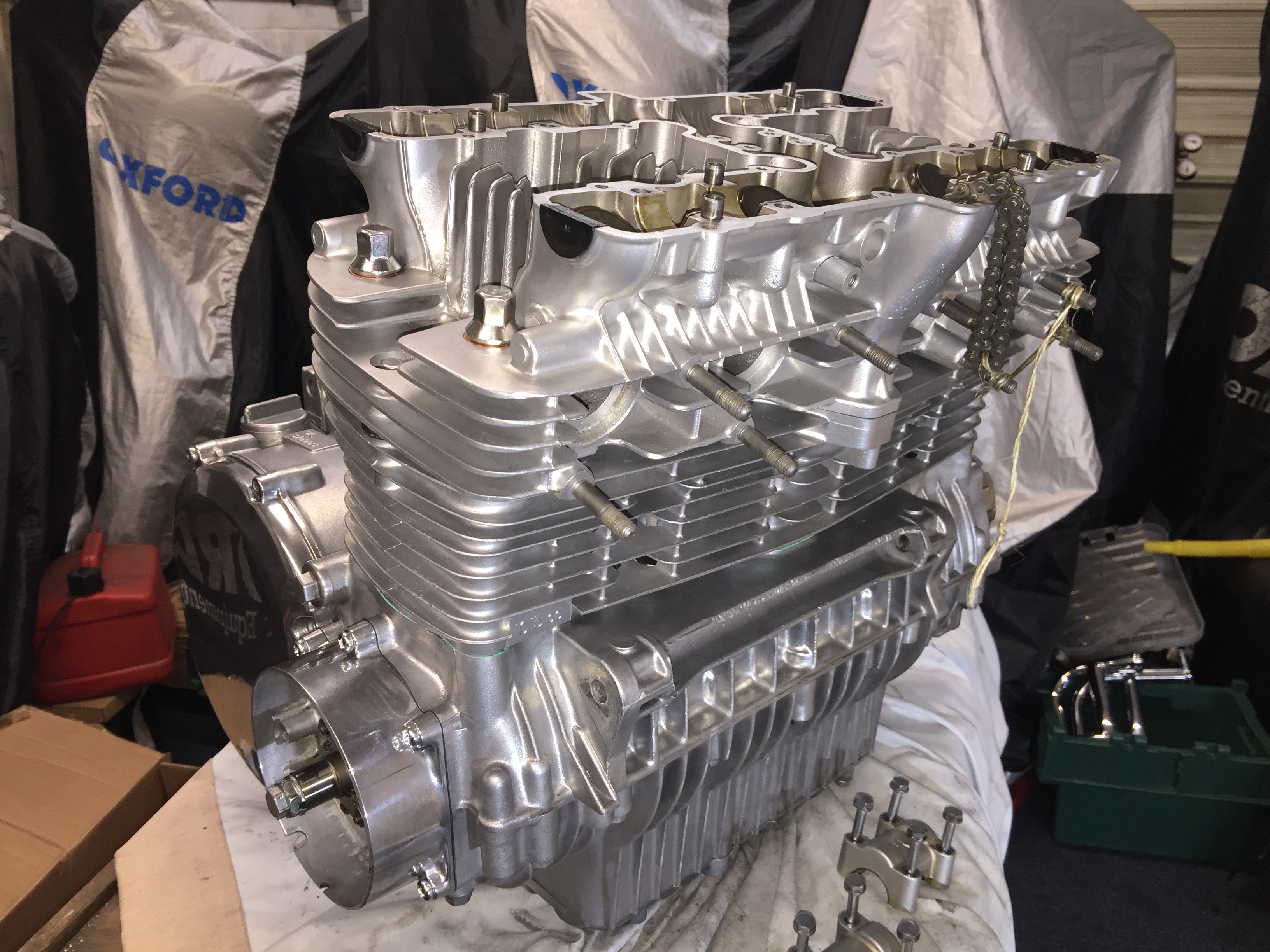

From painted black to this with just time and elbow grease.

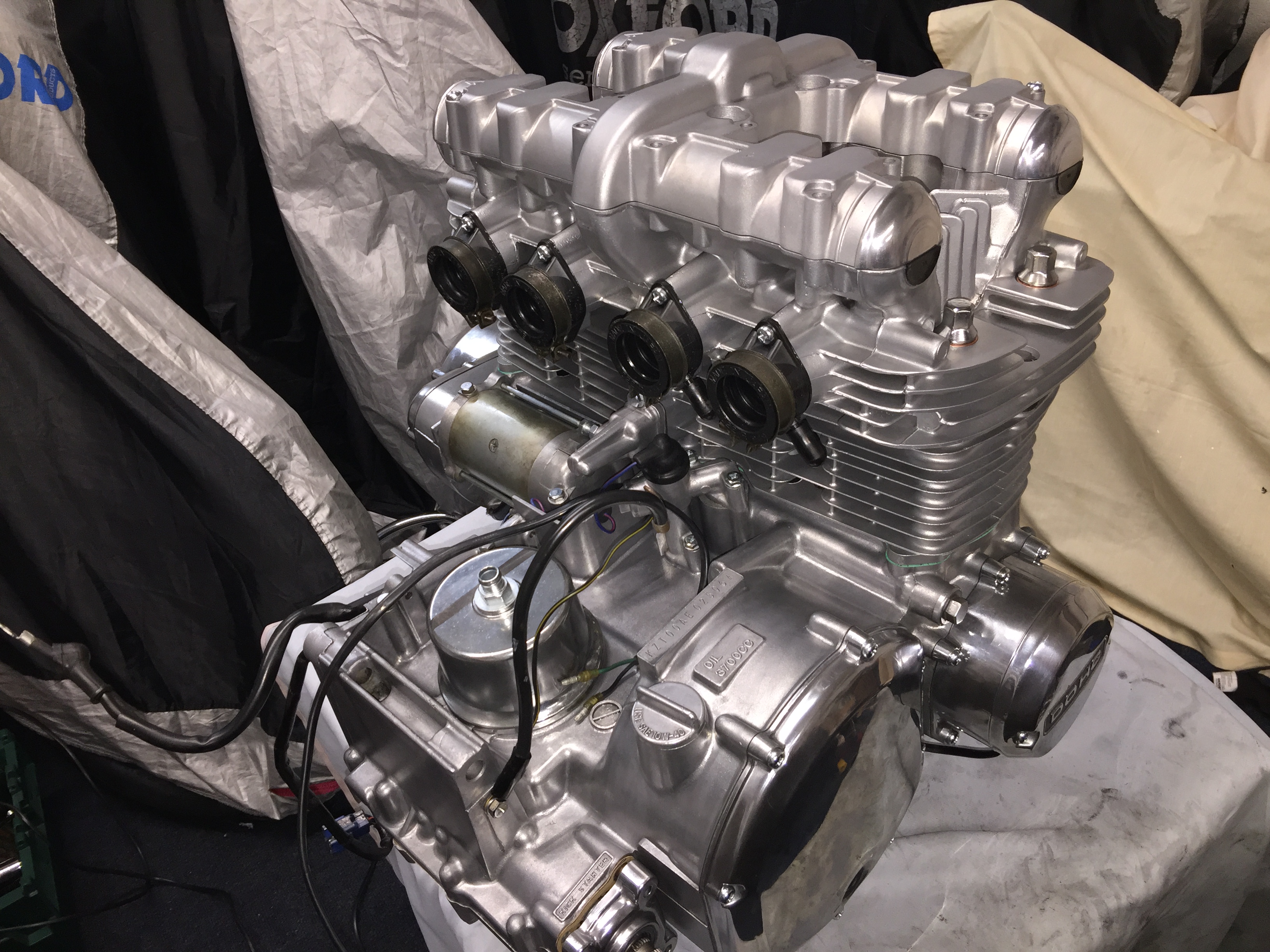

Re: Crankcases appearance
As Philippe says...
It might take as much work to prep the engine properly for Silver paint as it does to polish/clean it by hand.
My old Z1B engine before/after cleaning by hand...

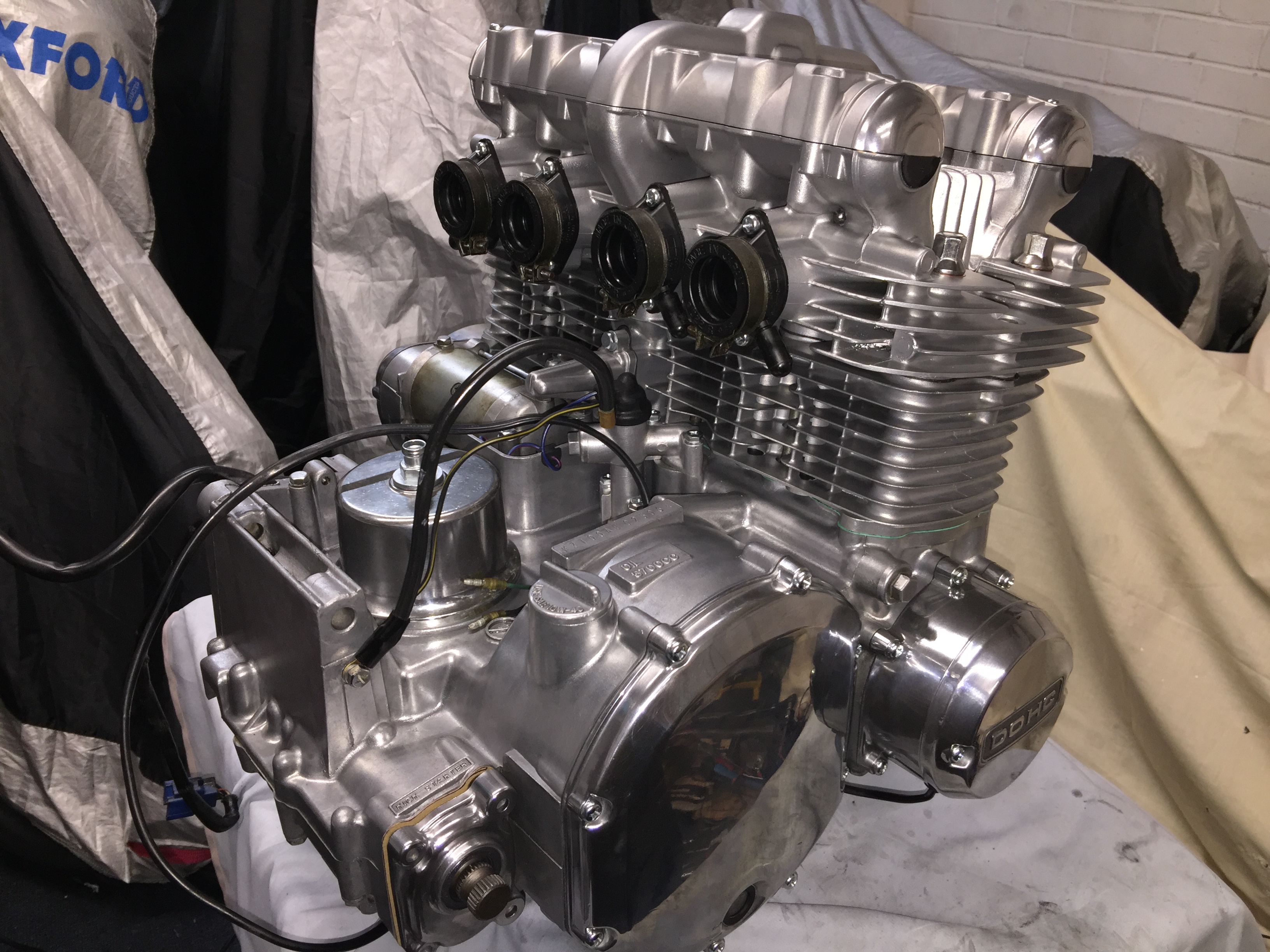

I’ve just done a hybrid of finishes on my A1. Because I didn’t need to split the cases I sorted them with days of cleaning by hand with small wire brushes and dremel as others on her have detailed but I did have the barrels and head vapour blasted.
