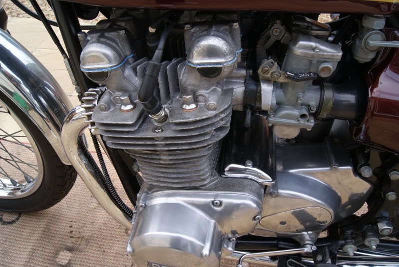

Author: warren3200gt
From painted black to this with just time and elbow grease.

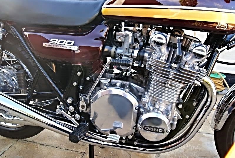

Author: Garry.L
As Philippe says...
It might take as much work to prep the engine properly for Silver paint as it does to polish/clean it by hand.
My old Z1B engine before/after cleaning by hand...
