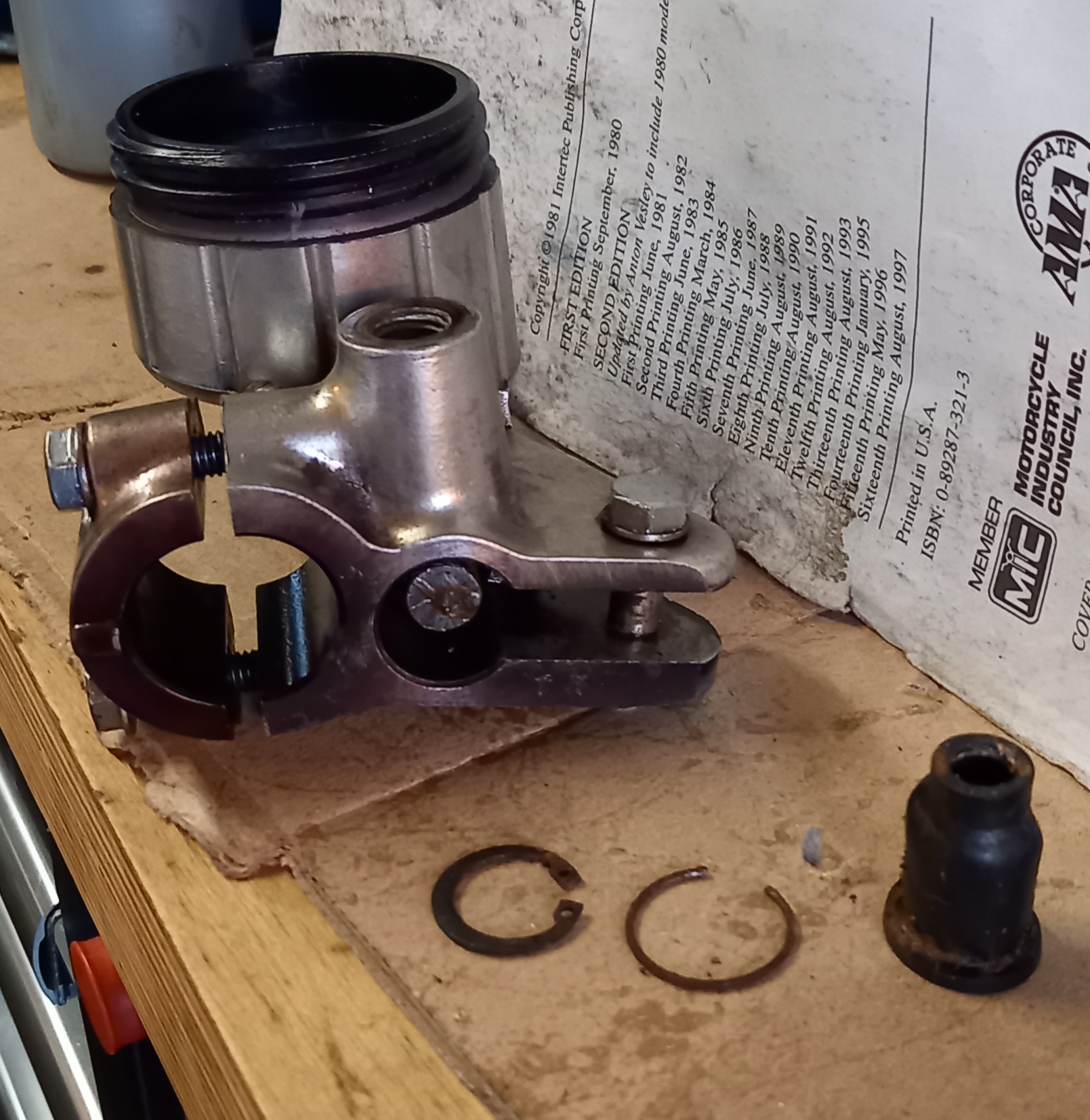

Evening folks,
I'm currently rebuilding the front brake system on the 1976 a4 and I'm having a wee meltdown trying to disassemble the master cylinder.
I've removed the dust seal and the circlip
. However I can't see how to remove the piston and spring. There looks to be a retaining ring around the piston but not sure?
Any hints, tips or photos greatly received.
Thanks again guys!

there is a washer under the cir clip but it shouldn't prevent the piston from being removed. insert a screwdriver in the hole where the banjo bolt fits & tap it out gently

#4 PostAuthor: Peteypops23 » Sun Jan 16, 2022 7:28 pm
:D thank you gents.....
a few gentle taps.......nothing ....
then realised there was a spring to overcome....push, tap, pop...job's a good un...

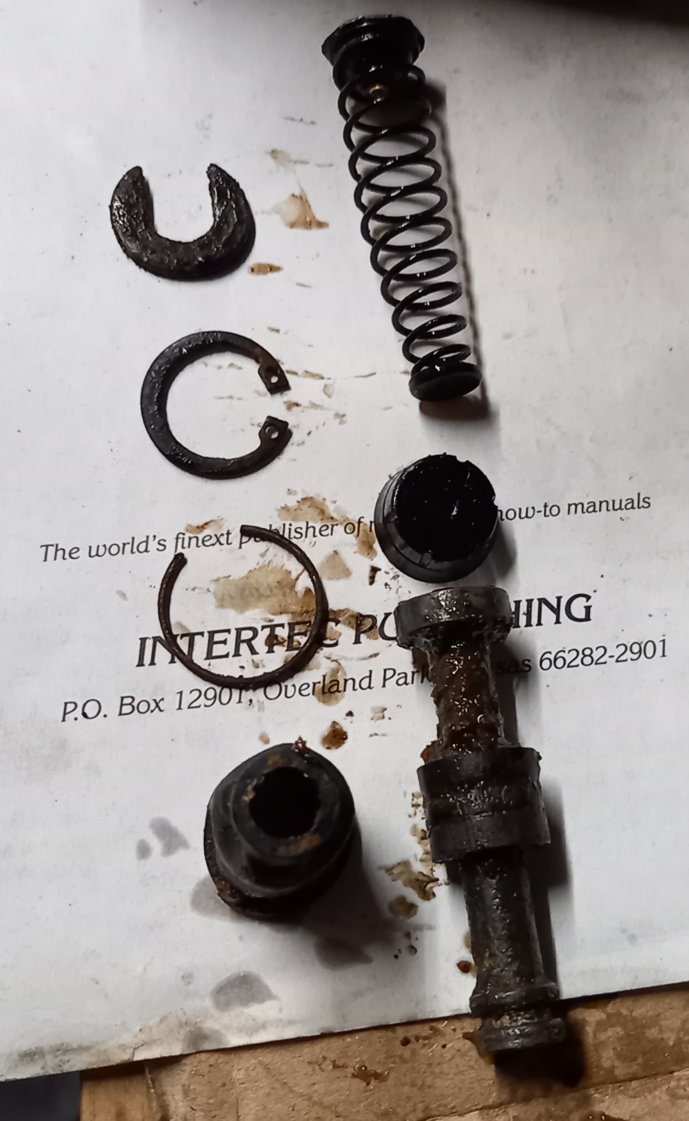

#5 PostAuthor: Philippe » Mon Jan 17, 2022 10:54 am
Hi Pete
it sure looks like it could use some cleaning and replacement, you did a good job and the advice of Z1B man was correct, I do it always like that when the piston doesn't come out by the force of the internal spring.

#6 PostAuthor: Peteypops23 » Mon Jan 17, 2022 11:20 am
Hi Philippe,
yup, this is why I think this Owners Club is the best.
There's always people who will know what to do.
I will be putting the master cylinder in the ultrasonic and ordering the piston kit etc from z power today.
