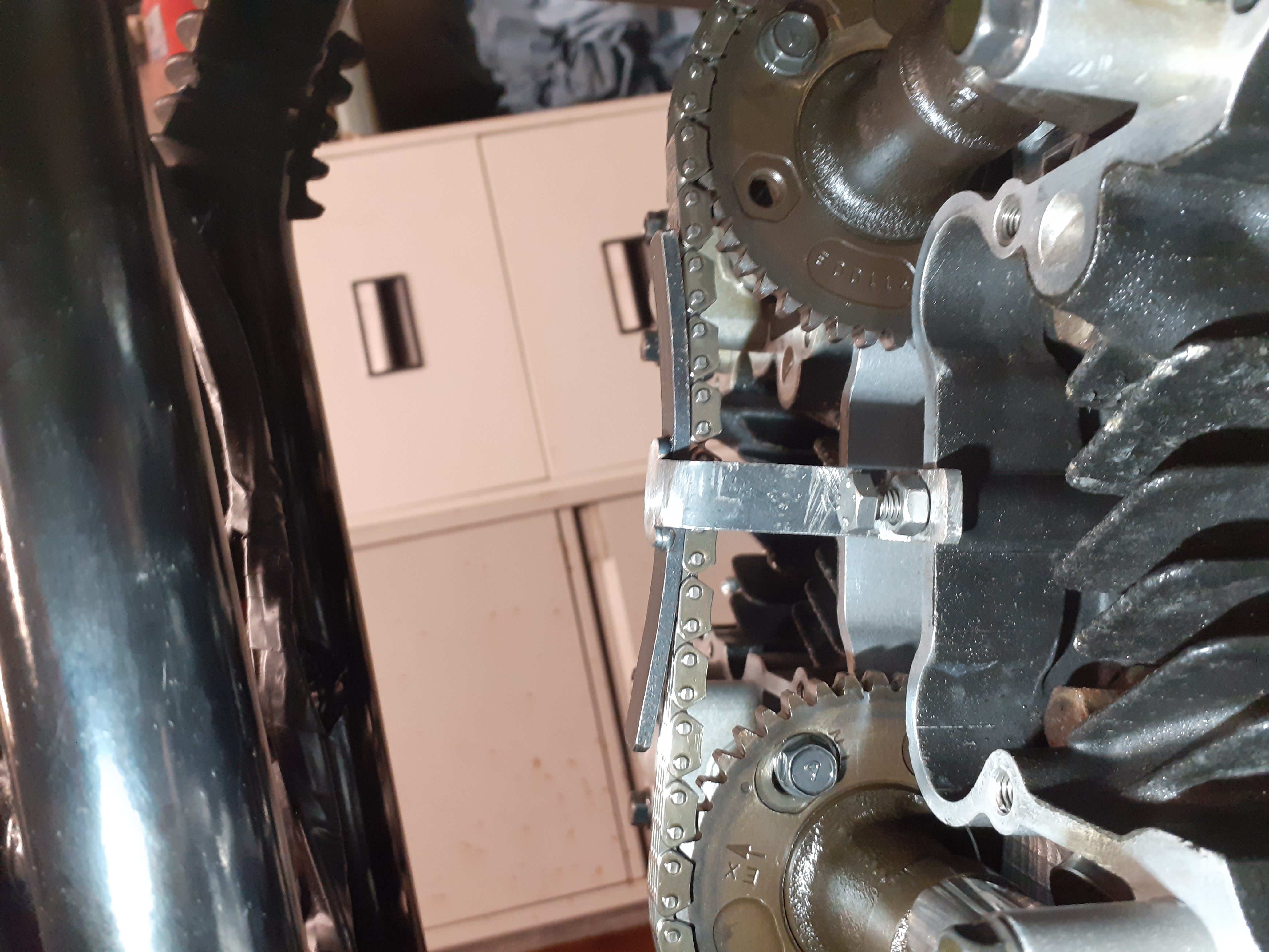

Do you have something which does this job?

#15 PostAuthor: kawagek » Thu Jan 27, 2022 8:07 am
no, i don"t, does this help to set the camtiming correctly?????
