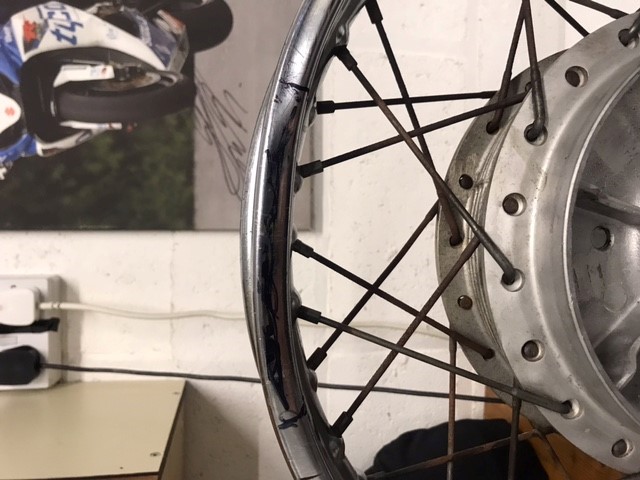

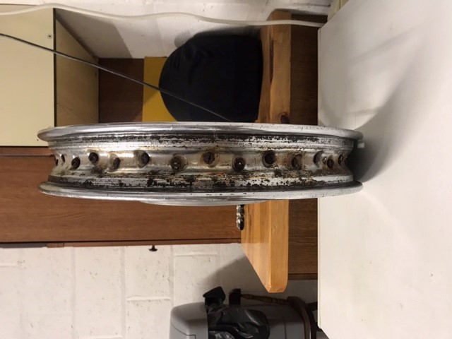

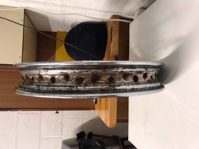

I managed to source a rear wheel with the right date codes for my Z1. I got it from a guy in the states at great cost to me including import duties etc. I recently started work on it only to find that there is a flat section on one side of the rim (absolutely not what I was expecting). See pics
I live in East Yorkshire, my question is does anyone on this site know anybody who can re work the rim back to true for me? Any suggestions / contacts / recommendations would be very much appreciated.
Thank you
John

I had issues with my S2 wheels but not to extent yours has. I ended up with a replacement set from the states also, again £££'s .
Straightening the hollow rim sections is difficult.
This a guy recommended by the Triples forum. Mal :- contact details are 07861 793539 or wildewheels@gmail.com
Alan

I found a company called Maidstone Motoliner. They took it on and did a great job of straightening it out. Cost £66 including courier back to me.
One for anyone else with the same problems.
John

That is great news! Was the chrome still intact after you got it back? Just curious how they did that ..

Apparently the firm had this older chap they employ and he straightened the rim 'old school style' - whatever that means.
To answer your question the chrome was still intact but I had the rim re-chromed because it was going a bit grainy and rusty in places.
