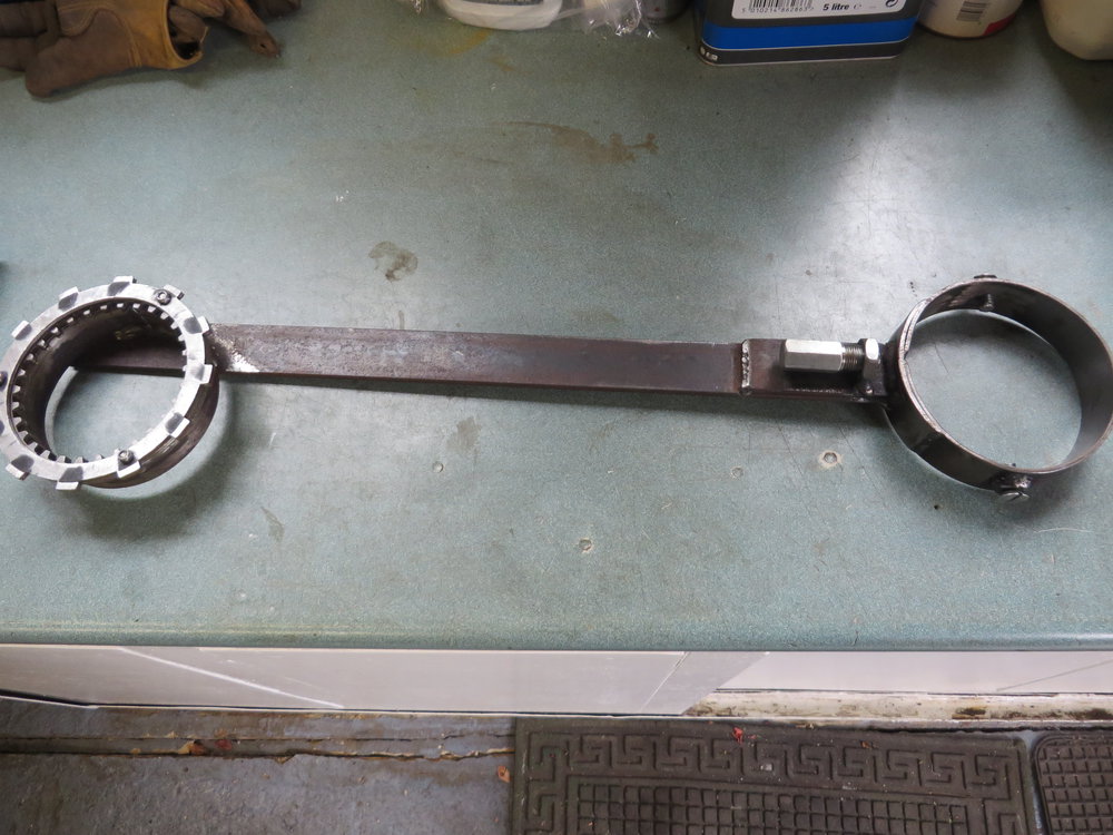

I made one up out of an old adjustable clamp. I took the swivel disc of the screw end and ground the ball down to fit snug in the hole of the rotor without damaging the magnet. Then drilled the flat end and tapped to M8. Ground a bolt and fitted. Works for me.

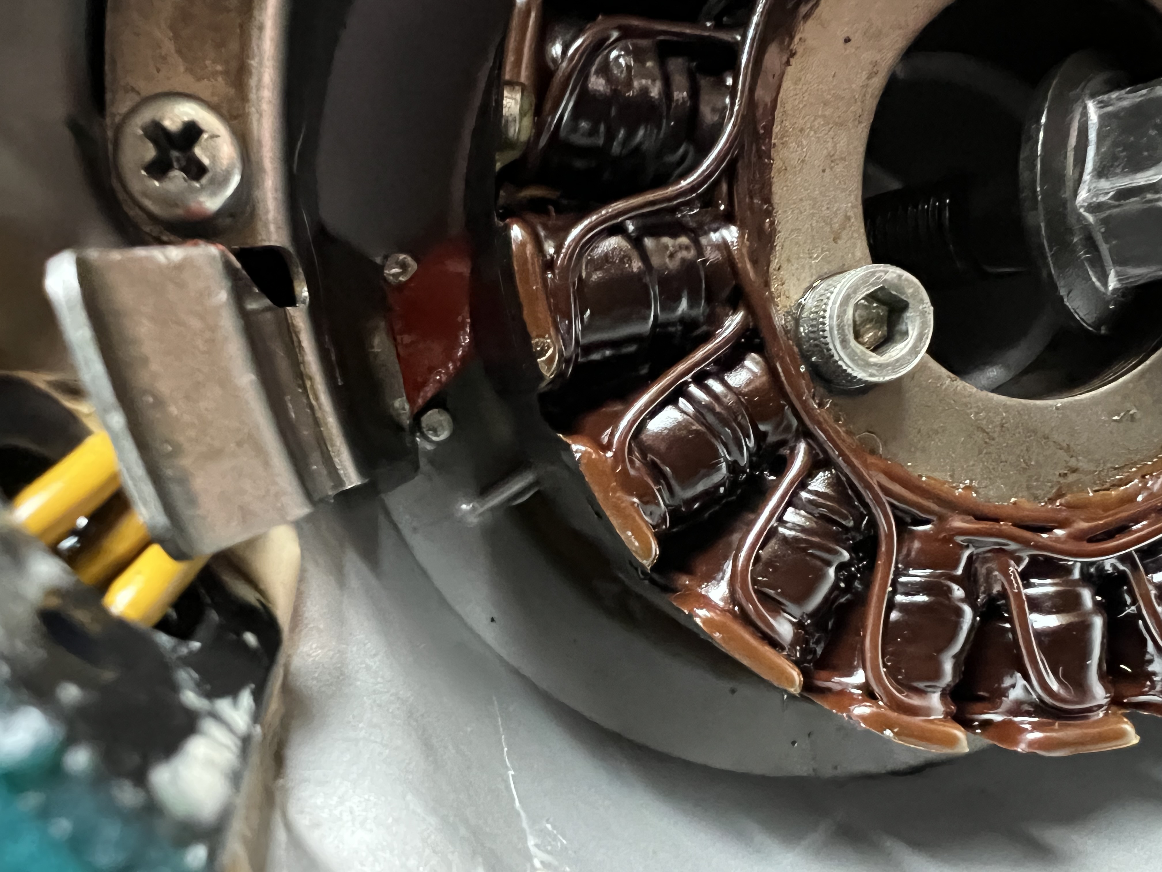

Your suggestion re "the steel wiring protector is not tucked behind the 'cast-in' nipples at its' lower / flappy end!
If this is the case; you will see a thin shiny 'ring' of polishing on the back radiused edge of the rotor drum", was spot on. Though a bugger to make it stay where it should be.
Whilst fannying around with the above, I noticed the stator was loose on all three allen bolts. I cant believe my assembly prowess to be that poor, but it looks like it was. Are these allen bolts meant to have some thread goo applied and is there a torque setting?

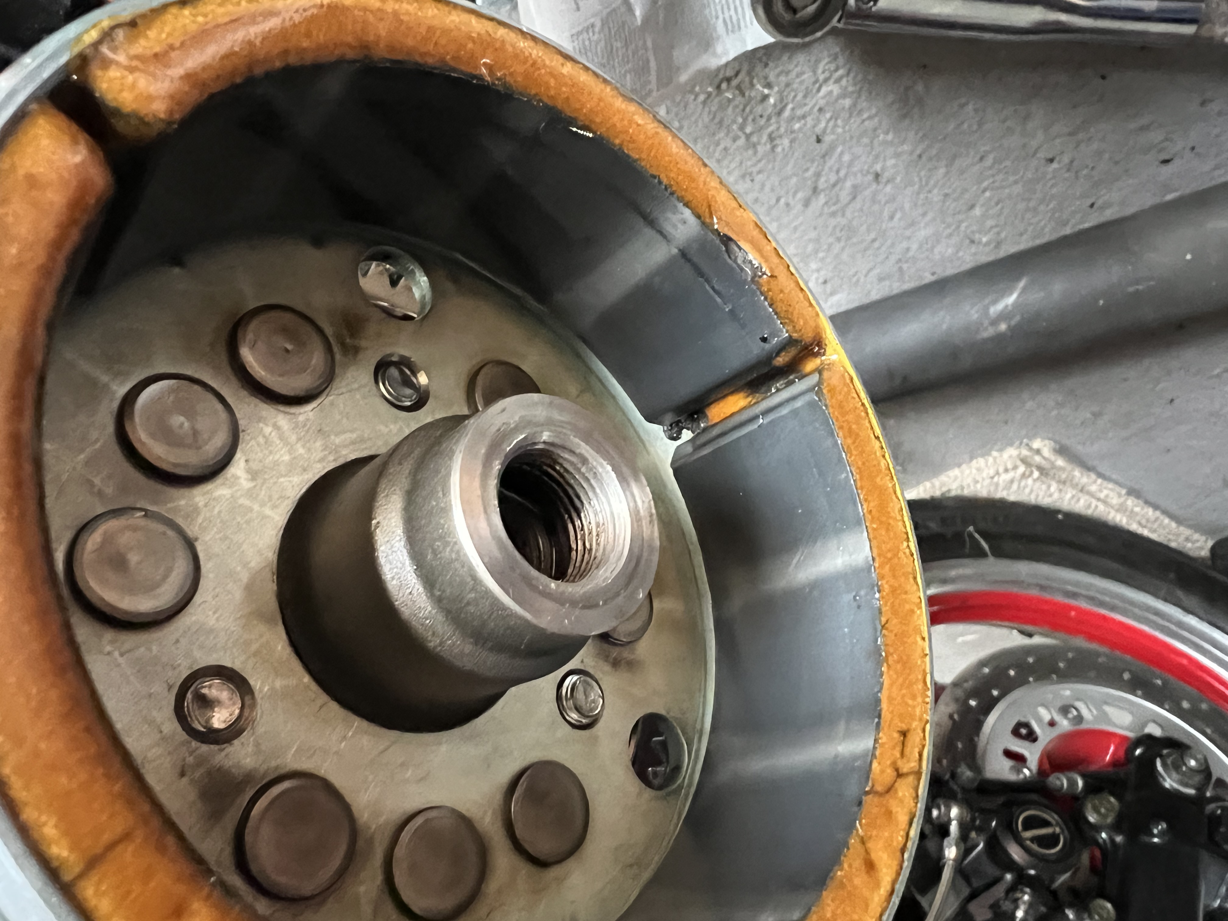

It does look like the wiring protector hit the rotor. It also looks like the stator hit the magnets!
Not that surprising the stator came loose because when they go in they are an impossibly tight fit on the cast boss in the casing and the torqe figure is very low and not getting them seated is most often the norm.
Take out the wiring protector and give it a little bending at the end. You should be able to tell if the starter clutch has loosened because you can get get a pry behind it and give it a small twist to check between rotor and clutch. The three allen screws need non permanent thread locker on there to keep them in place for the clutch, and the stator into the casing.
WRT the rotor; please dont insert the rear wheel spindle into it to remove it. Under no circumstances us anything to slide hammer the rotor off the crank taper. It would be better not to insert something into the thread and tap it. The factory manual specifically says hitting this way will de-magnetise the magnets. If you have a threaded 'extractor' tool,put it in there with a ball bearing or a stud in the crank thread, tighten it and leave it overnight for it to experience temperature changes. You may be lucky and this is the soft option. Put a large cloth in a box under it cos if it comes off it will hit the floor.
I dont recomment this; Put the rotor centre fixing bolt back in, turn until there is just one thread not engaged. Put the outer cover back on and exercise the starter motor a few times. It is the starter motor action and starter clutch which loosens the rotor on the crank! If it comes loose it will be obvious because it will sound like you have blown number one main bearing. (loud rumbling sound)
Stator bolts are 87 inch pounds. in/lbs which is approx equal to 7 ft/lbs
Starter clutch onto the rotor screws are 29 Foot pounds ft/lbs
It does look like the starter clutch screws have come loose. You will still need to be able to hold the rotor when tightening them.
This was my solution.

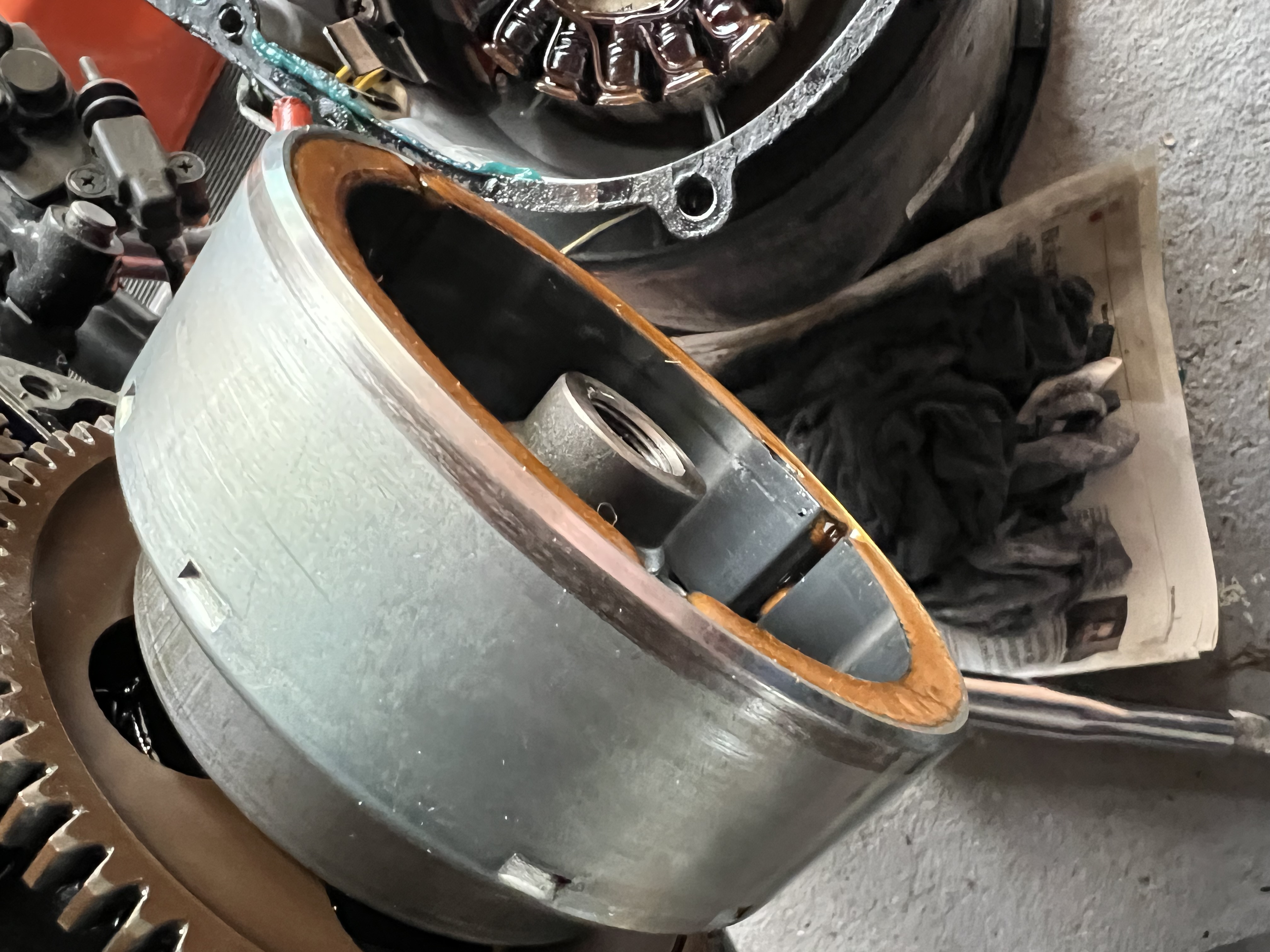

Heat; the amount you may need runs the risk of softening the resin holding the magnets and there is a soft rubber damper immediately behind the rotor which could also get damaged!
I was looking at a score mark on the inside of the magnet in the picture. To get the stator seated you can press it very firmly and confirm with a soft drift to ensure its home before bolting it up. It is very tight but in that; the design is self aligning. If it has had contact it will be seen as the laminations pulling apart or scuff marks on the shiny outer surface or overheating marks like melted insulation on some segments of the stator or 'blueing'.
If there are score marks you could dress them out as there is no penalty, it not being permanently magnetised like the rotor. It would be obvious if you address the other issues and still have a grinding noise when its running again.
When i had a rotor, i used masking tape, gravity and araldite to fill the gaps between the magnets. May not help but it made me feel better.
