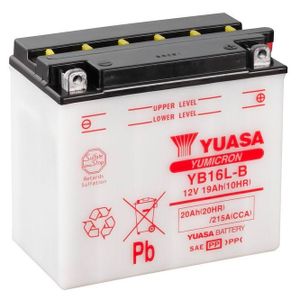

Hi folks just a quick question, what is the battery code for a gpz1100 B1 as my local kawasaki dealer can't find a up to date code to order me 1 in, it has to be for the gpz1100 B1 1981 model with fuel injection as the airflow meter sits above the battery so has to be a certain height so I've been advised by the guy at the dealership, or even better could someone with a B1 post a picture of the battery so I can show him :D thanks in advance. Lee

#3 PostAuthor: z1bman » Wed Mar 02, 2022 1:29 pm
yuasa YB16L-B
Capacity Ah (10-HR) 19
Capacity Ah (20-HR) 20
Weight with acid (kg) 6.3
Acid volume (litre) 1.2
Charge current (Amps) 1.9
Terminal Type 6
Length (mm) 175
Width (mm) 100
Height (mm) 155
