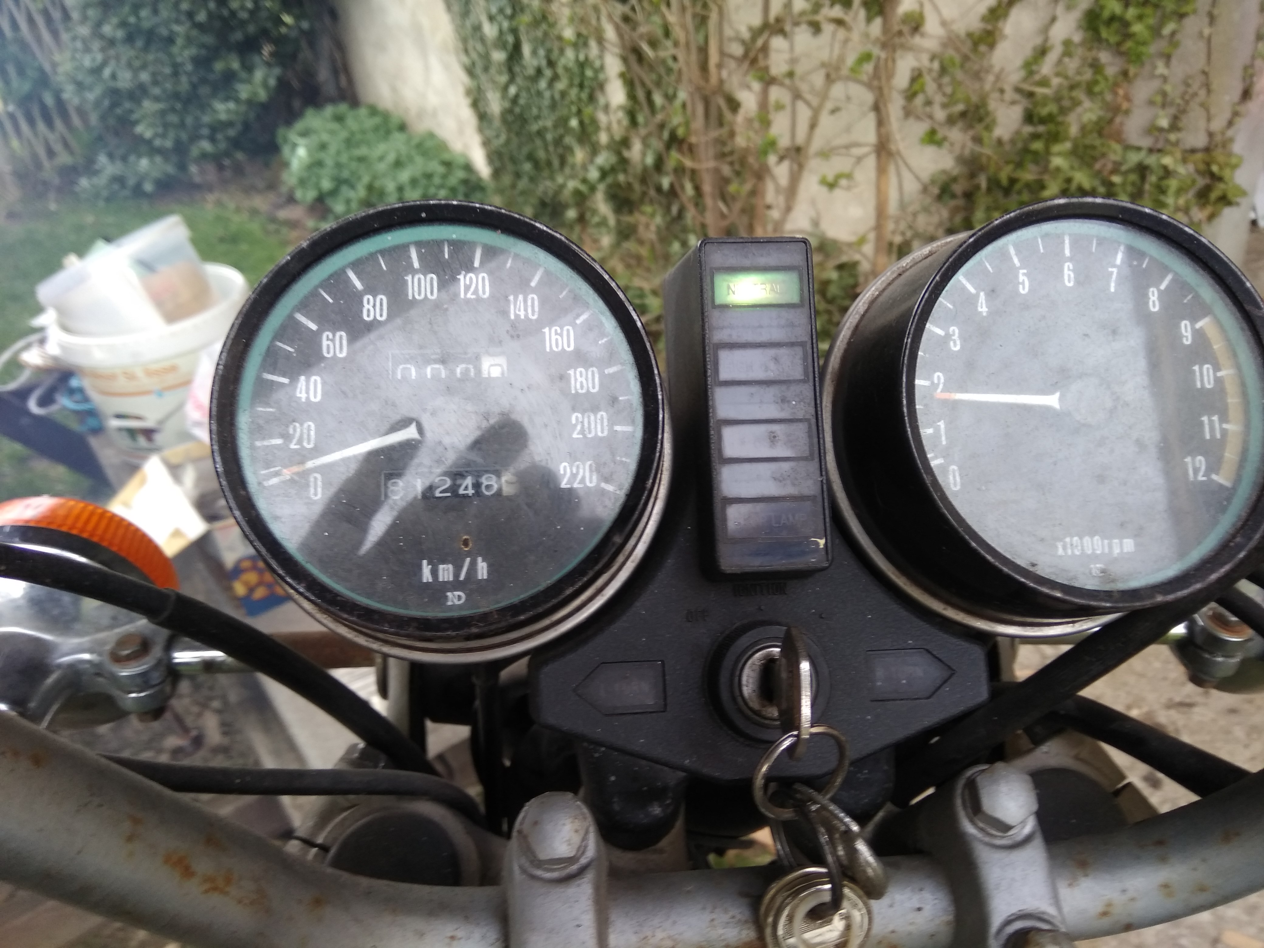

Gents, my newly acquired Z650 has no spark. It's an F1. Points look recent. I haven't played with points for years. Could someone put up a list of tests that I can work through to find the issue please?

I am making an assumption that you spinning it with the starter ? if so take out the plugs and try "flicking " the points open with a screwdriver whilst watching them, this is because the drain on the battery may be taking the voltage to below the 10 volts necessary to trigger the coils to produce a visible spark , secondly have you actually got 12 volts to the feed side of the coils, this can be interupted by the kill switch on the bars . other opinions will along shortly .

Keith, I was spinning it with the starter but the terminals were connected to a car battery and spun it very well, I'll check for 12v at the coils.
Where, regarding the points and condenser, do I check? My first couple of bikes and my first car had points and I knew it inside out but that donkeys years ago.

I was under the impression if you started a topic you were subscribed by default, but I will check , didnt the F1 have hall effect cdi ignition and CV carbs, you may have a late C/D engine in it.
A simple way to check the coils is remove the green and black trigger wire from each set of points in turn and flick them to an earth point and watch for the spark at the plug, or clean the points facing up with glass paper and perform a similar action with the screwdriver across the gap, the condensor would need to be a dead short to ground to stop you creating a spark manually because the coil would be in effect powered all the time stopping the field collapse induced spark and would would need to be replaced, are you just assuming you have no spark just because it dont fire ? just asking

Thanks Keith, I'll get the checks done later.
When it didn't even try to to fire I whipped no 1 and 4 plugs out to see if it was fuel or spark, twas lack of spark.

Warren, they are kwak, just been through the bag off bits, this boy bought genuine, though I may have an issue with one condenser. Checked the 12v feed to the coils, crap, cleaned with contact cleaner, all good. One dead plug, all others coked. Checked the condensers, 1 showed 12v the other 9.5, also the 9.5 one, or rather the points for it, when I opened them the coil clicked, so guessing that's buggered.
No silly noises, ticked over nicely, Batfink lives.
