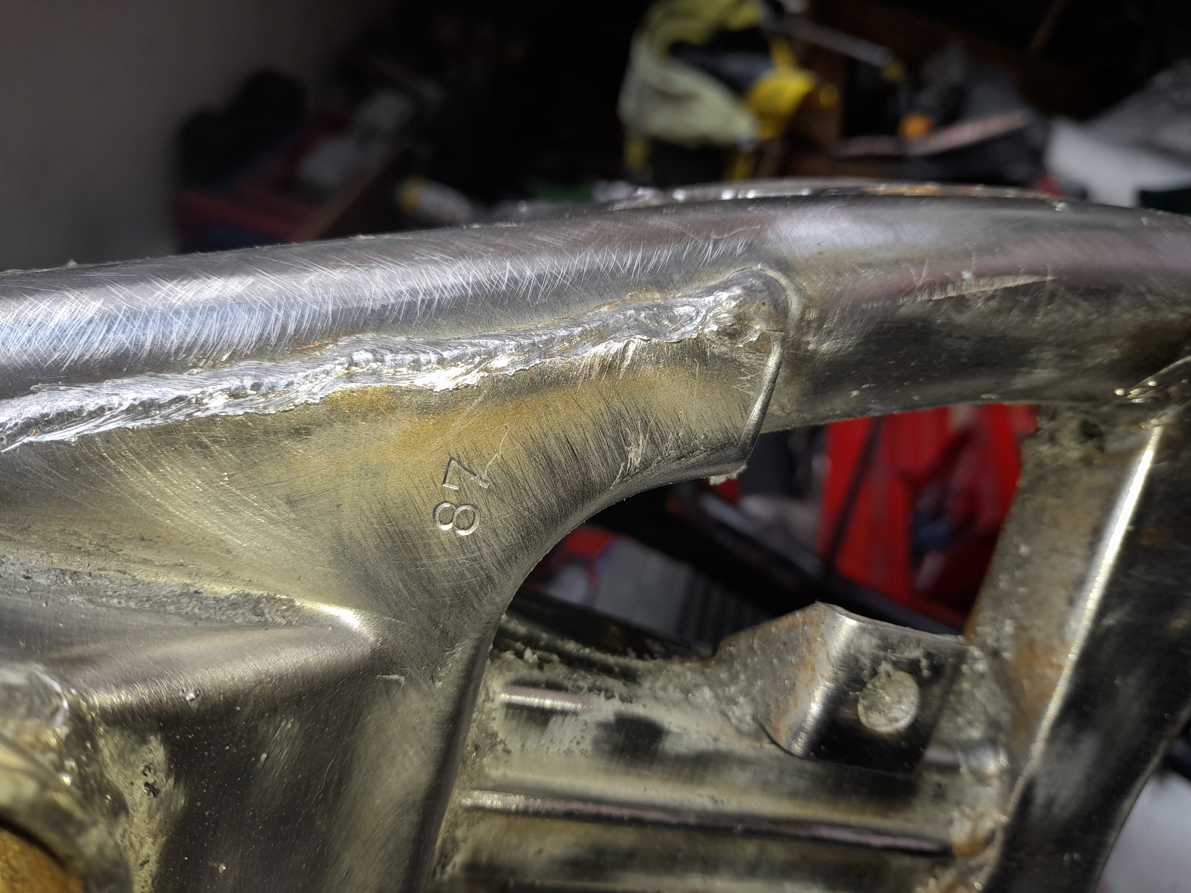

Stripping the paint from J2 frame. There's no frame number on the headstock only madeinjapankhi stamped vertically but it does have 87 stamped on the top cradle cross brace.
Only stripped the head stock so far so am I going to find the frame number else where?

Could be a replacement frame.

Kinda guessed that Gus from the lack of frame number, I was more intrigued by the 87 stamp. Maybe I've got number 87 out of 100 limited edition little known super special worth a fortune race special :lol:
Or maybe year of re frame?

Nearly, quite a few of the brackets have numbers stamped on them. They're for location and orientation (number faces outward) for a sort of welding by numbers approach to assembly by anyone who can point and shoot a MIG welder..

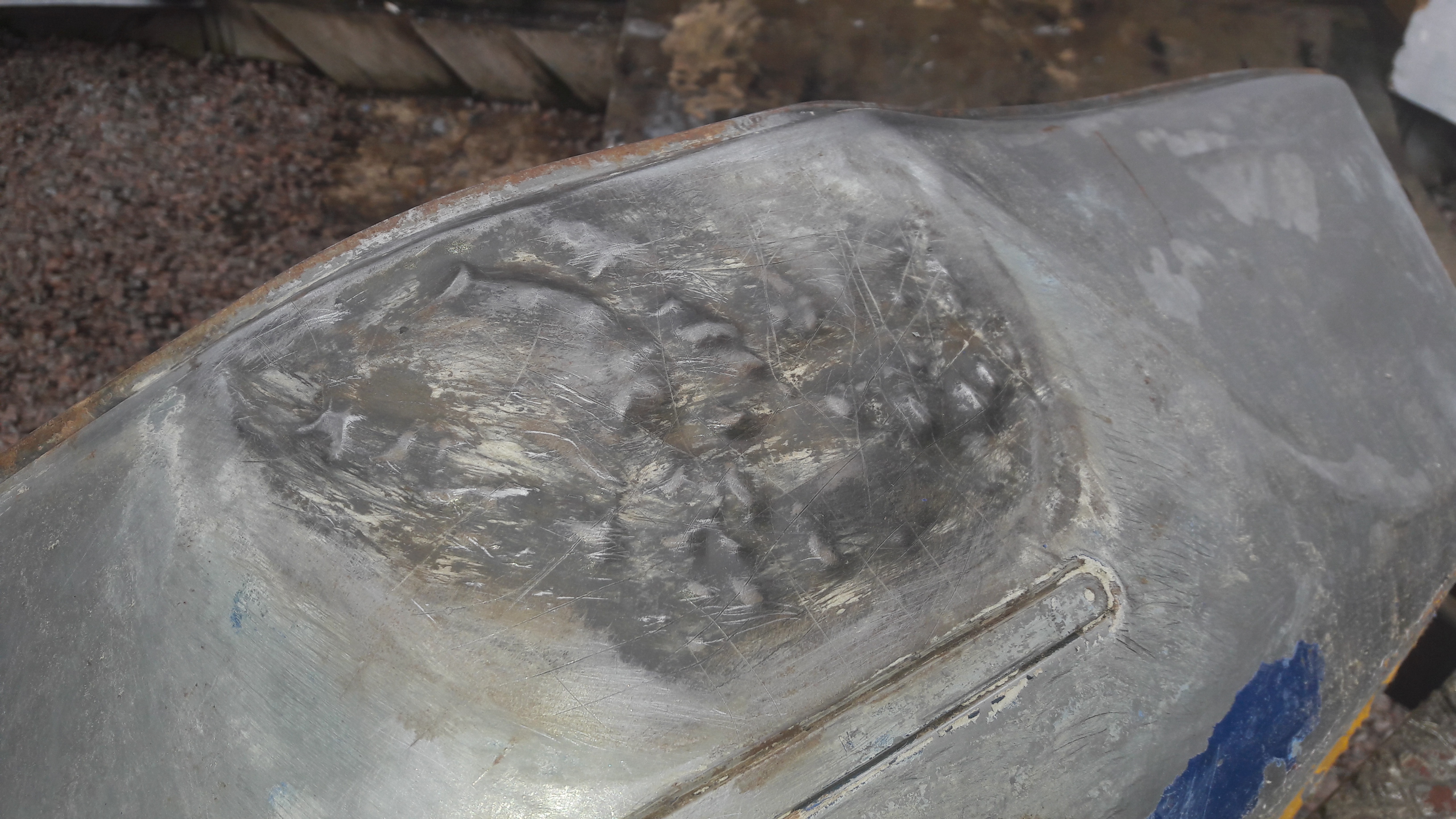

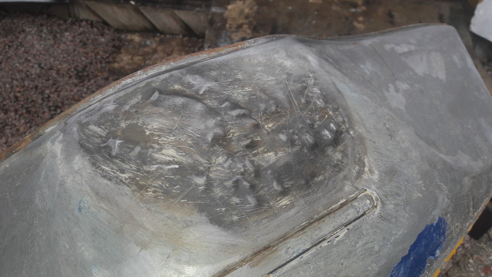

I'll have a look at the swinger tomorrow as the tank had some badly repaired dents in it on the right hand side.

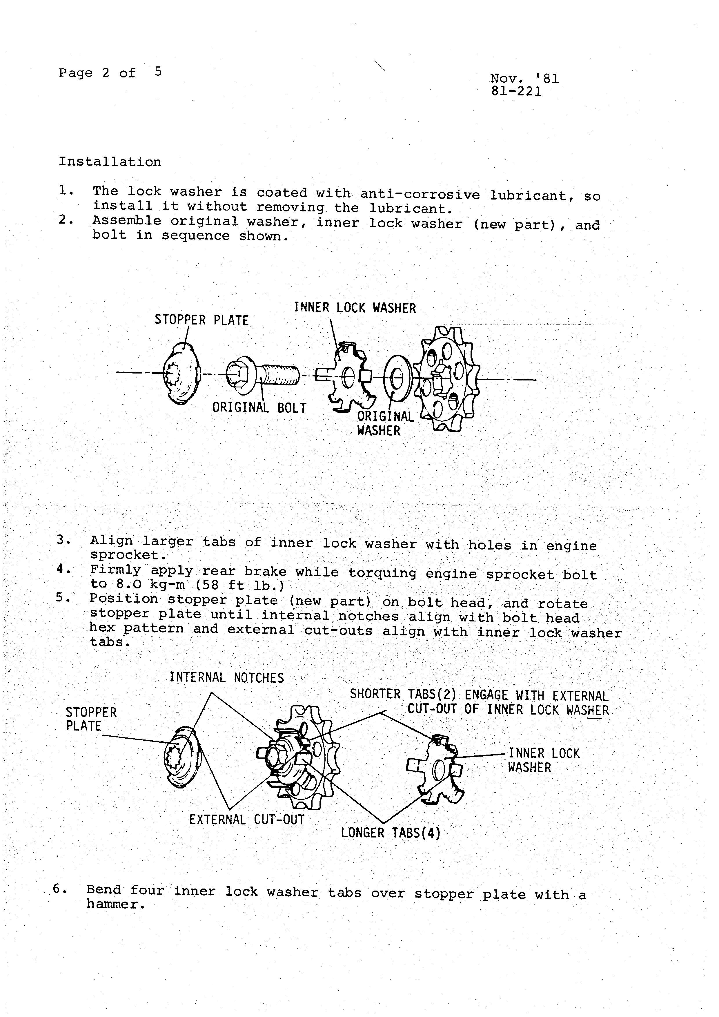

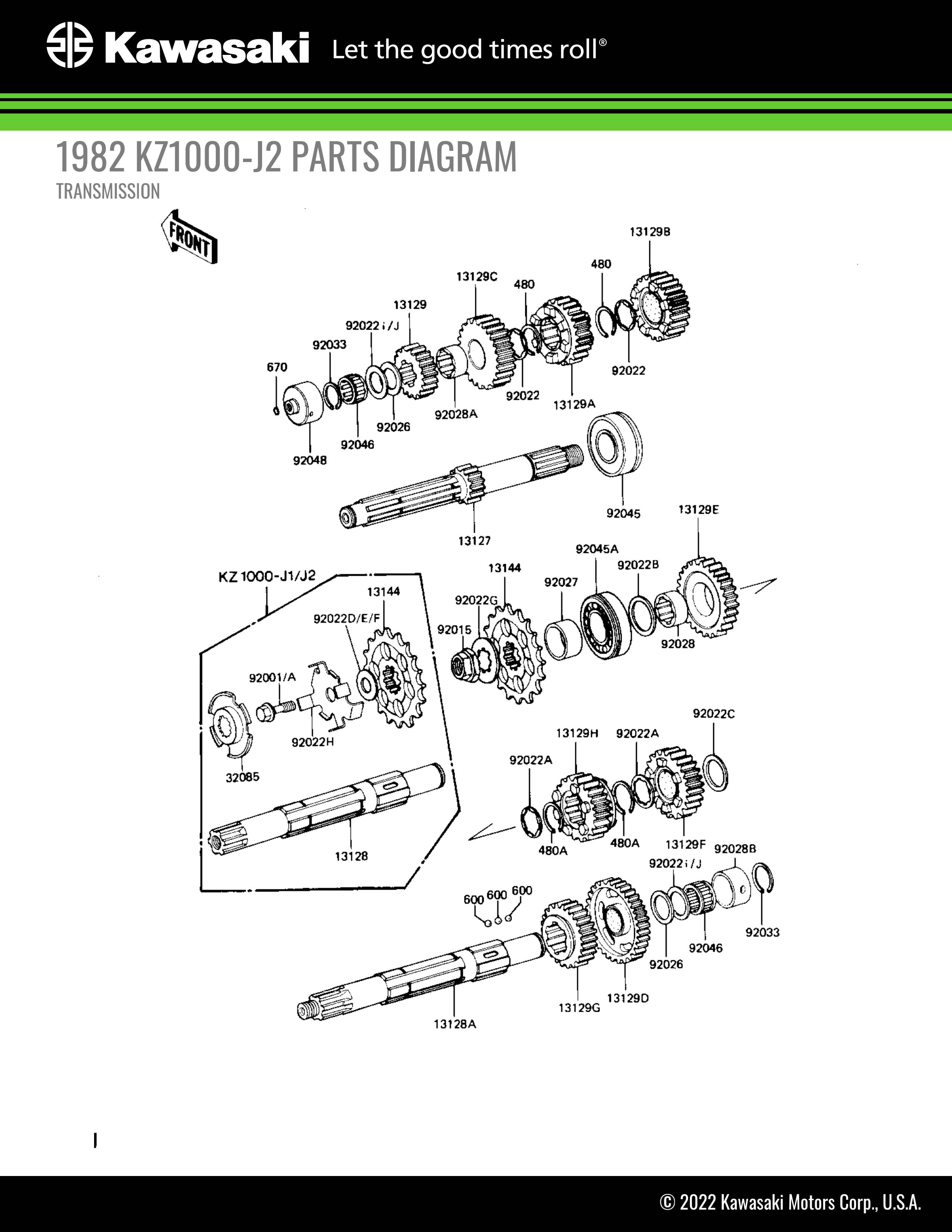

7. Weld the sprocket on the shaft. :up
Seriously though, what's the fix? Just remove the washer and then re torque the bolt?

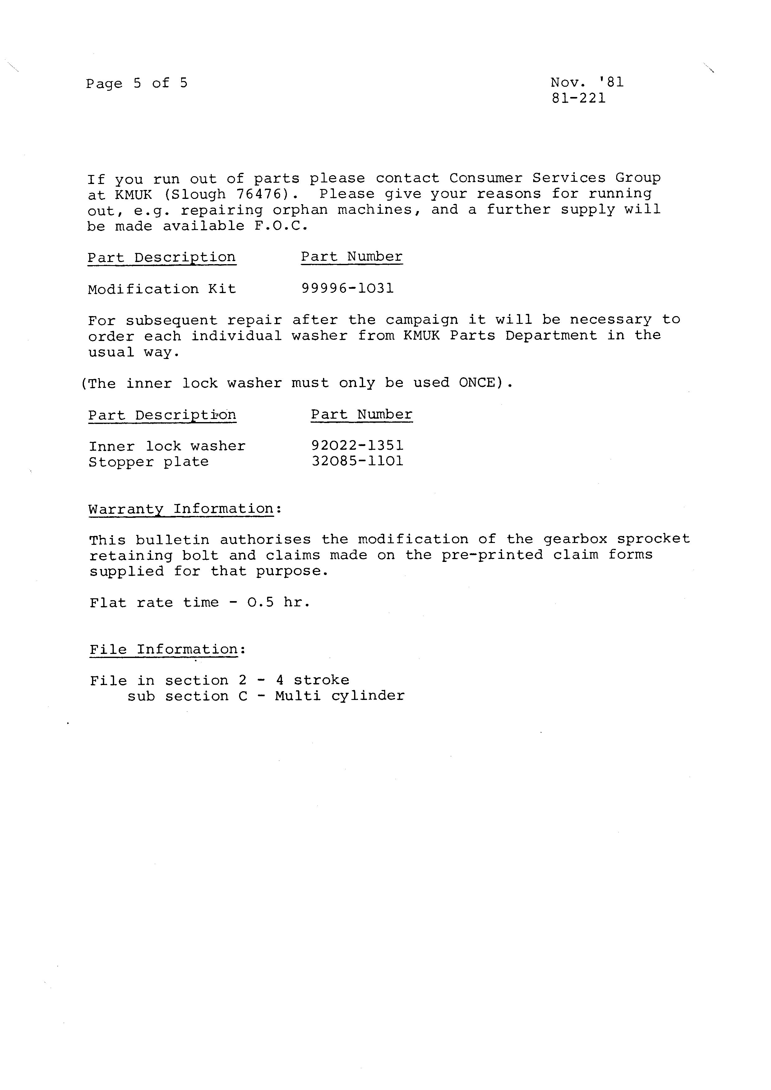

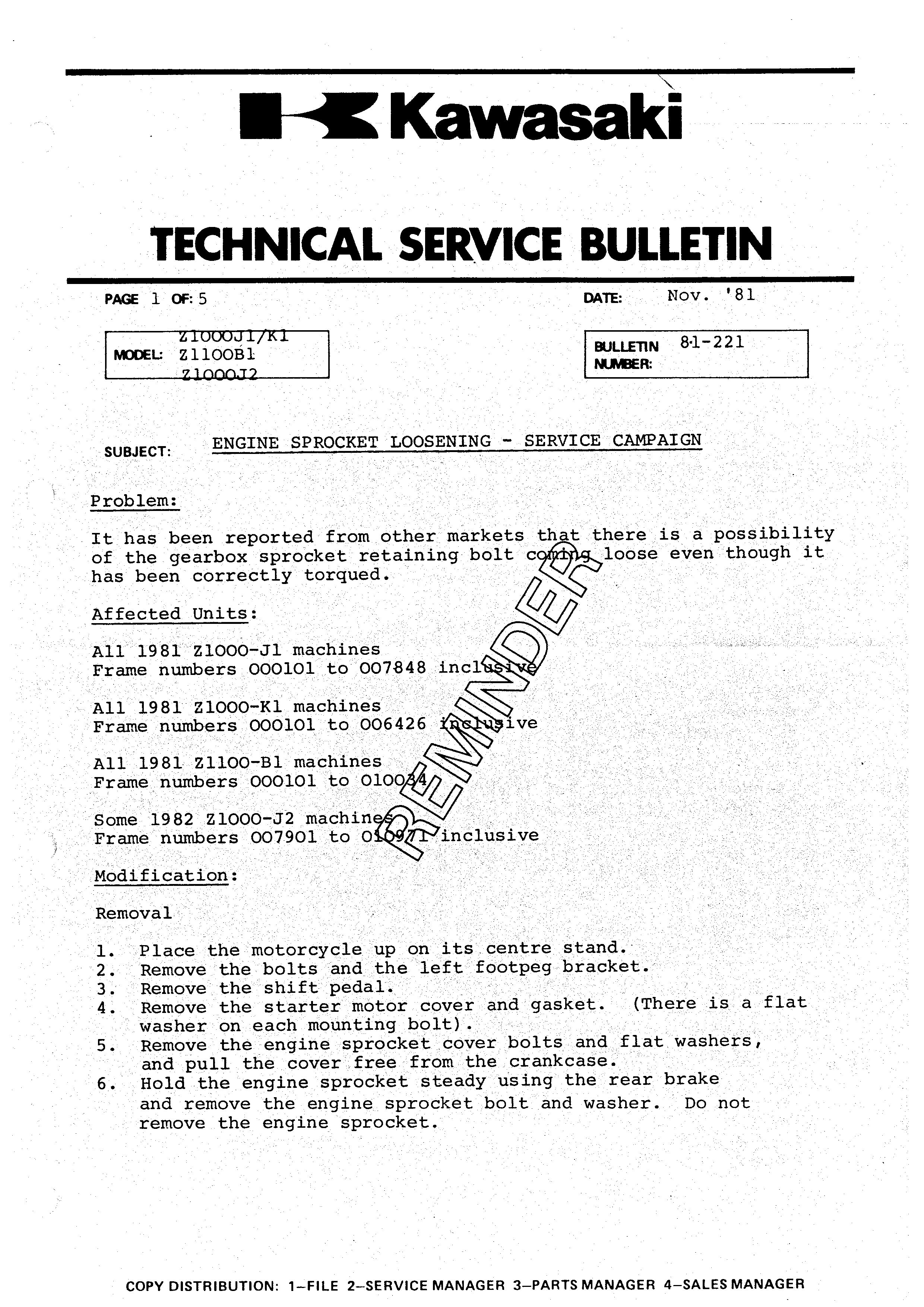

#11 PostAuthor: Al » Thu May 12, 2022 8:44 pm
That diagram you posted above has the fix within it. It would be a later version of this circulated in 1981.

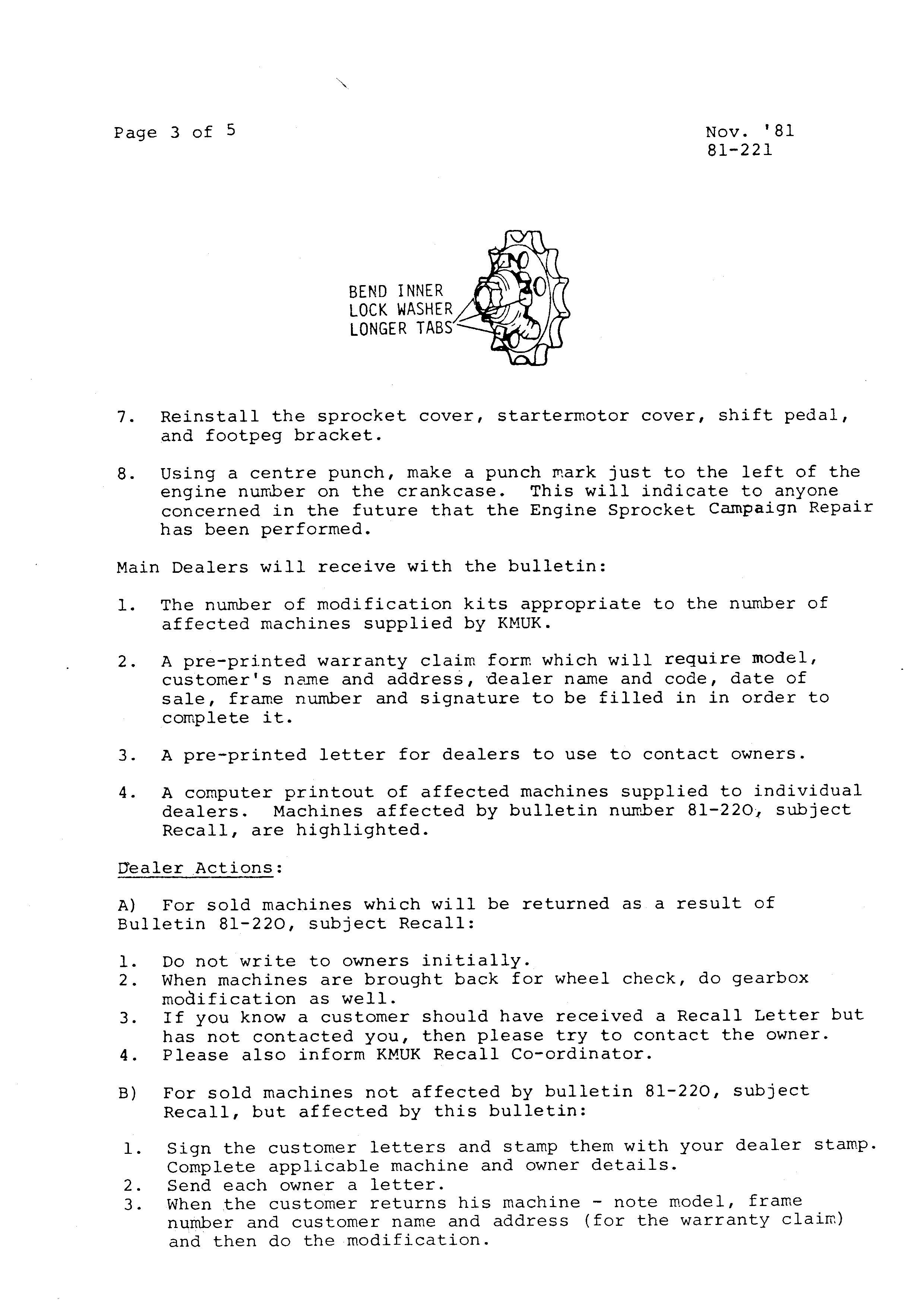

#12 PostAuthor: Al » Thu May 12, 2022 8:52 pm
Have you got a centre punch mark to the left of the engine number??

#13 PostAuthor: warren3200gt » Thu May 12, 2022 8:55 pm
Oh, that's handy mine has the fix applied. Must check the eng number to see if it's been centre punched.
