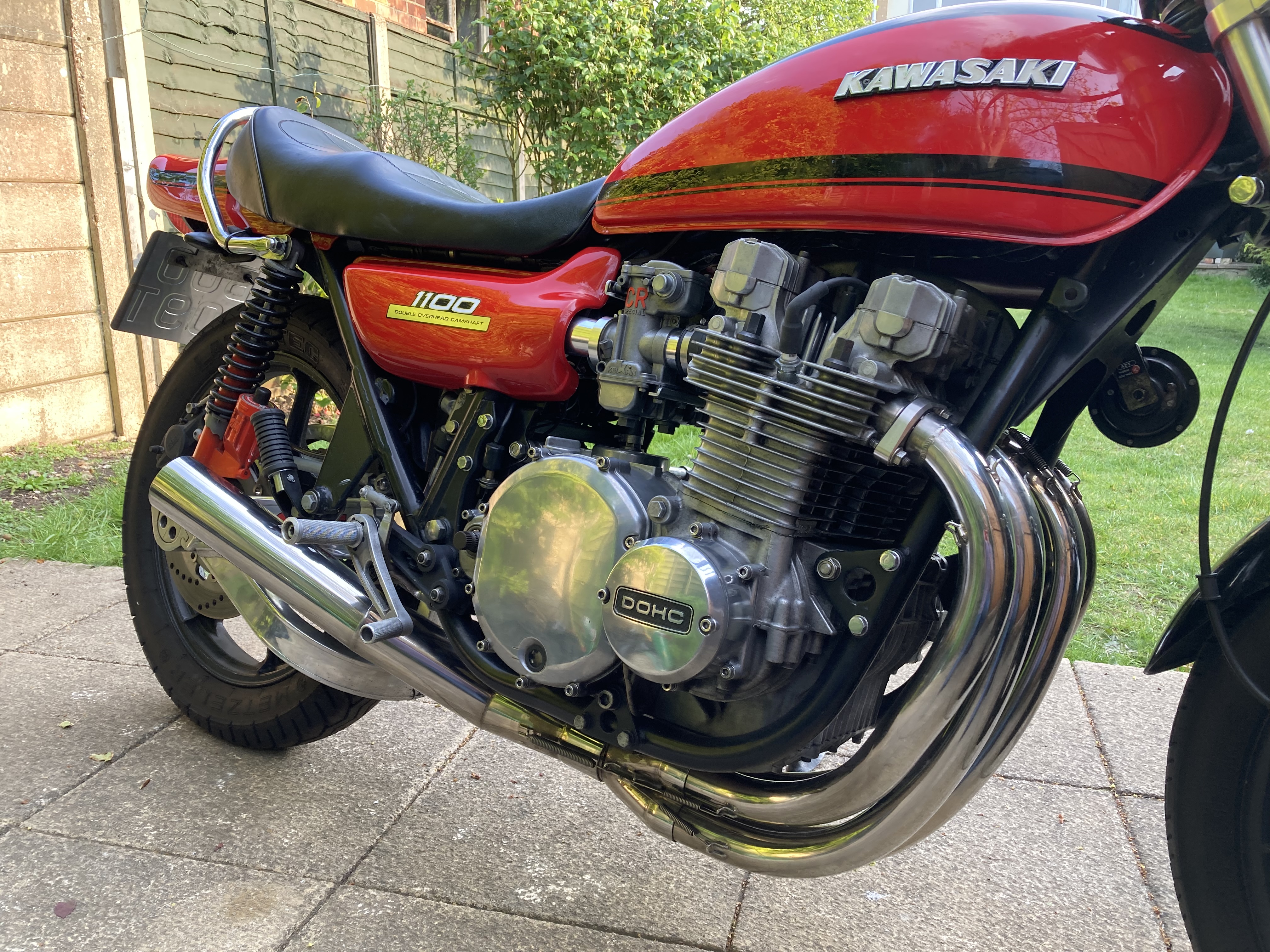

I have Z1 side panels and tank on my Z1000 frame.

#12 PostAuthor: Gus » Sat May 28, 2022 12:24 pm
Very nice Adrian.
How did you do the side panels?
Gus.
