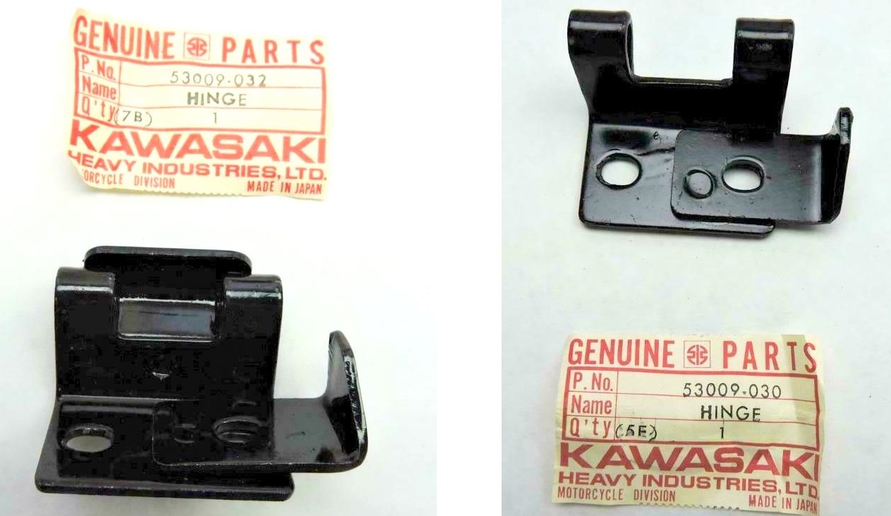

#4 PostAuthor: Philippe » Wed Jun 15, 2022 3:16 am
Hi Keith
the seat hinge of an A1 had an extra piece of sheet metal welded on which acted as some sort of stopper to prevent the seat resting on the side cover.
In the parts list the seat hinges of an A1 and an A2 have different parts numbers but they're not visible on the diagram.

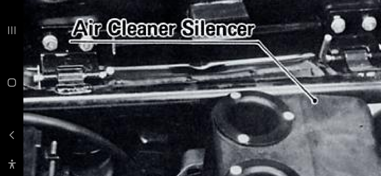

#5 PostAuthor: warren3200gt » Wed Jun 15, 2022 6:57 am
Not sure it helps but from A1 manual.

#6 PostAuthor: z2.john » Wed Jun 15, 2022 7:20 am
Philippe wrote:Hi Keith

#7 PostAuthor: krbdude » Wed Jun 15, 2022 8:42 am
Thanks a lot guys now i can see how it works :D
