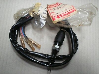

In the event the switch I have is useless do you happen to know the part number for the 4 wire switch?
Re: J2 wiring diagram wanted.
you need to be looking at uk models its listed on the Z1000 R2 uk model. part no 27010-1005
That's the same part number as for the Z400J too, so this wiring diagram might help.
