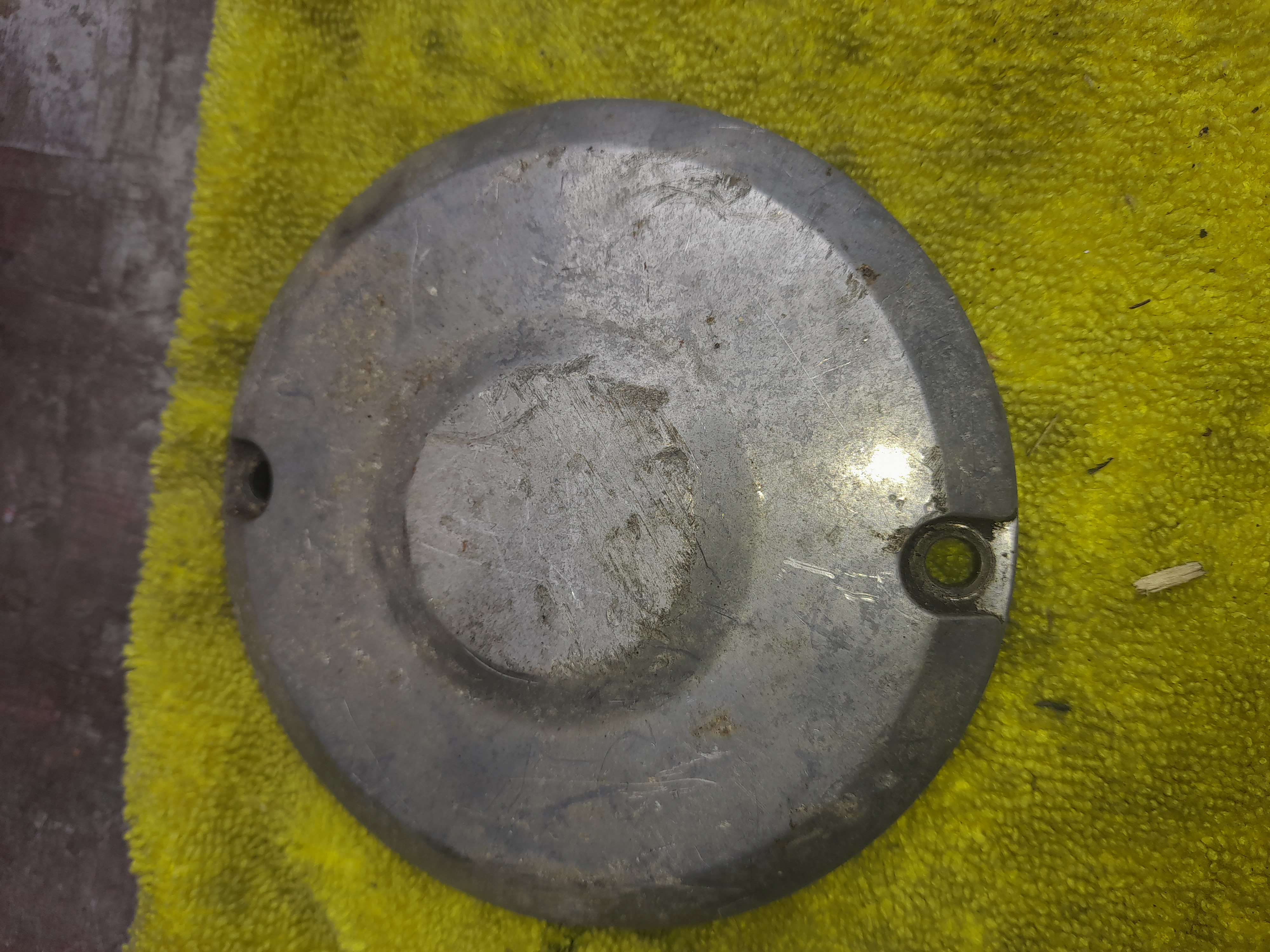

#3 PostAuthor: warren3200gt » Mon Jul 25, 2022 1:37 pm
Think they will fit Rob but earlier ones are a more domed shape.
Pretty sure I've got a mk2 one in then shed. I'll go dig it out and post a pic.
Od 120mm
Hole c to c 103mmm
None of the scuffs are deep and will polish out easily.

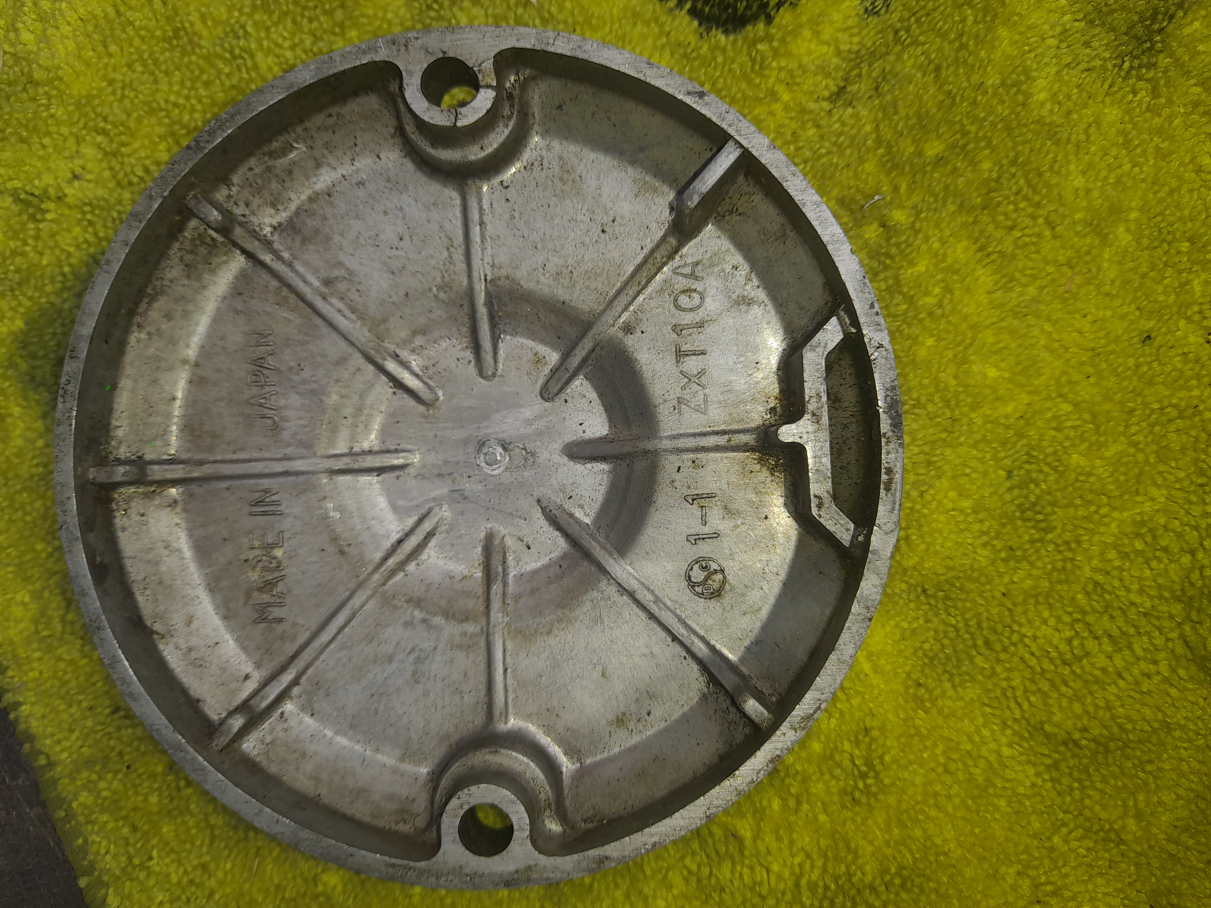

#6 PostAuthor: Philippe » Mon Jul 25, 2022 3:53 pm
Hi Warren
the picture is from the points cover of a Z1100A (ZXT10A). It's the same cover of the Z1000J.
The points cover of a MK2 is the same as the one of the Z1000ST.
It has horizontal stripes and the word "Kawasaki" is on it. The recessed area is painted black.
Posts: 3110
Re: Points Housing
#7 PostAuthor: warren3200gt » Mon Jul 25, 2022 3:54 pm
Must be a j2 one then Philippe. Never owned a 1100A

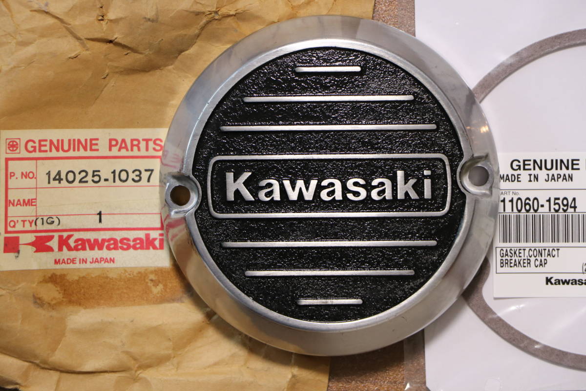

#8 PostAuthor: z1bman » Mon Jul 25, 2022 4:51 pm
this is a mk2 cover
