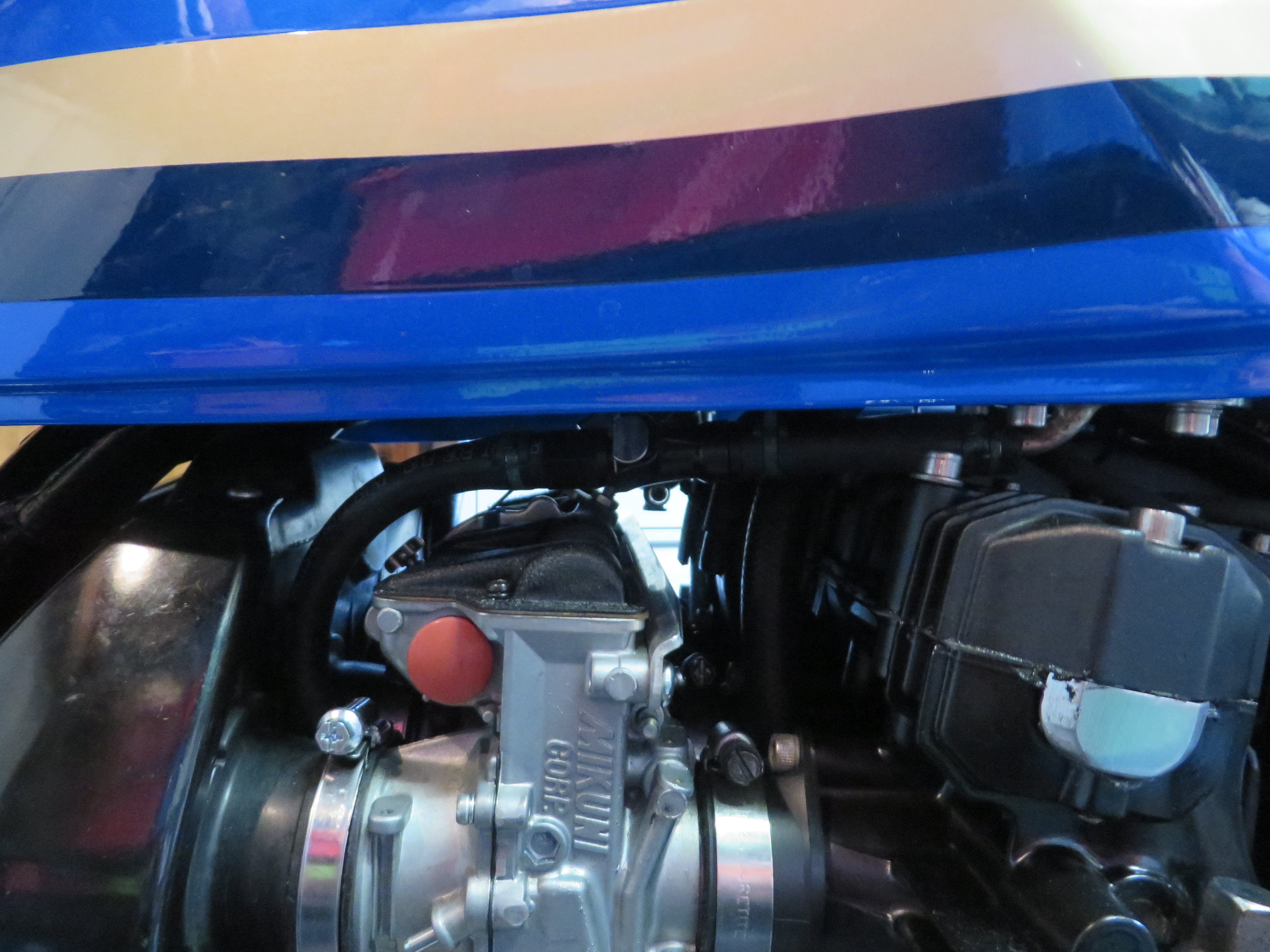

Back story, modified 1000j2 running bored out Vm26 carbs, Gpz1100 top end.
Downside is original fuel tap will foul the carbs due to position its located on the tank.

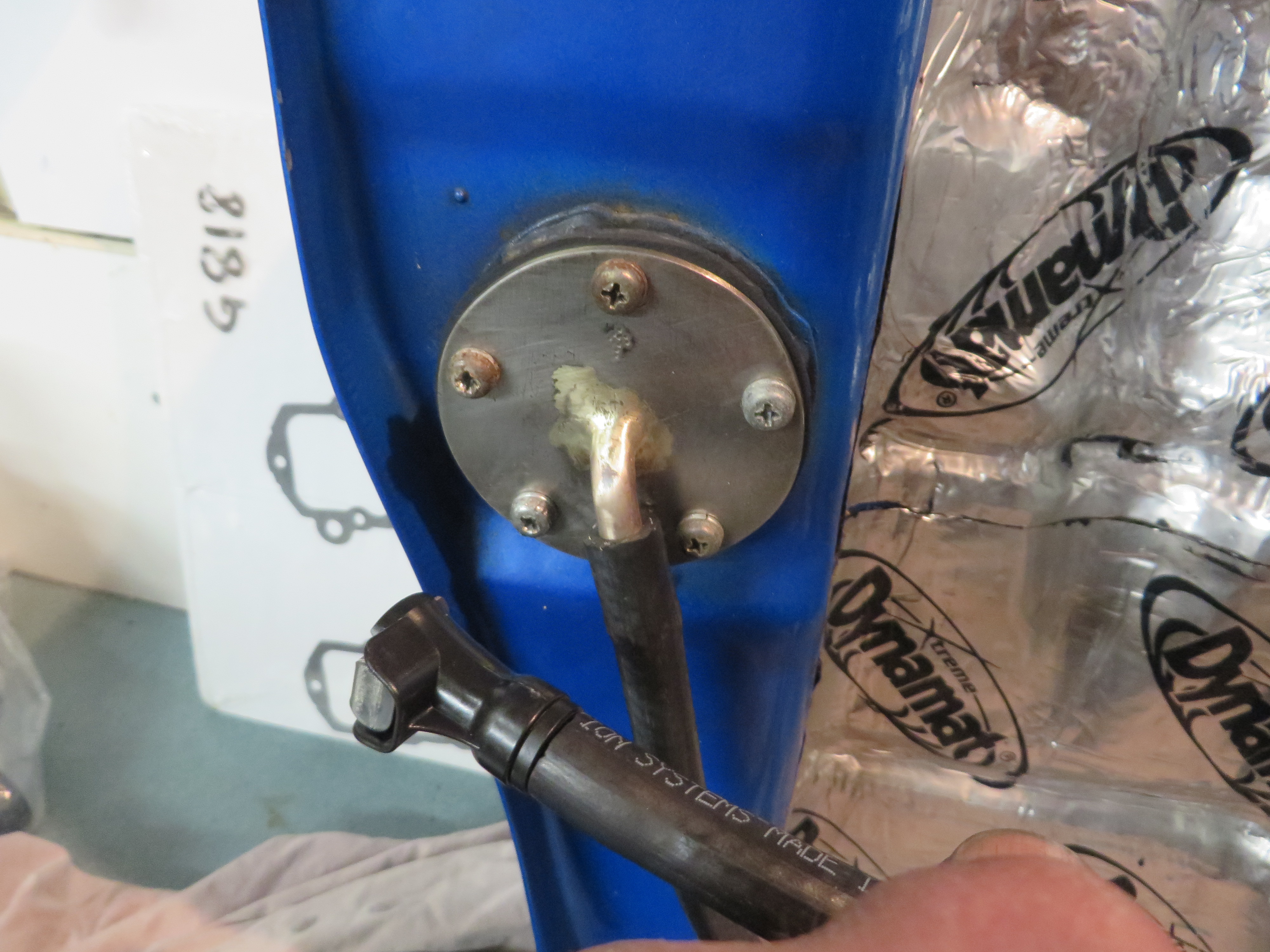

This is my inline tap. Been using it for 6 years now and no leaks. Think it came from screwfix plumbing section.
I had converted the fuel sender hole to be a second outlet!!!

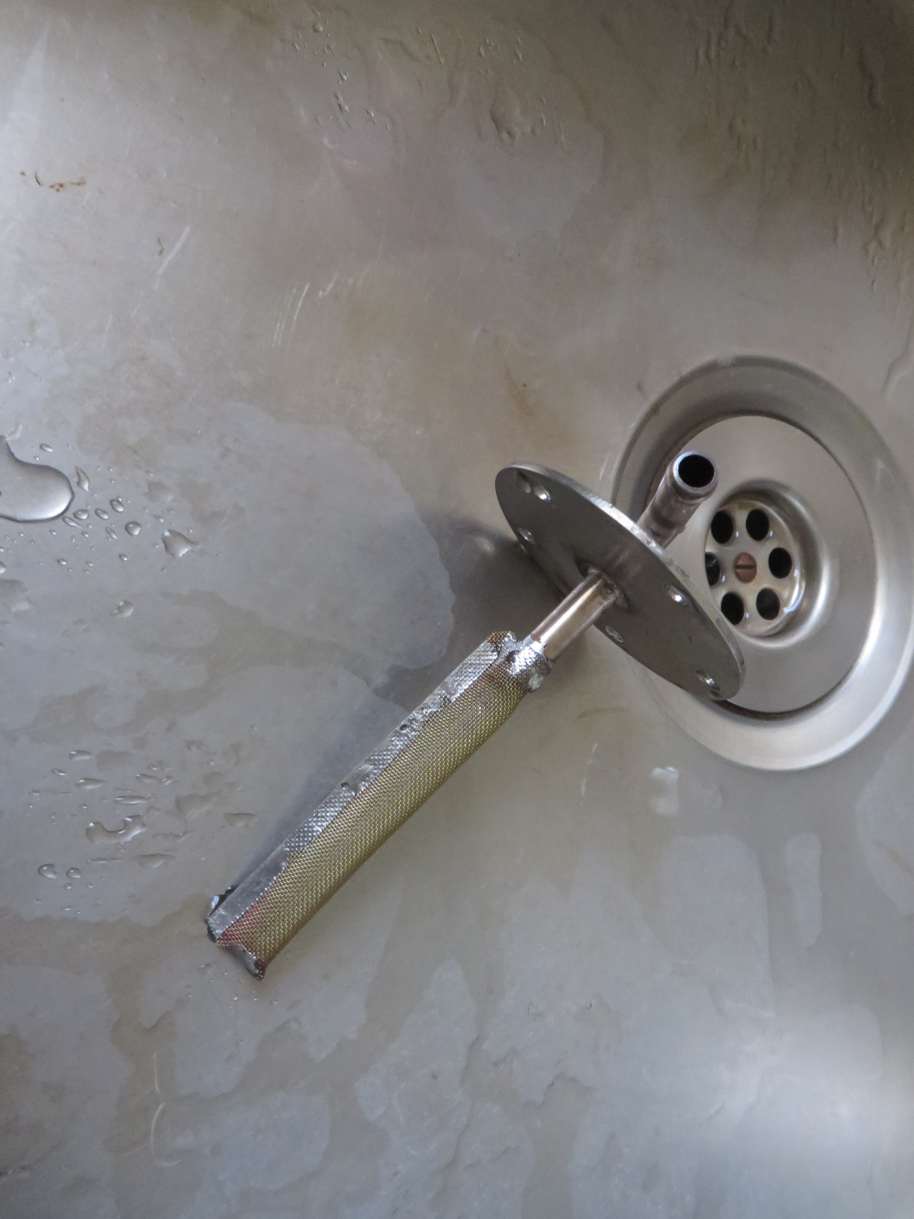

If youre making a twin outlet feed from the existing oval tap hole you can still incorporate a filter of sorts. This is just fine brass gauze, soft soldered together and onto the piece of brake line.
