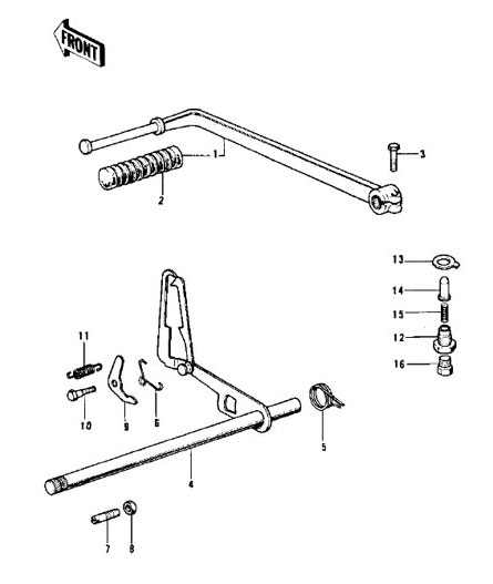

Hi. I'm posting for the 1st time as i have just been out on my bike and after initially having all gears to select, a few miles into the ride the gear lever seemed to go 'loose' and I can now only get 1st and 2nd. The lever is tight on the shaft, so it's not that. I have limped back home in the cycle lane! Any suggestions as to the cause? I bought the bike in a restored condition and have put about 1000 miles on it this year without any major problems. Well. other than the battery blowing to smithereens under the seat on a ride! Another limp home, misfiring all the way. I put a new reg/rec from Dave at Z power and that sorted that.

Sounds like the lever return spring has broken.
It lives on the other end of the lever shaft behind the trans cover.
Part number 5 in the atteched pic.

Hi. Thanks for your help. I've delved in and it was exactly what you said, a snapped return spring. Got another couple of related issues if I can bounce them off ya?
