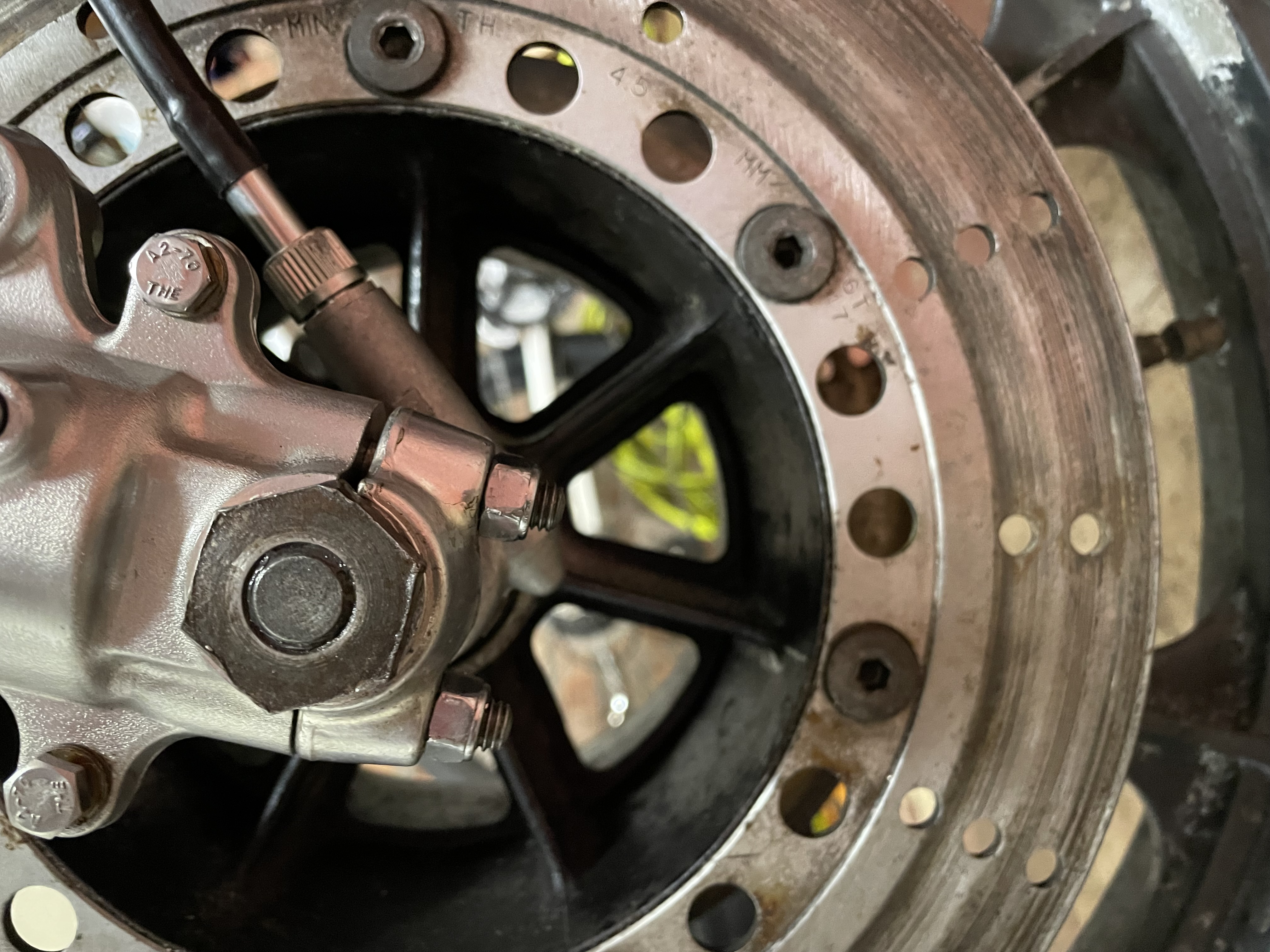

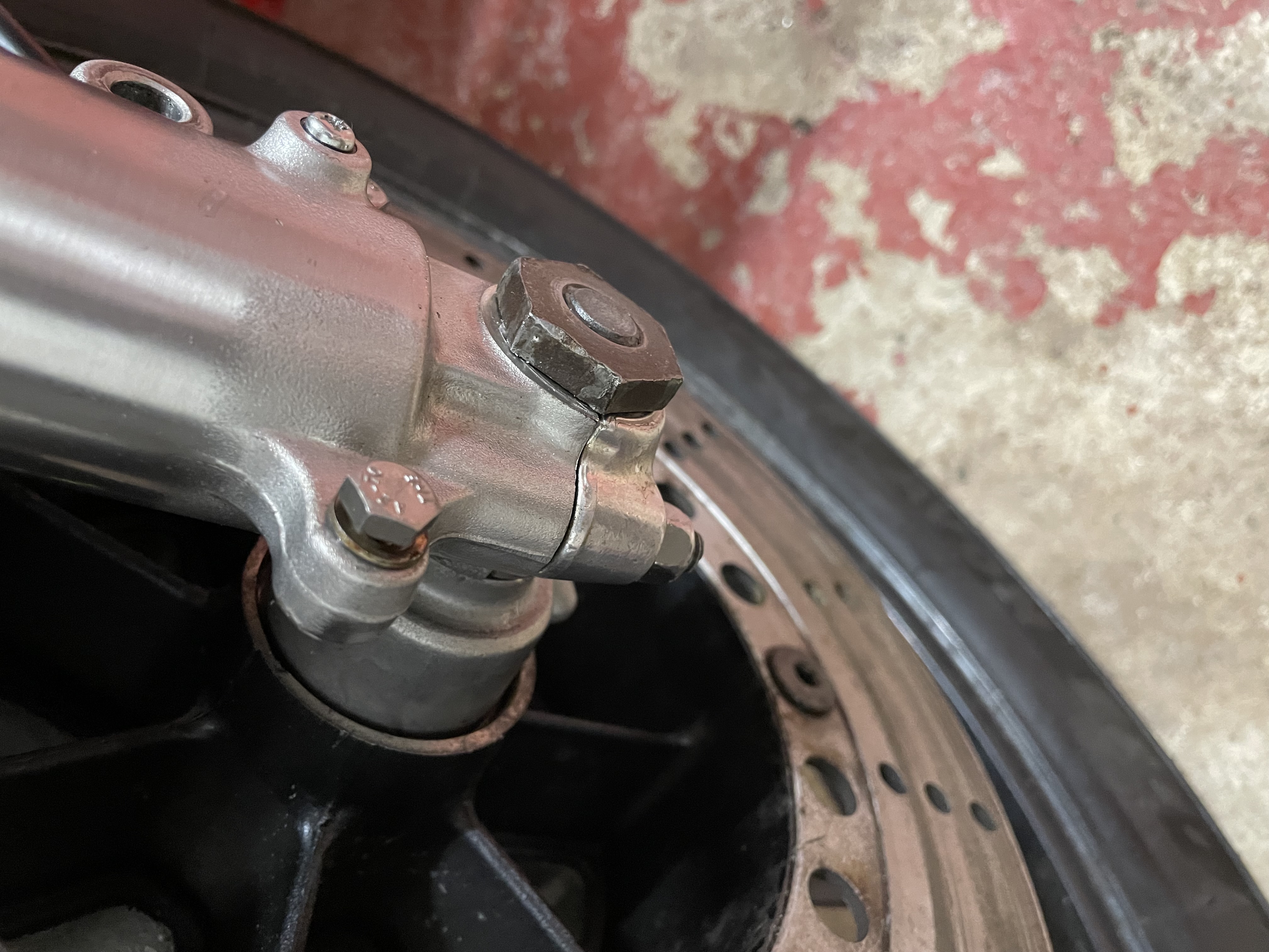

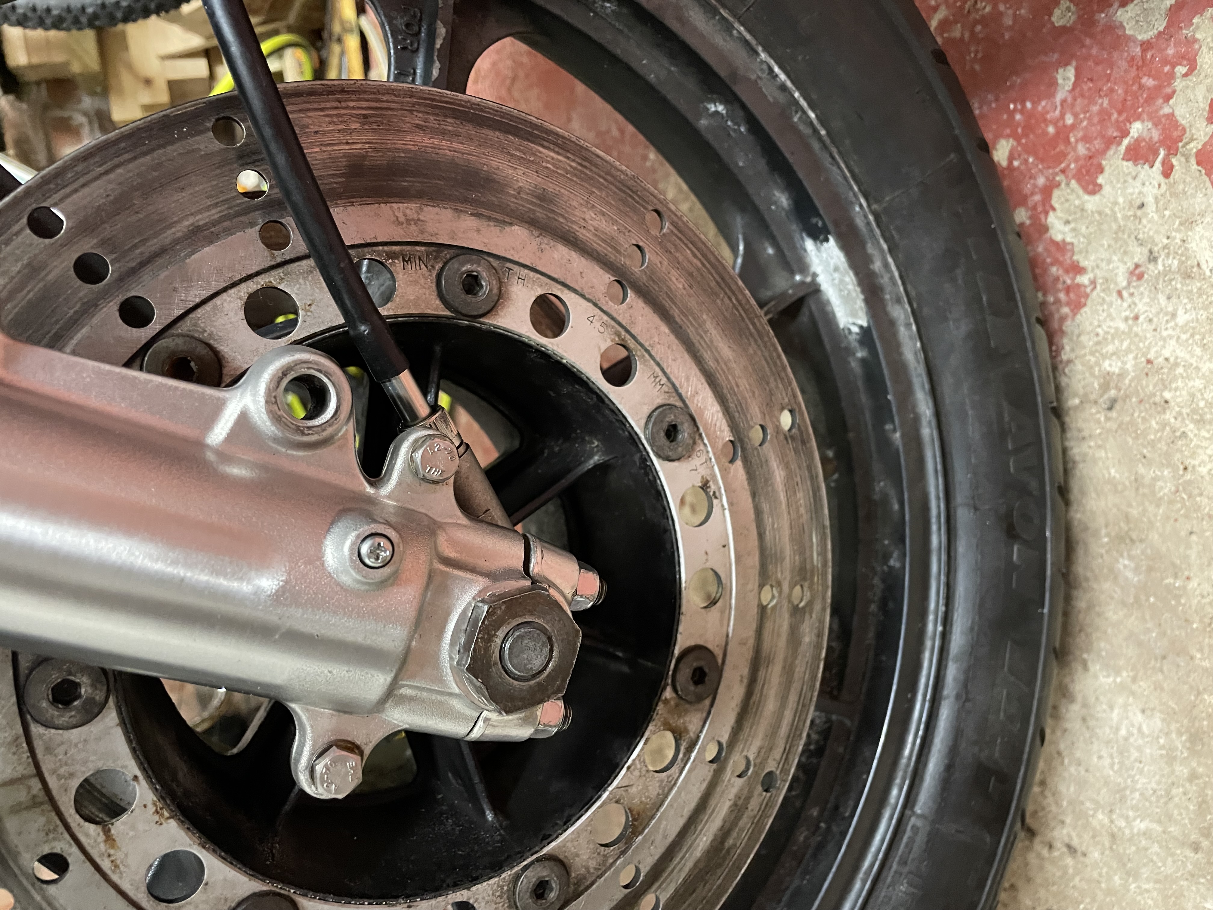

Hi Guys, i am in a real mess which started as a snapper speedo drive cable on my 1997 Police model KZ1000-P. Tryin to repair it has crought me all kinds of grief, including changing the oil in the forks, which i hope have worked ok as i have not yet reached the extent of testing that yet. The issue I am having currently is refitting the front wheel.
The speedo sensor (mechanically driven from the lugs on the left side) turns with the wheel. I have attached a video hopefully to shows this, so it turns as the wheel turns and if i forcr the wheel forwards, the speedo sendsor would force past the pins and eventually wrap itesnf around the wheel instead of sitting in place and having the wheel rotate around it.
My question really is what should be rotating here - should the axle be rotating and as you see inthe video, the nuts at the emds of the axle turning or should they be fixed in place and some other internals rotating srounf bearing allowing the speedo drive to sit in one position.

It would appear your speedo drive casing isn't located correctly .I'm sure it should use the fork leg to hold it in place and the cable drive should come out parallel to the ground

Hi . No the nuts should not be moving the clamps should hold the Sleeved part of the nuts still.
As mentioned earlier there should be a notch in the speedo drive which locates into the fork leg .
The only parts that should be moving are the front wheel and the internal gears for the speedo drive assembly .The 2 nuts on the lower fork legs should be holding the axel nuts in place on either side with the gap to the rear of the fork legs .Try loosely assembling it and ensure the speedo drive doesn't rotate before tightening it all up.

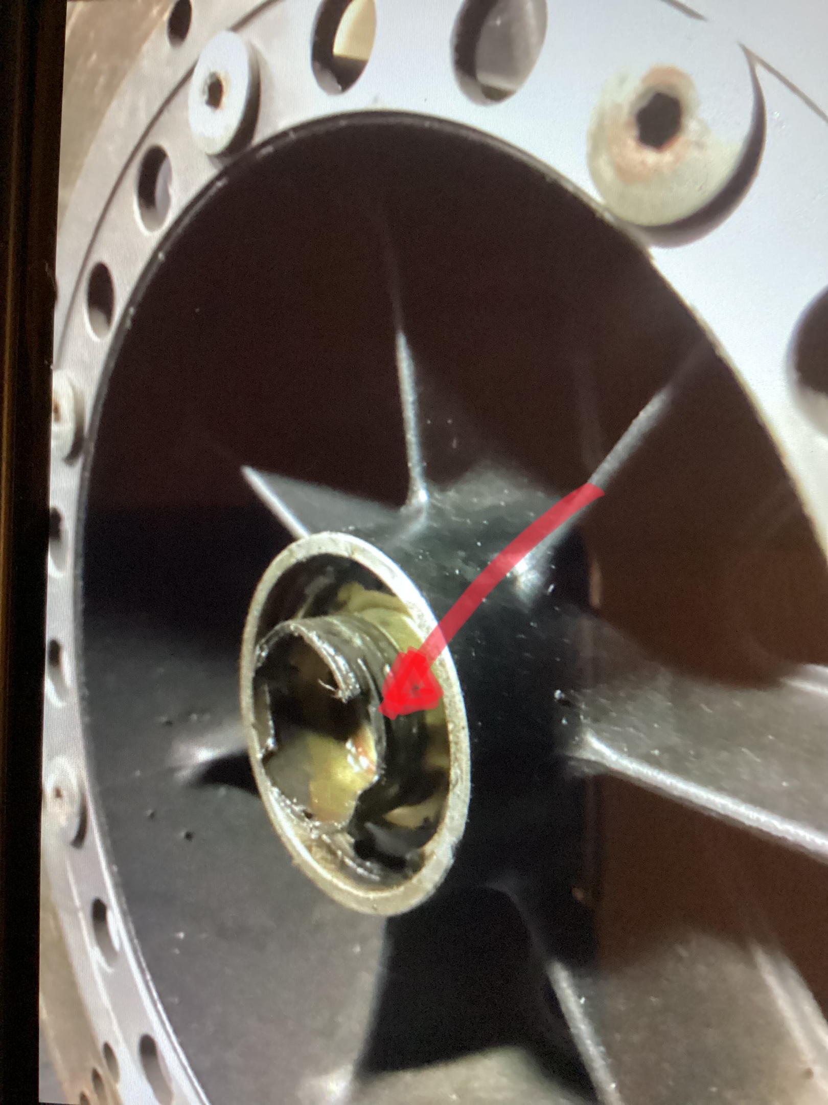

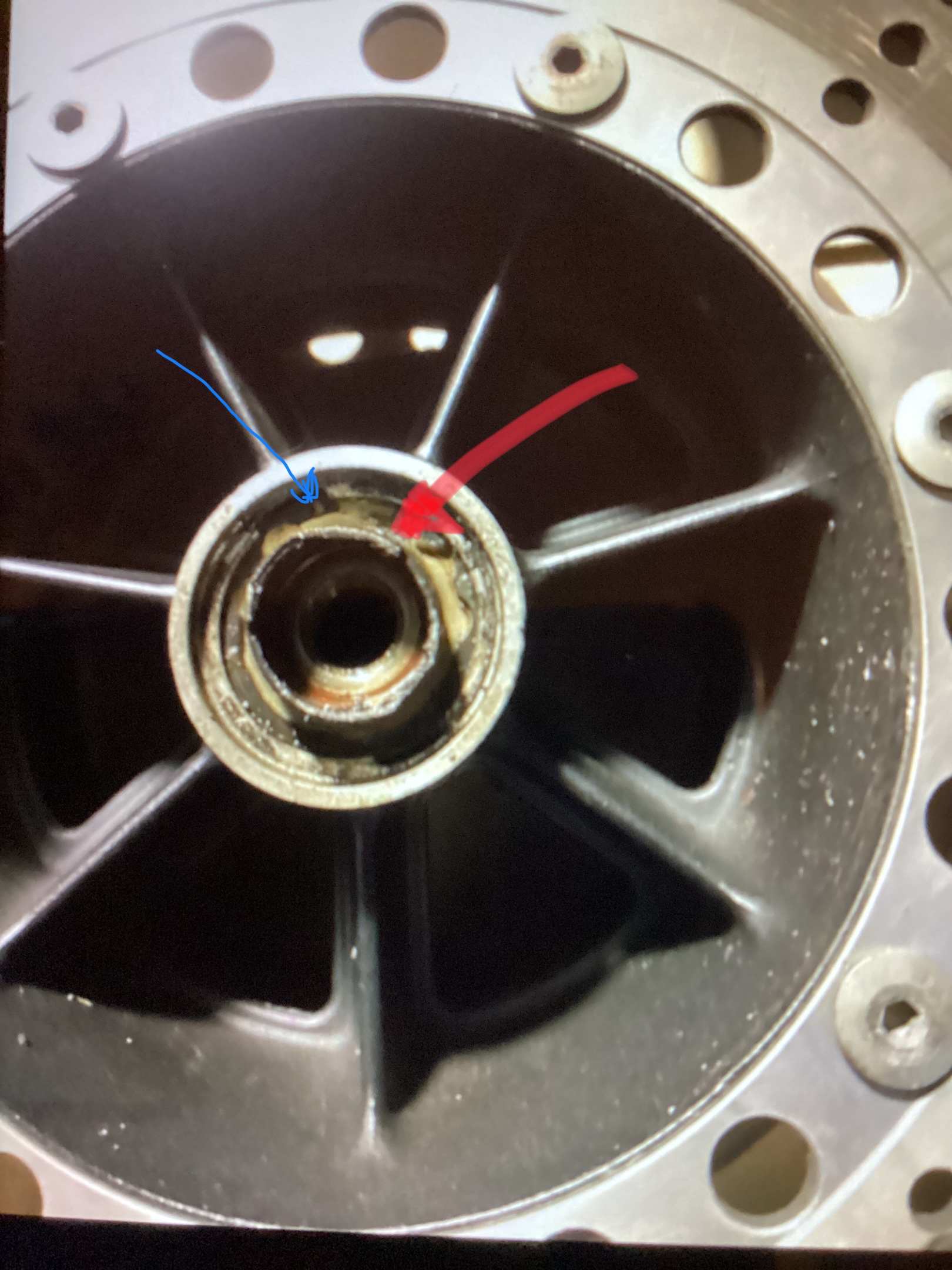

Attached are a couple of pictures which might help.
However, reading what you have written in your post and looking at your pictures I’d recommend getting a second person involved to have a look at this - preferably someone experienced with old Zed’s (a second pair of eyes / other person looking is always good) As Kz900B1 says, it looks like the speedo drive is not locating correctly ALSO those spindle nuts MUST BE done up tight and clamped tight by the fork caps. BUT if there’s something not assembled right you might just be causing more problems. All of the parts must be assembled correctly / tightened in the correct sequence to avoid problems
Re: my attached pics. The RED arrow points to the crown/ top hat shaped part which is the “drive” for the speedo and this part rotates with the wheel. The blue arrow is an internal circlip which secures this part in place on the wheel. . THIS PART GOES AROUND WITH THE WHEEL. There is another part HIDDEN INSIDE the speedo drive gearbox / housing - (what the cable is fixed to on the left of the wheel) This hidden part is behind an oil seal and therefore can’t be seen but this part matches the two slots / cut outs you can see in my pics. of the crown/top hat bit - this hidden part ALSO rotates with the wheel. If for some reason the hidden part and the crown bit have been wrongly assembled then damage might be caused which can produce problems.
You say the speedo drive rotates without problems - you should be able, with the front wheel removed, to locate the speedo drive on the crown / top hat bit fixed to the wheel and rotate the drive gearbox by hand with the wheel held stationary - if the speedo drive won’t turn its SIEZED - this could be the cause of the problems

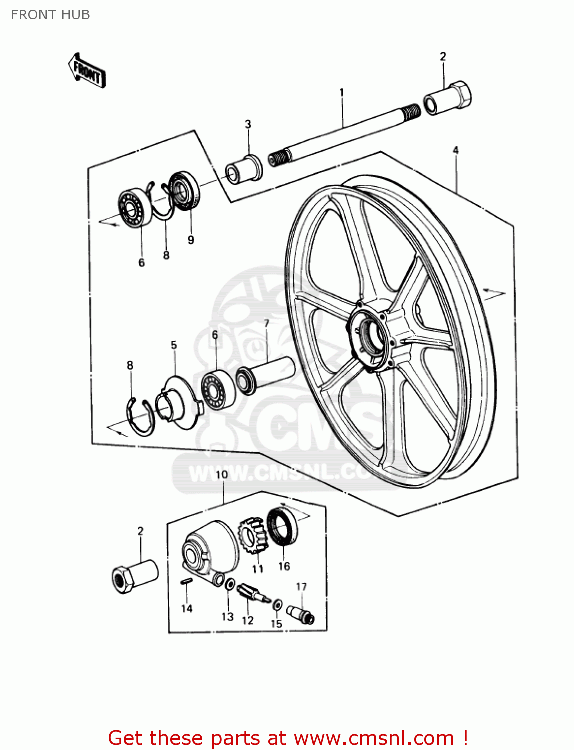

Have you got a kwak workshop manual? If not use the cmsnl site for the parts drawings which you can work out if you have all the bits in the right order, it's useful but by no means a replacement for the manual.
https://images.cmsnl.com/img/partslists ... 7_c789.gif
https://www.cmsnl.com/kawasaki-kz1000p6 ... partslist/
