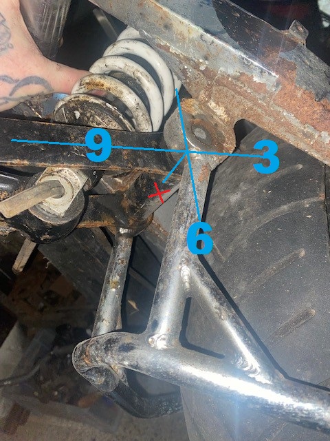

Could someone post a photo of part 49072 on a bike please?
https://images.cmsnl.com/img/partslists ... 7_6baa.gif
I want to put a grease nipple in and sod's law says if I try and work it out it won't be accessible once fitted.

Thanks Adrian for looking. Unfortunately it's the later model.
I could do with a picture of the part on a complete bike to give me an idea of where to place the grease nipple that allows access in the future.
I've scoured loads of forums, pics on google etc and can't find the pic I need anywhere.

So i think i know what you are looking for, i mocked up on an 1100 swing arm, where the linkage would be in relation to the shock and if the linkage arm in relation to the center pivot is lets say "9 0 clock" then the grease nipple for full access even with my braced swing arm, is at "at half past 7" if you catch my drift....

Thank you very much for doing that. Very much appreciated. That's exactly what I needed.
If you're ever in the centre of France, call in, wine will be waiting.
