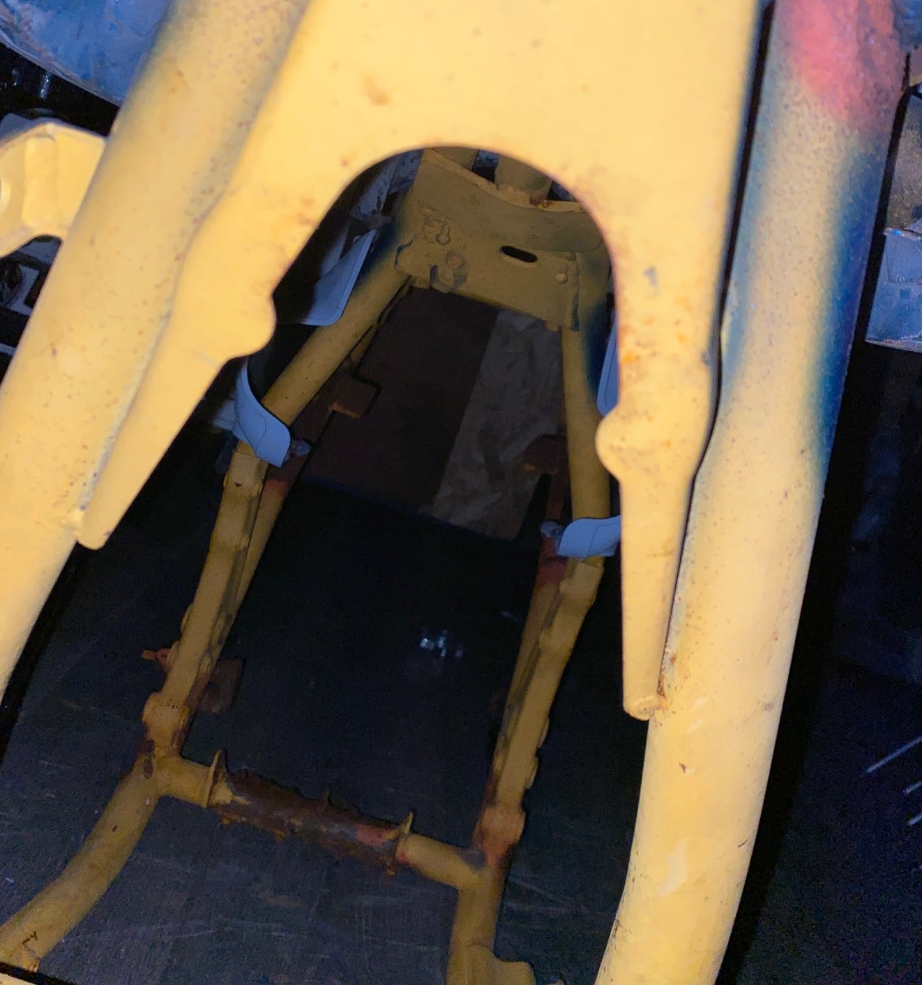

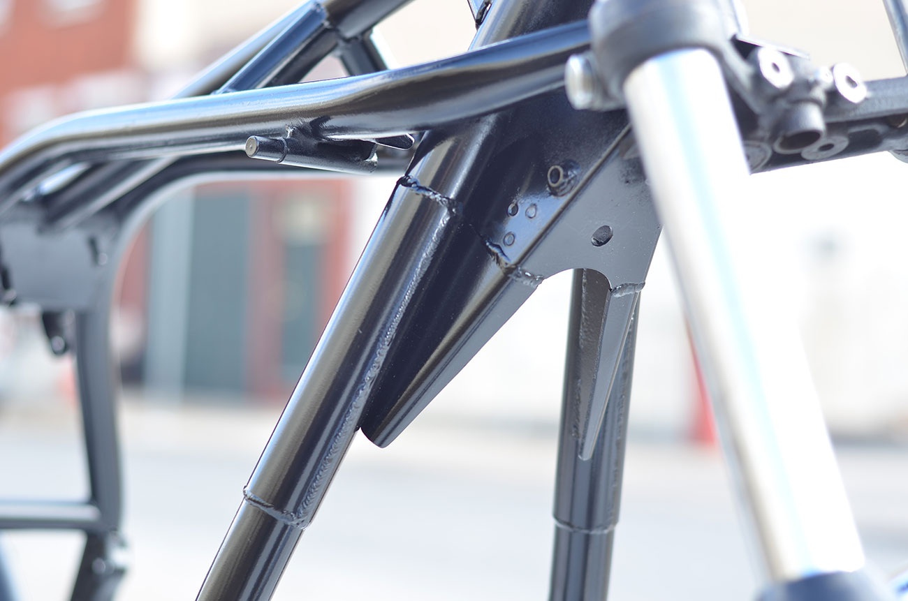

#5 PostAuthor: Z1streetfighter71 » Fri Nov 18, 2022 9:53 pm
On the black gusset there are holes this was the later 73 and 74, the yellow gusset has no holes and this is one of my 75' and i think and im open to be corrected the early 73 gusset was straight.

#8 PostAuthor: z2.john » Fri Nov 18, 2022 10:32 pm
The oil cooler holes mentioned in the previous post were removed circa frame number 65000.
There was also another slot shaped hole added to the central brace (can be seen in the yellow frame pic). This started to appear circa Jan 1974

#9 PostAuthor: Z1streetfighter71 » Fri Nov 18, 2022 10:42 pm
z2.john wrote:The oil cooler holes mentioned in the previous post were removed circa frame number 65000.
Thanks for that John, the only pic of an early 73 frame gusset is this one but i think the builder removed the oil cooler holes in the repair he did, maybe thats what i read and just picked it up as a straight gusset.
