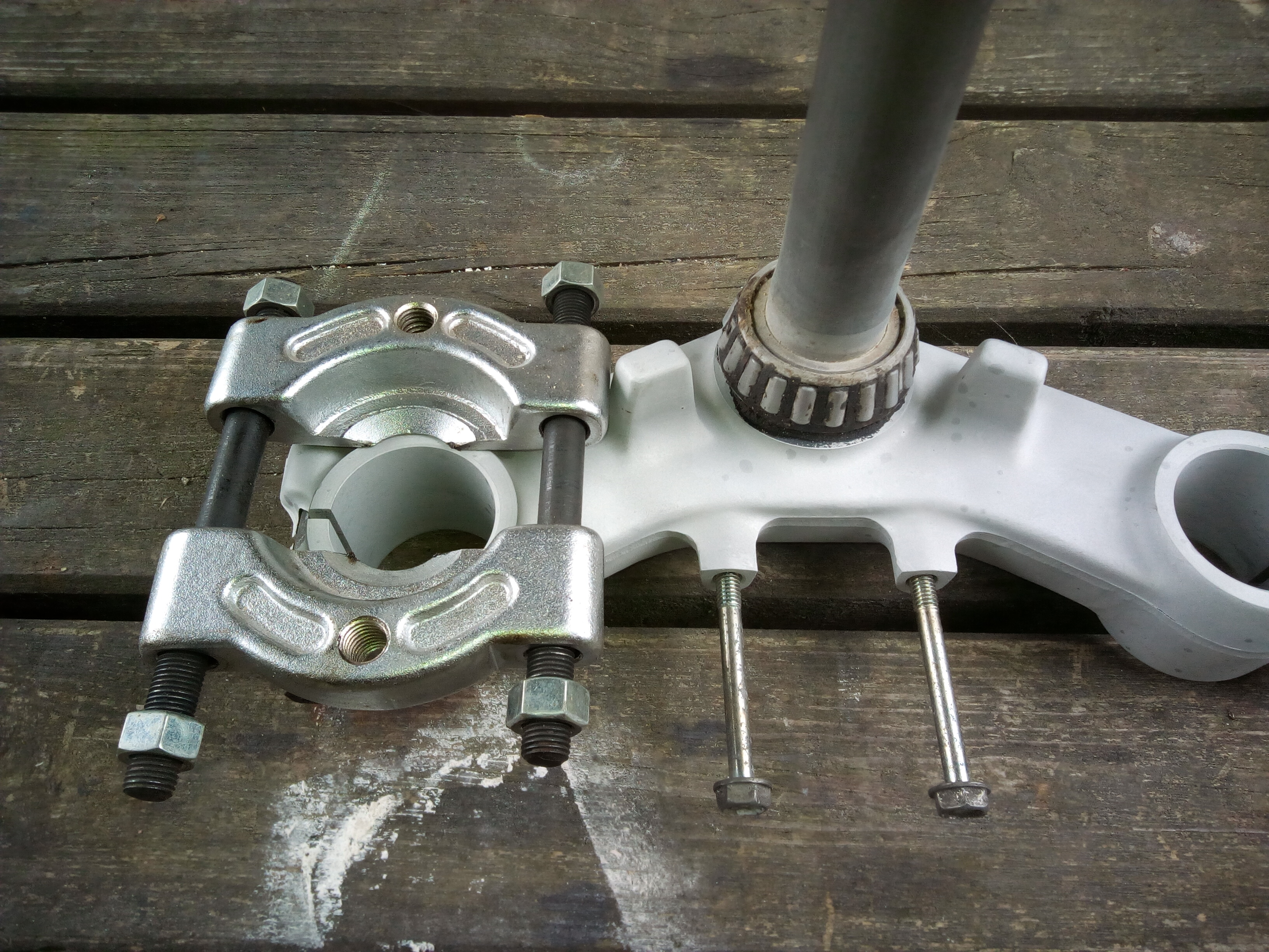

Is there a trick or tool to get this bearing off? My bearing puller won't get in due to the lock stops.
Or is it a case of smacking the conical needle roller off then grinding the inner race....like a car front hub?

Nah, screwdriver didn't work, the faces are flush, very tricky. Grinder then flap disk followed by blow torch tomorrow after work. They are so flush I don't think the bearing puller would have got in.

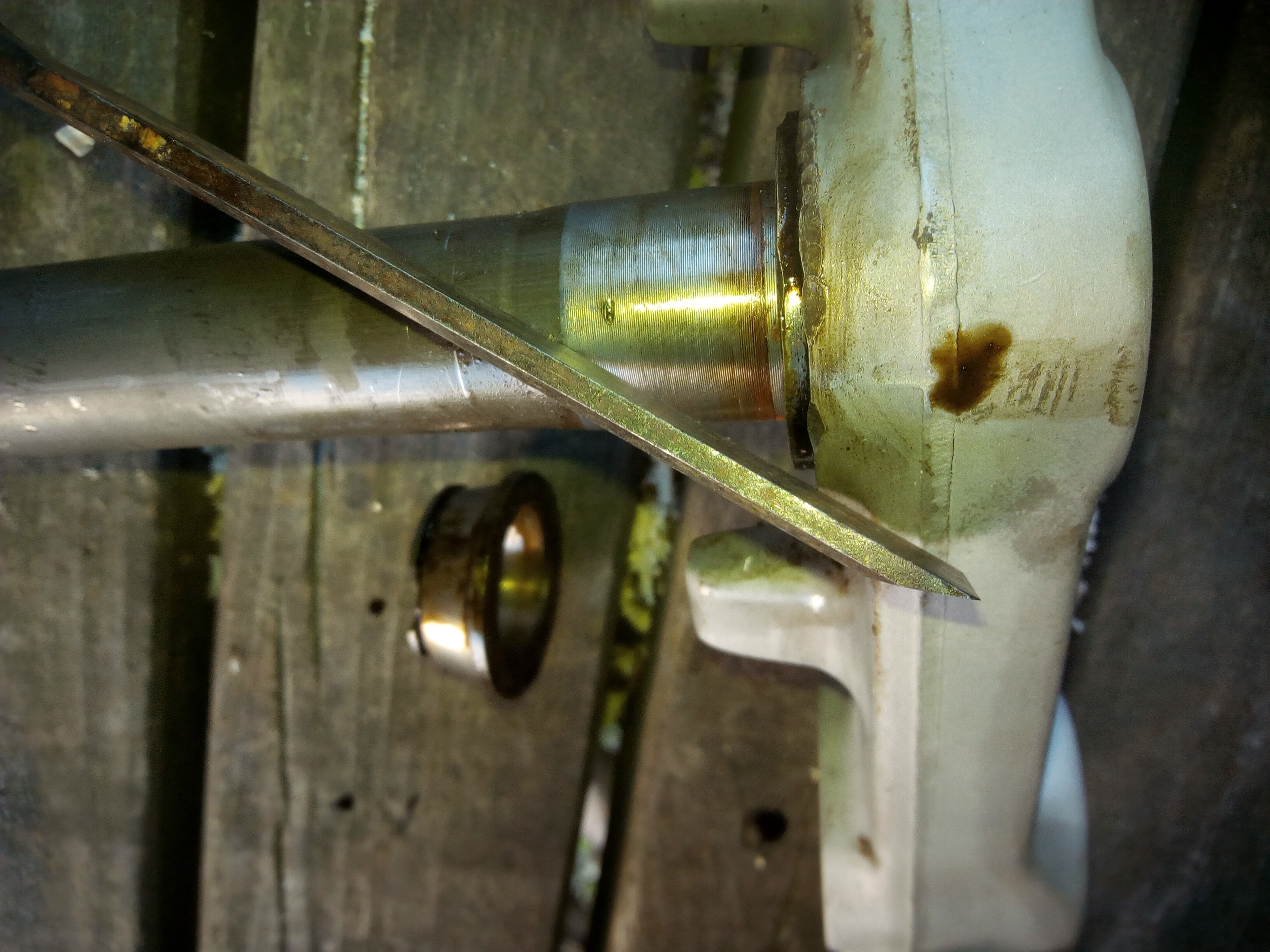

Tried a bit of heat, possibly not enough, didn't do anything. When using the heat I tried gently tapping the smaller end of the bearing, too brittle, just broke.
Gave a good coat of my homemade penetrating fluid (50% acetone, 50% power steering fluid), sharpened up an old wood chisel on a flap disc......30 secs later it was off.
Just need to dress the little bit of damage on the yoke, will us a rag or be more careful next time.
Not sure if the GPz11 is different to the others but the bearing outer is absolutely flush, no lip at all, to the machined part of the yoke.
Thank you very much to all.

I notice that the outers were very flush with no lip when I took them off so when I eventually got them off I used the dremel to grind off 2 areas , 180 degrees apart, 2mm deep and 8mm wide into the seat where the outer sits. That way it's not a struggle next time - there's a lip for the drift to fit onto.
