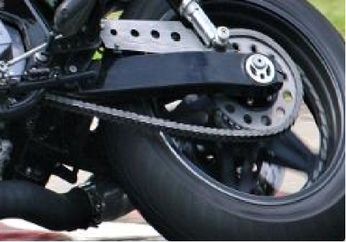

I fitted a ZR 750 ( i think) arm because i didnt want sometimg that looked too new or too technical for what is a 40 year old bike.
Some cutting and welding but relatively straight forward, and a universe away from the original as far as weight and performance goes.
I know a lot of people hate the eccentric adjusters but its a bonus for me to be able to lift or drop the rear ride height by an inch if i feel the need to.
