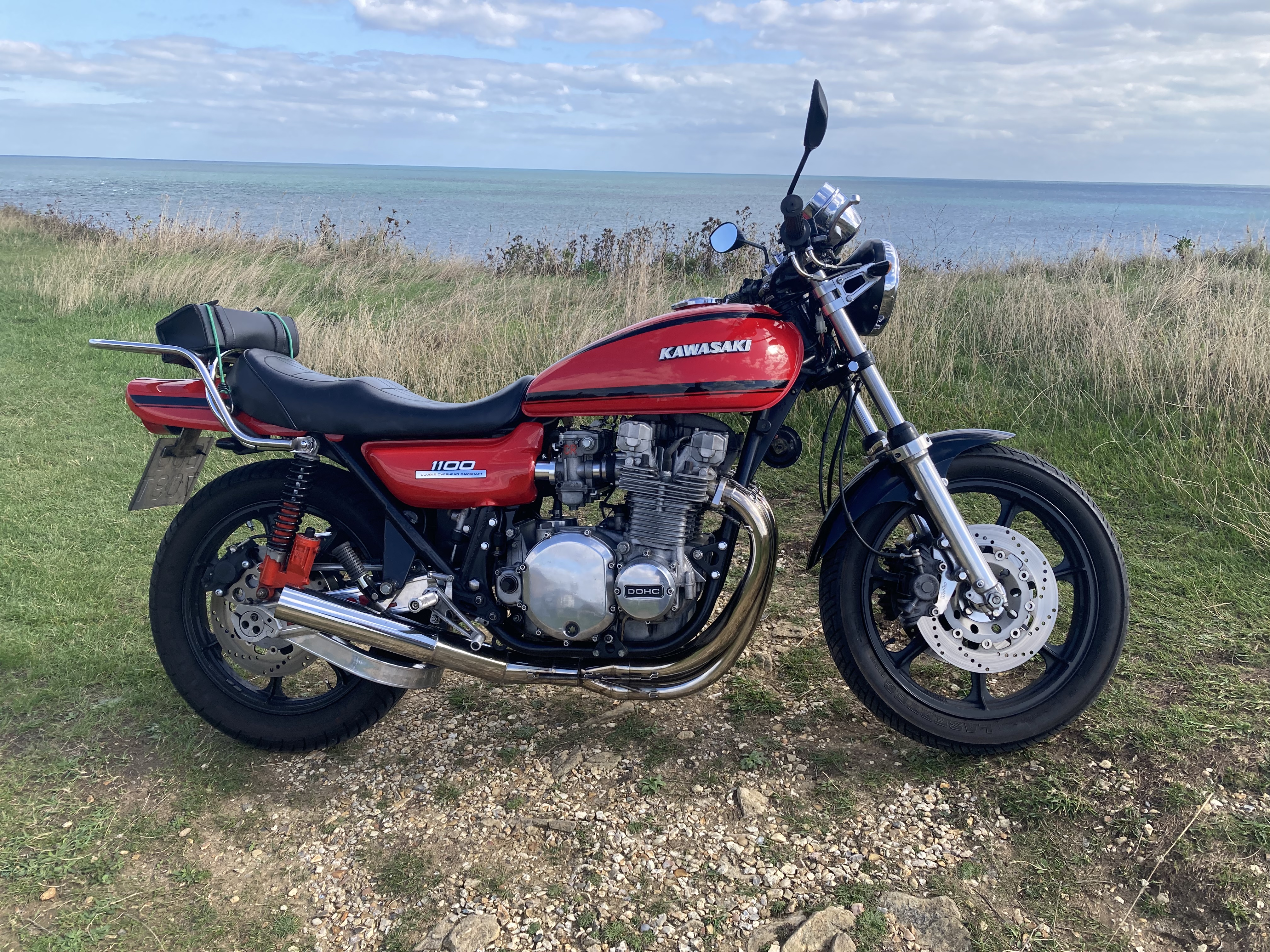

I use AP calipers on my lawson and endurance bike, absolutely fantastic. You will need adapter plates making, which is pretty straightforward. No doubt someone on here will have a set for you to copy. Not overly expensive for what you get. Grimeca do copies which are cheaper, but just as good.

I have AP racing calipers on brackets on my Z1000A2, a lot better than stock.

I use the AP master cylinder on my Lawson and a zrx one on the endurance bike, both work well and look good

Adrian H, nice bike! I’ll be using Z1 forks: do your CAD files cope with that?
And us that a standard Kawasaki master cylinder I see?
