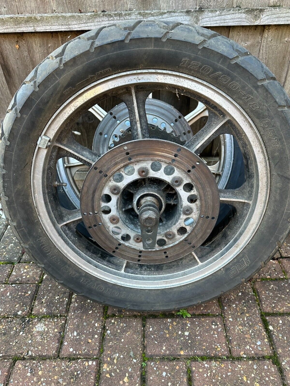

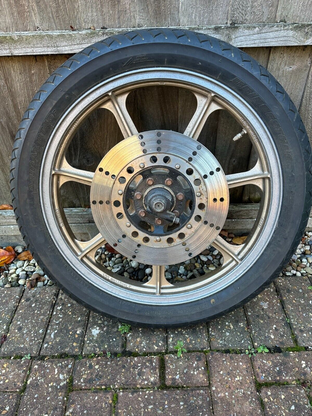

#1 PostAuthor: rpeters » Tue Jan 17, 2023 7:18 am
Can someone ID these wheels please...are they J?

#2 PostAuthor: DeadZedDave » Tue Jan 17, 2023 8:51 am
Front wheel looks like z1000ST
Back wheel looks like z1000J (if its a 2.15 rim width - a 2.5 rim is used on some GPz11's and 1000/1100R's - all these have 20mm spindle - if the spindle is 17mm it would be from one of the 750's)
As always, I'm happy to be corrected !

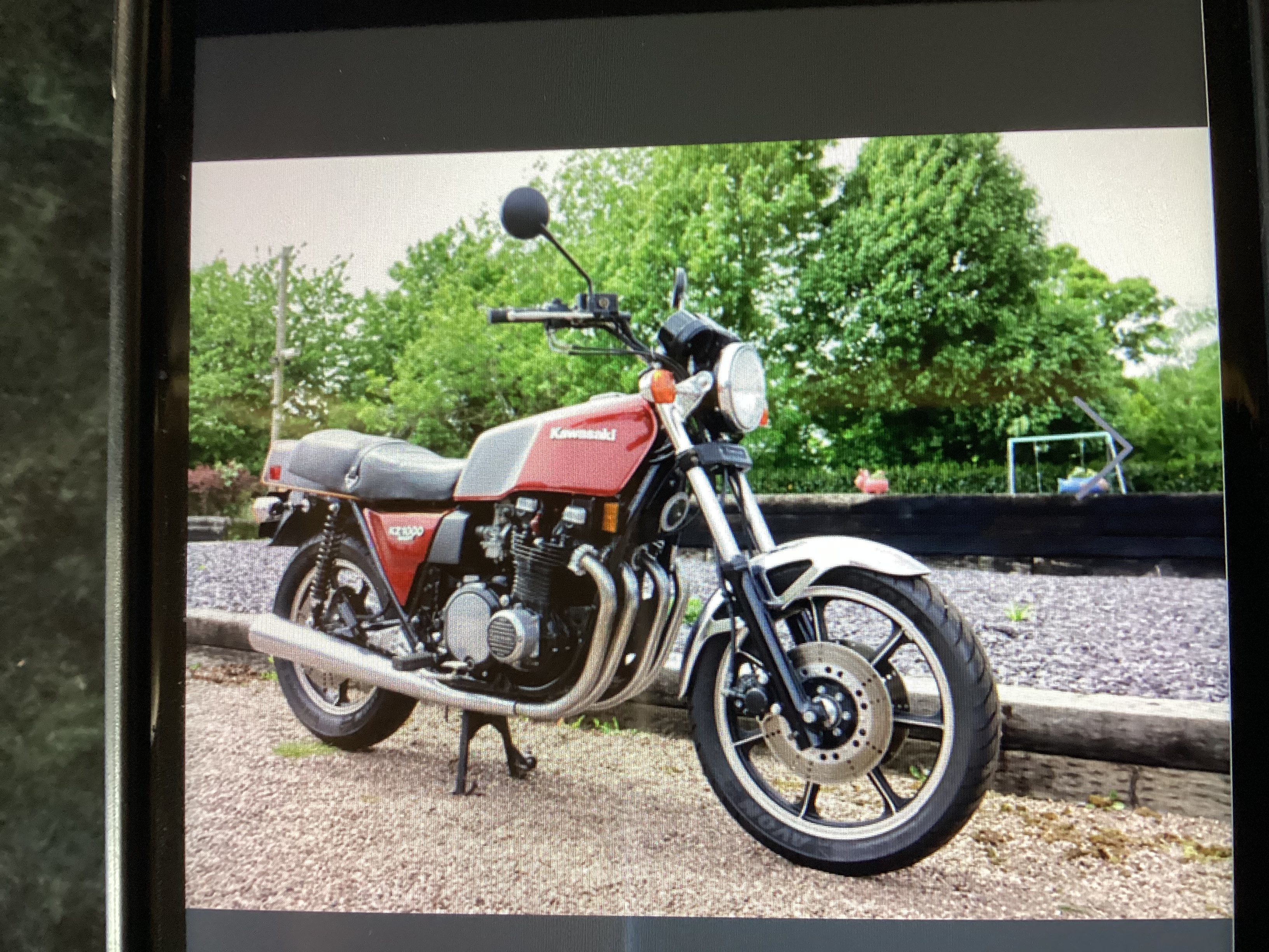

#6 PostAuthor: warren3200gt » Wed Jan 18, 2023 10:30 am
Period ST advert. Looks like 7 bolt disc.

#9 PostAuthor: DeadZedDave » Wed Jan 18, 2023 1:09 pm
Like Warren3200gt says the picture he has posted shows what a J wheel looks like - so if its a J wheel you need, this is what you are looking for !
Should be easy enough to find one.
The J has a disc (or pair of discs) which bolt directly to the wheel hub using seven (7) special hexagon socket head bolts. The disk bolts directly to the wheel hub - i.e. there is no separate carrier.
The wheel you have in your picture has two discs which are permanently riveted to separate aluminium disc carriers and these are then fixed to the wheel with seven (7) hexagon head bolts.
The only other standard wheel I know of which looks similar to yours is a Z1300 one. It has a similar arrangement of 7 bolts / separate disc carriers and riveted on discs BUT THE Z1300 is an 18 inch wheel - yours is a 19 inch.
It looks like you have a Z1000ST front wheel BUT whatever else it might possibly be IT IS NOT a standard 1000J front wheel.

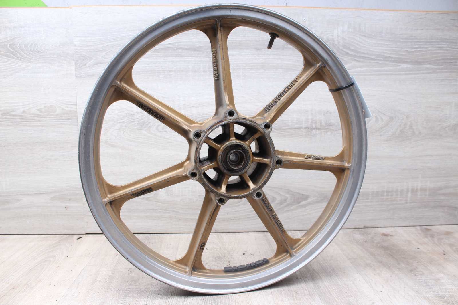

#11 PostAuthor: ADRIAN H » Wed Jan 18, 2023 3:49 pm
Kawasaki Z1000 ST Front Wheel

#13 PostAuthor: ADRIAN H » Wed Jan 18, 2023 3:51 pm
Your wheel looks like a Z1000ST - Z1000 J looks heavy duty - bolts further out from axle with nodules around bolt holes

#14 PostAuthor: rpeters » Mon Jan 23, 2023 7:31 am
Thanks for the info chaps.....I am not looking for a J wheel, I want to get ride of these two which is why I need to know exactly what they are.
I guess as its now confirmed that they are ST and maybe J rear then they will be going in the skip......
