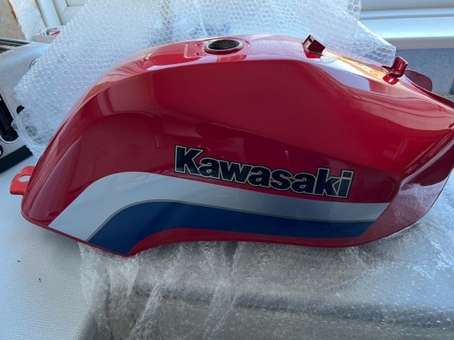

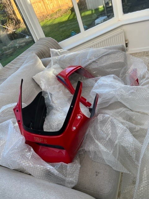

Re: Kawasaki Z900 A4 paint (Help please)
I find sean is brilliant and have had 4 sets with him so far gpz11 below
and a gpz900 he did a while back and that was was very rough with a lot of plastice welding same fo rthe gpz11 fairing above
A Mr Dewis transformation, req lots of repairs what a painter
