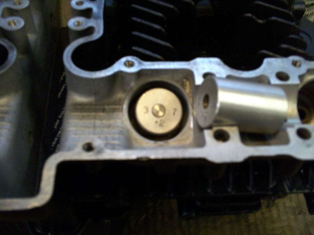

It is very difficult to get an accurate reading with a steel rule or verniers because of the valve guide preventing getting close alongside the valve stem so you really need a height gauge like mine in the pic .
