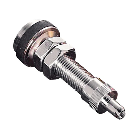

They’re an odd valve size though it’s probably simpler to just go with tubes :shock:
Re: Tyres and tubes…
Posted: Tue Mar 07, 2023 7:12 pm
Author: warren3200gt
They are specific to bikes. Car valves won't fit. They are available in different sizes, this is on Ralph's bikers toolbox.
Posted: Wed Mar 08, 2023 12:26 am
Author: chrisNI
warren3200gt wrote:They are specific to bikes. Car valves won't fit. They are available in different sizes, this is on Ralph's bikers toolbox.
No doubt. My local bike shop didn’t have the right size in stock so I just went for tubes on a set I got done last week.
