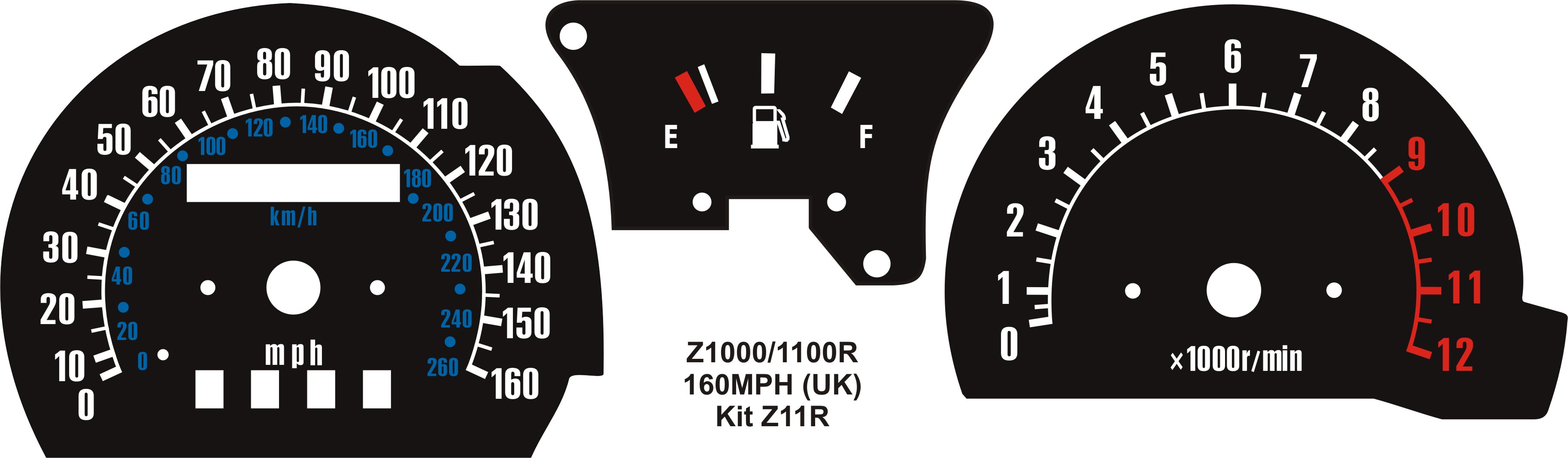

I have a Z1000 R2 and the tacho dosent work seams to be an issue with these. Dose anyone know if these can be fixed or know if a tacho from another model can be fitted
Posts: 2926
Re: Z 1000 tacho
#2 PostAuthor: Al » Wed Mar 15, 2023 6:14 pm
Is it the two round (approx 3 inch diameter) clocks side by side?

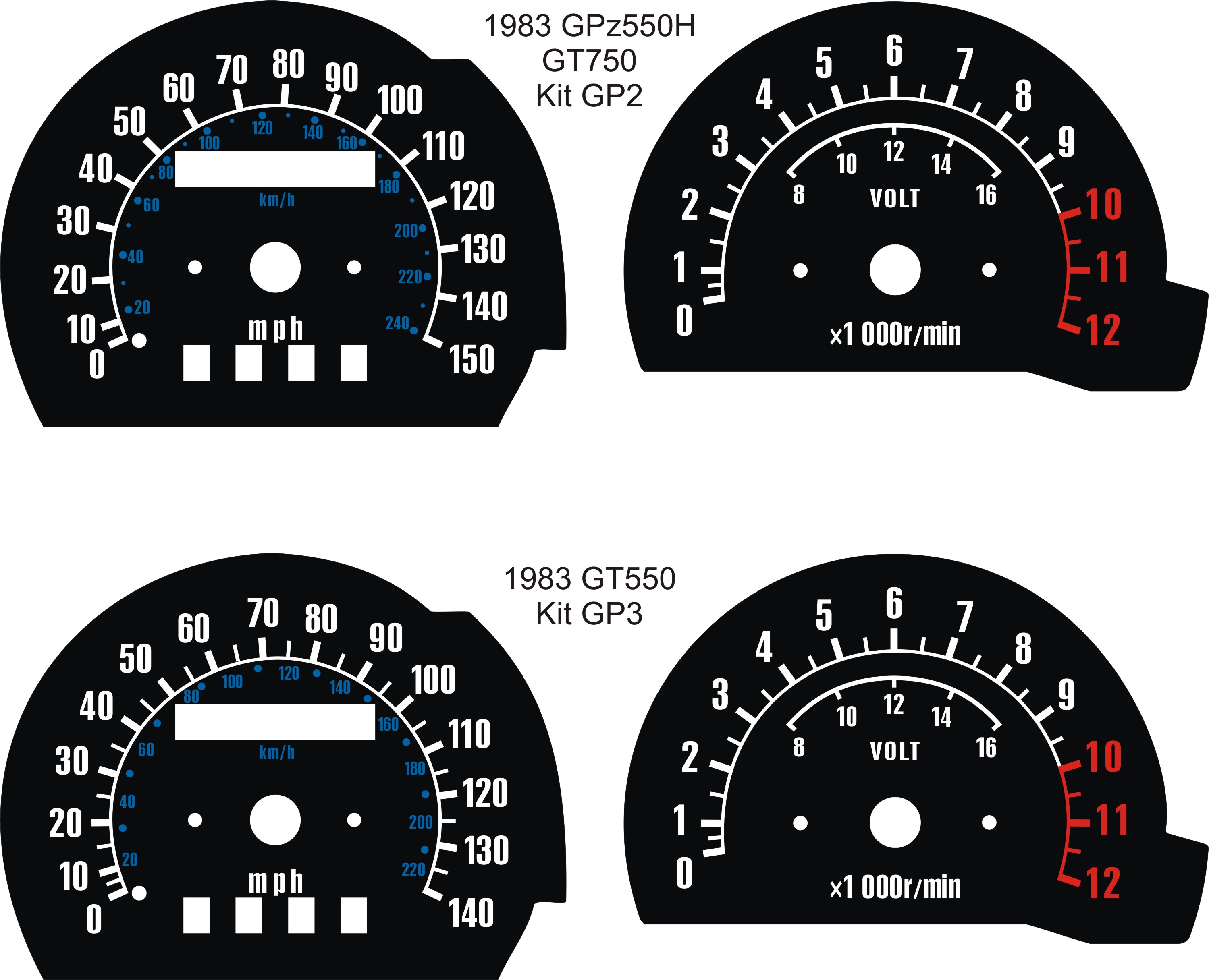

I take it these are the style of gauges from your R2?
Basically the GT55p, GPz550 and GT750 all have the same range from 0 - 12k regardless of redline so the workings might drop straight in. The gauge plate mounting dimensions are also identical.
The only difference is that yours doesn't have a voltmeter function whereas the GT/GPz does. Can't be sure whether this would effect the function of the tacho signal or not but I'd guess it'll be okay.

Yea that’s them I brought a GT 550 set of clocks n fitted it but still no tacho so looking into it a bit more of corse they could have both been broken but will see
