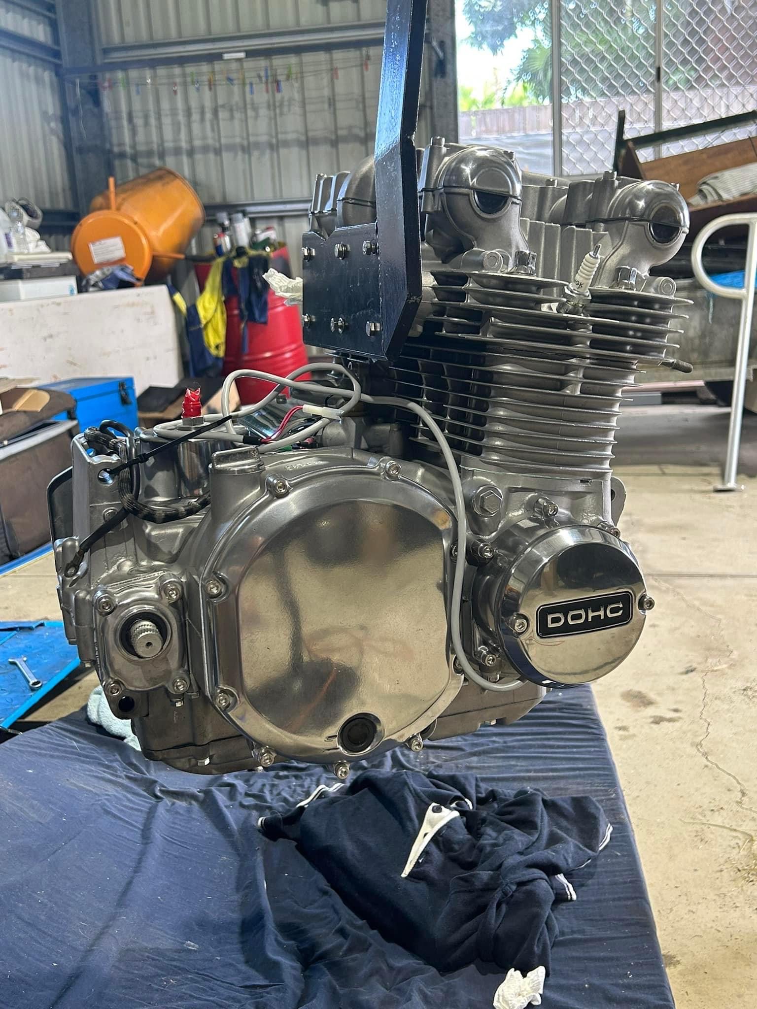

I saw one which was alike a horizontal U shaped and bolted to the carb mounting flanges. Pretty simple to measure up and make I would have thought!

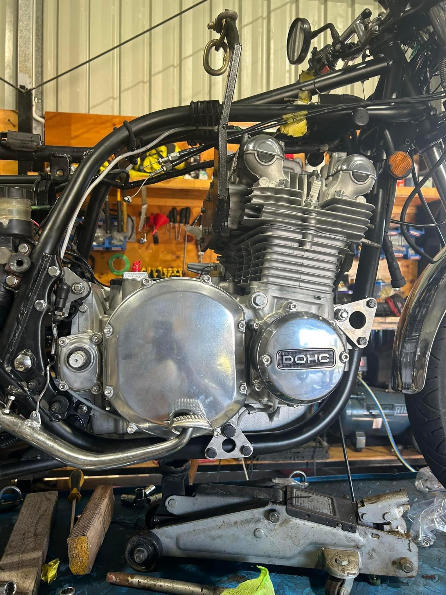

#4 PostAuthor: shaggy » Tue May 02, 2023 1:52 pm
This is a photo of it
[attachment=1]IMG_0422.jpeg[/attachment][attachment=0]IMG_0421.jpeg[/attachment]

Whilst i can see the advantages of the bracket if youre doing engine work on several bikes and have a hoist handy. I found it easier to tilt engine onto a big blanket and lower frame onto engine then insert the engine bolts and tip it back onto floor of course the frame has to be stripped, not so easy if just taking engine out on its own.
Hope you get one sorted.
